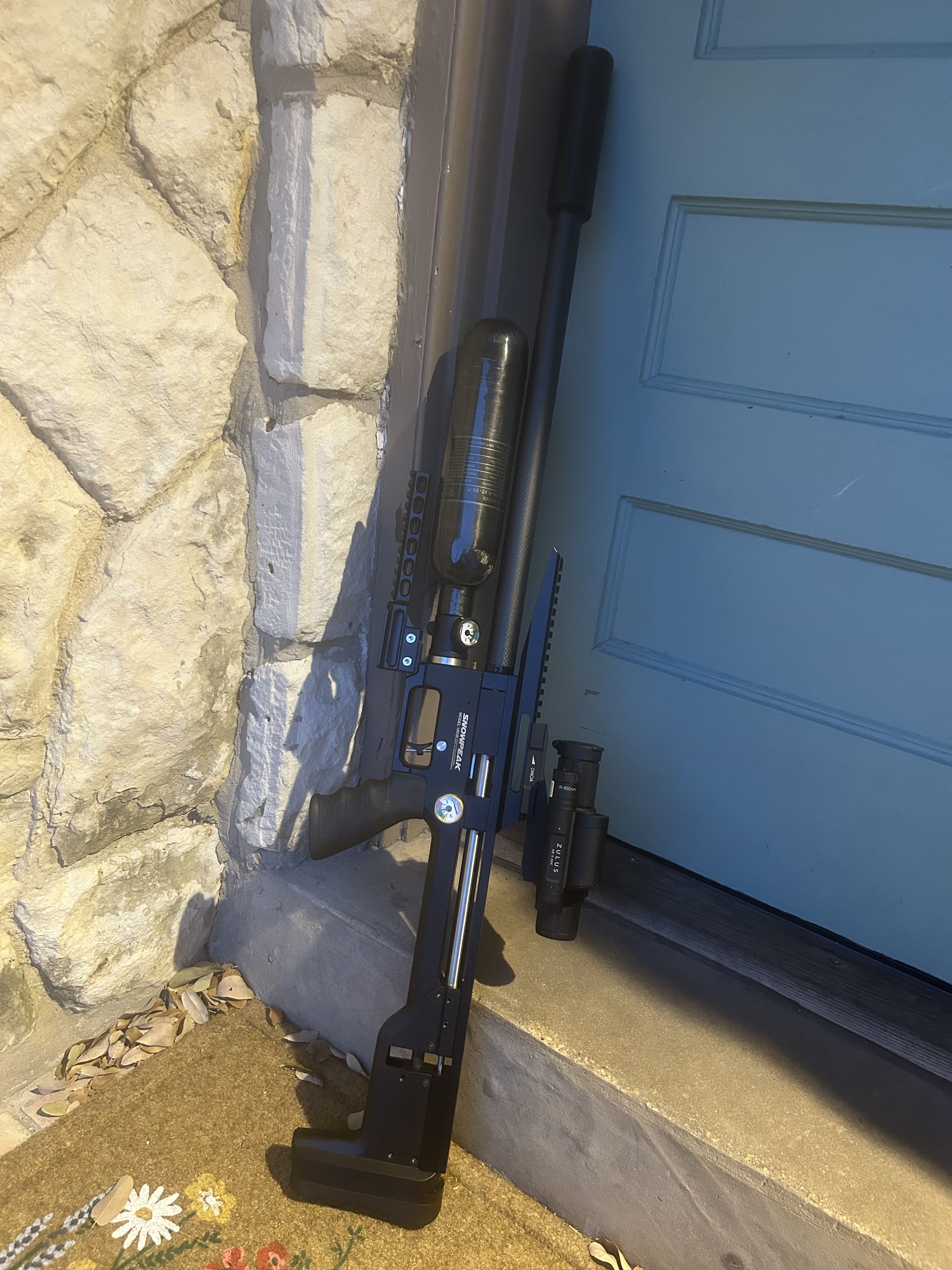

Wait, it's that long with the mod?? Damn that's a shorty!450mm
Total lengh with the Hugget minimagna is 30.5 in. It’s short … I think it’s my shortest
That’s the whole point of the exercise! I figured this would be the best example ( 450mm barrel ).Wait, it's that long with the mod?? Damn that's a shorty!
That's awesome! I love compact builds! I prefer higher power, but if it's compact enough I'm okay with lower to normal power. He sure does great work!That’s the whole point of the exercise! I figured this would be the best example ( 450mm barrel ).
Butt to bottle length end is 27.5 in
A tatsu would put it at 29.5
But the mini Magna works great.
Glad you like it. Dave really came through here. It’s smooth as silk.
i figured many took the notos and modded it to 30 32 fpe longer barrel and more shot capacity * bottles and z blocksThat's awesome! I love compact builds! I prefer higher power, but if it's compact enough I'm okay with lower to normal power. He sure does great work!
I made my notos have a crazy shot count. Power was enough to take down iguanas and it was accurate enough shooting dimed sized groups at 50yds with crosmans. I hated the trigger so I got rid of it.i figured many took the notos and modded it to 30 32 fpe longer barrel and more shot capacity * bottles and z blocks
it made more sense to me to take the zelos and have a compact made for less than a full mod and barrel notos.
