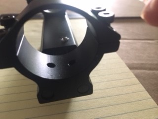

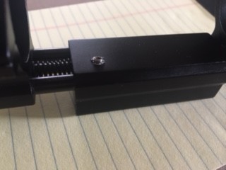

Diana Z scope mount fix . saw the Hector M. fix for a Z mount wobble , drill & tap for 4 MM set screws .
But the top metal is thin so my fix is to drill on a 45 degree slant from the mid point on the top to the rod / slide . so instead of a vertical 90 degree hole you drill at a 45 for more metal to thread . Works great .

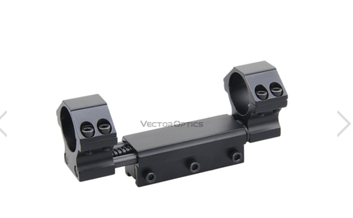

You could give this a try - not expensive.
I use and really like their adjustable rings.
Dovetail & Picatinny, 1” and 30mm options:
-Ed

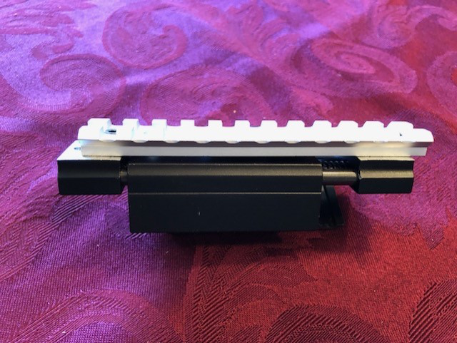

Here's my version of How to butcher/improve a Chinese Made zero recoil mount and make it into a zero recoil riser. See Post #27 in link below.
page-2
I basically cut off the top of the mount and made it into a zero recoil riser with Picatinny rail.
One of the reasons I did this was to have the option of putting an adjustable mount onto a zero recoil riser.
I wished Sportmatch would come out with an adjustable riser...it would make our lives so much easier.
or maybe combine it...a dampa mount adjustable riser...or an adjustable anti-recoil riser.

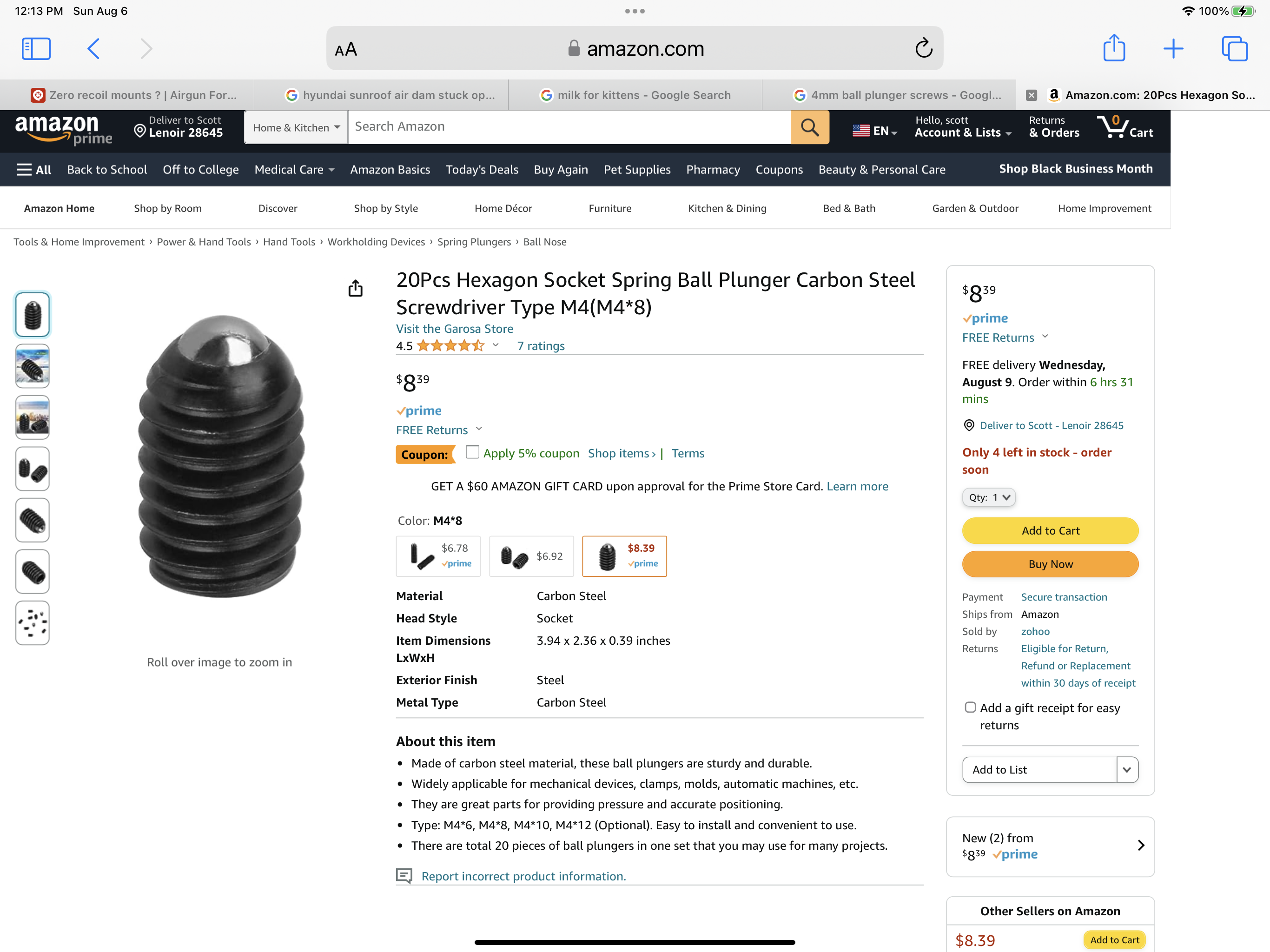

when adj. the screw squeeze the mount , if you can feel the screw it is too tight if you can't feel it and there is no wiggle then it is right .

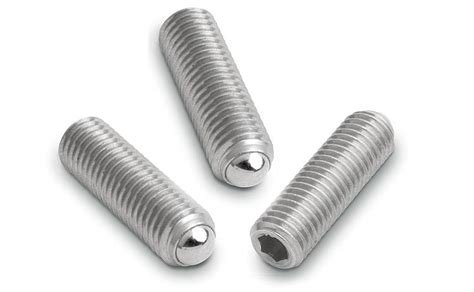

Yes i found 4MM set screws with nylon tips but not all nylon 4 MM set screws
I wonder if ball screws would work there, if the spring and ball offer enough push to keep the rods uniformly centered.
