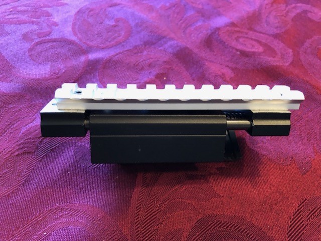

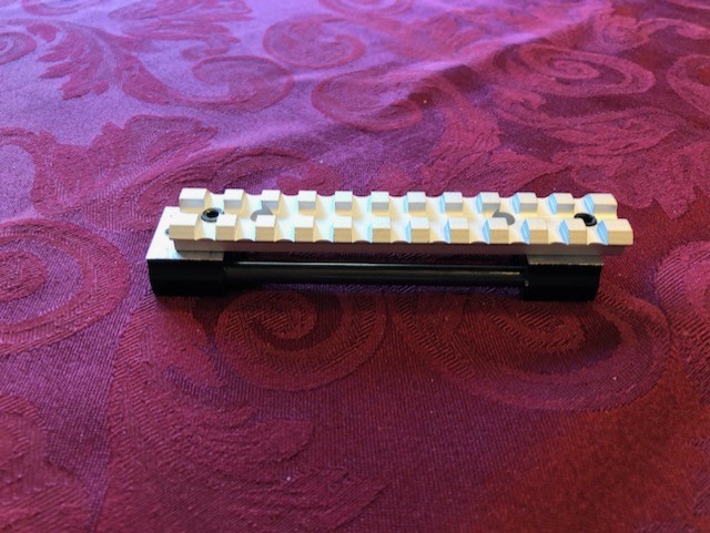

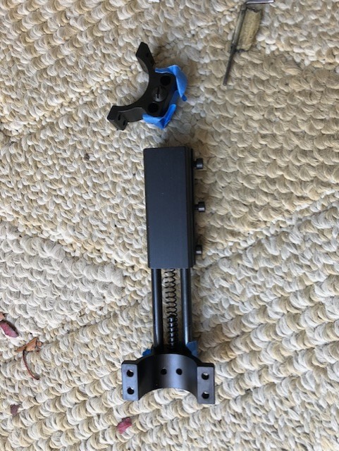

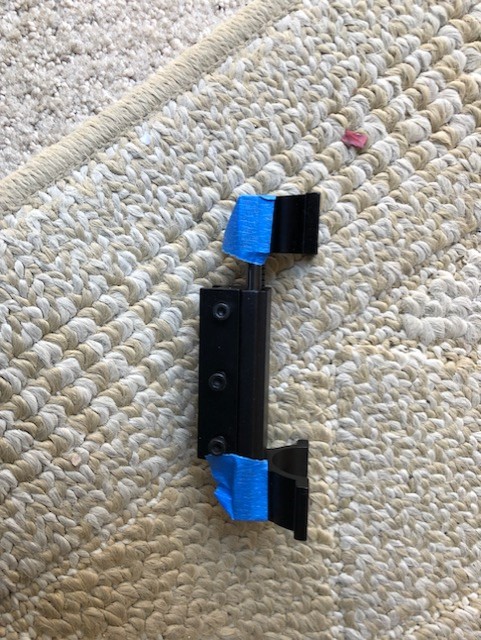

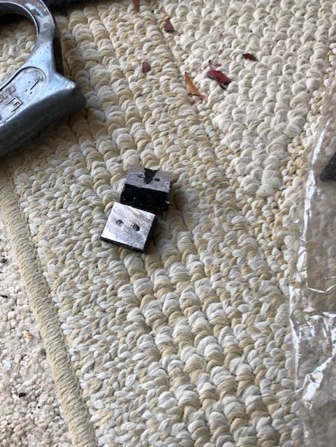

Had too much time on my hand this weekend. Measure twice and cut and/or drill once was the theme of the day.
Unfortunately, I flunk wood shop and metal shop. So most of the day was spent cussing and fixing mistakes. Wasn't much fun digging out a drill bit that snapped due to operator error. After about 6 hours...here's the result (all ten toes and fingers still intact and no blood spilled). Got out the TX. mounted the recoilless riser and a Sightron 10-50x on it...seems to be holding zero. Next phase will be the drill and tap for nylon bolts to tighten up the slop on those two metal rods.

Looks like it should work well. Good job.
Drilled and tapped for brass set screws (too lazy to go to home depot to hunt for nylon bolts). No much material on the sides for the set screws...maybe 1-2 threads to hold it. Gosh ...more problems.
Looking back, a better solution might have been to angle one screw at a 45 degree angle upwards. Oh well...next project (next mount).
Maybe next time. will need a drill press and some way to secure the mount at 45 degree. hmmm. This might be a better option as you do not need o remove the Picatinny rail to make set screws adjustments.
just a side note for others who want to do this mod. the Picatinny rail does put tension on the sliding mechanism if you are off even by a fraction...there might be some binding.
