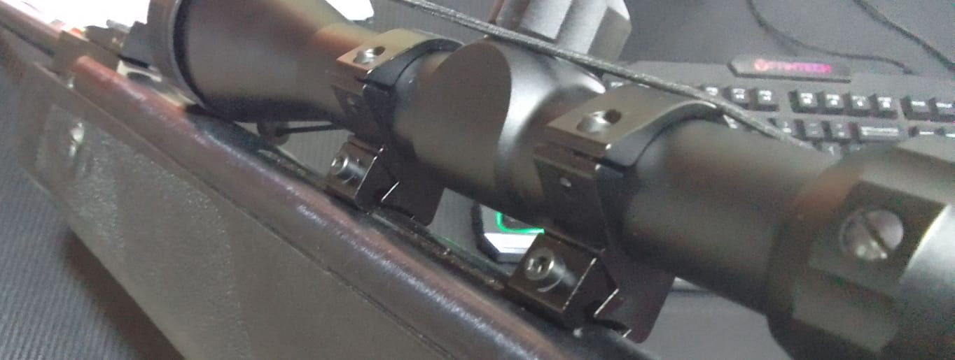

I got myself a 800fps air gun and a optic(Beeman 3-9X40).But no matter how much I try, the pellet wont hit the target.I tried to zero the scope but no matter how much I turn the dial on the bottom right (The dial which which is used to change the direction from left to right) the pellet wont hit the target.
I would alawys hit the pellet about 4 inches left from the target.,I tried turning the dial right(about 20-30 clicks,when 2 or 3 clicks didnot work) but still the pellet will the same spot,eventhough I turned the dial to the right.
Why wont the pellet hit to the target no matter how much I turn the dial to the right.The horizontal height is correct so I dont need to change the dial on the top of the scope.
Am I doing something wrong?

The gun shoots fine without the scope,the porblem is with the scope
I bought the gun separate and the scope separate.Mind you the scope fell twice to the floor when it was on top of the old gun.They zeroed the scope when they fixed it on the new air gun becuase the old guns scope rail was not good,but when I returned home,It was shooting as if it had not been zeroed
Well if that's the case I'd definitely say the scope is the issue.
In the picture, your back scope ring clamp doesn't look seated correctly on the dovetail rail! The jaw on the right side (stationary part of ring) is not grabbing the underside of the rail deeply enough. Look at difference between how back ring sits on rail & front ring sits. When mounting rings, get that stationary (right) side UNDER the lip of dovetail rail before tightening left (screw) side.
NOTE: The underside of dovetail on left side looks pretty gunky & dirty. Could debris be on right side too, not allowing ring to seat properly?
