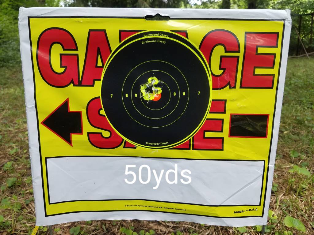

So after tuning Black Betty(30 cal Maverick Compact), shooting the JSB 44.75 @ 880fps, I zeroed her at 50yds. Set my hard stop to zero at 50. Now when I shoot @ 10, 20, 30, 40, 50, 60 I have negative moa between about 25 to 45 yds which I have to hold under for as the pellet goes above the line of sight of the scope. Graphing this out shows a steep rise from the muzzle till it peaks at 30yds. Any thoughts on the way I have her zeroed?

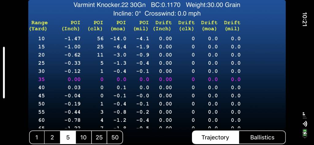

yeah .. if you want the longest 'point blank' (where what you put the crosshairs on gets killed) killzone it has to be zeroed at the perfect place .. you input your parameters into a ballistics software like chairgun and figure it out according to what your acceptable deviation (up and down generally) is ... your zero point is usually alot closer than you would think at typical airgun velocities .. usually between 15 and 22 or so yards but it needs to be exact to work the best ... and that typically gives an average 'point blank' with most airguns of about 12-46 yards i would say, outside of that you compensate, and you can see in the software what it will be at say 60, hold over 3" and so on ..
I shoot at 5 yard intervals. If POI is high,then I click down to make it the new zero distance, repeat out to my maximum range, until no more high POI. Then go back and note the holdover for each distance. Since I rarely shoot beyond 45-50 yards, 5 yard increments work for me. If you shoot longer range, a couple of yards can make a difference in a small target, so I guess you would want to take test shots at smaller intervals.
