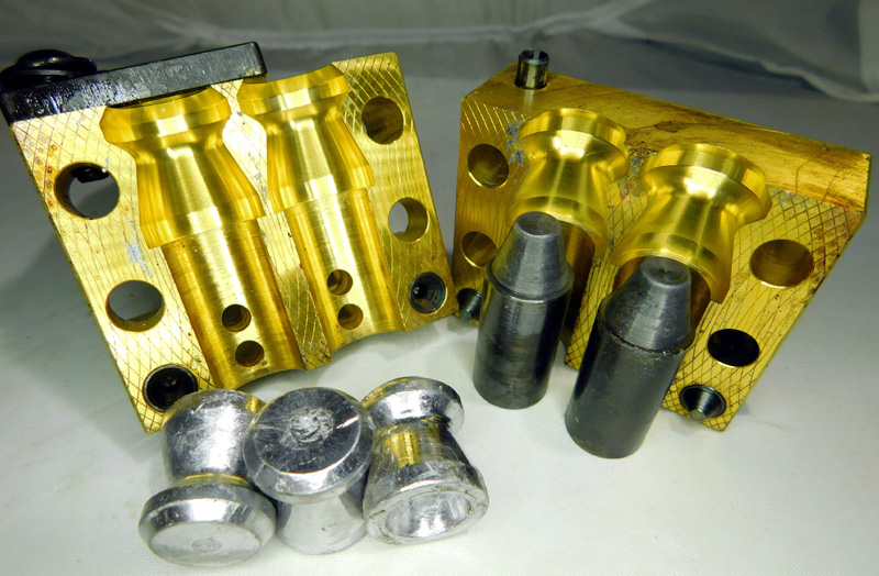

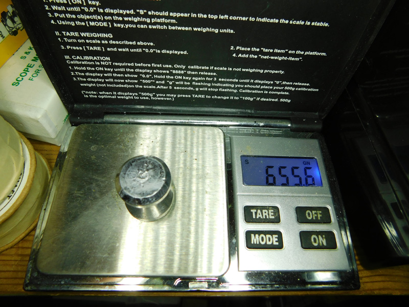

I cast for a slug rifle so have the MP mould for full size "pellets", they run @ .732"
As cast at 655 grains and should be fairly good weight wise for power.

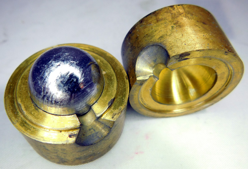

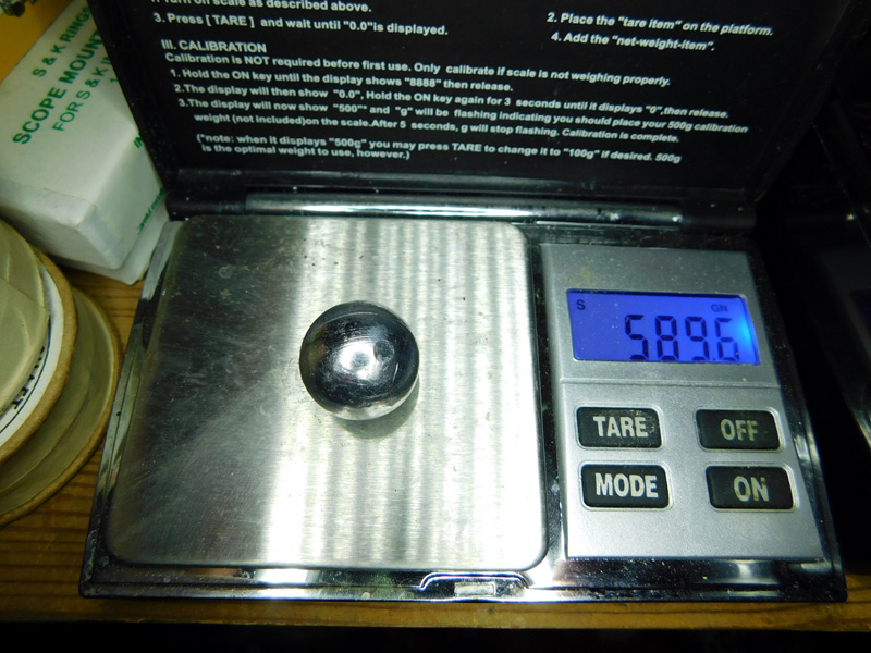

Round balls running @ 739" ish.
Clocking in at roughly 590grains
