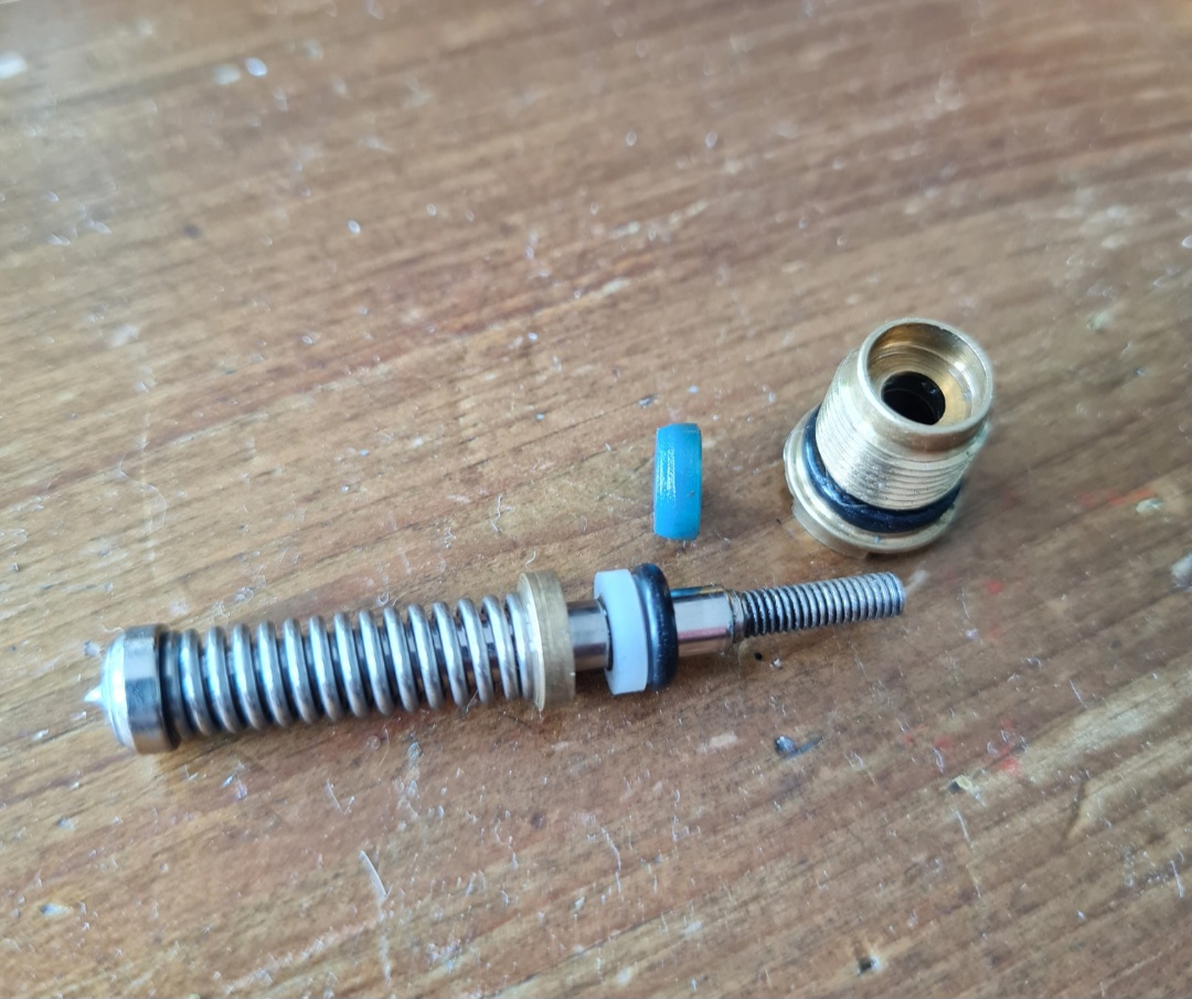

Here is how it looks out of the pistol fella-
You won't have the delrin washer/ oring (I swapped out the leaking u cup seal).
To remove the valve you need to remove the pump/ valve from the chassis and knock through the pins that hold the hammer to the valve body. You can then just unscrew the brass bit (hammer end) and viola.
Before you do though it might be worth lubing the rear of the valve stem where the hammer strikes incase the stem is just getting hung up on the ucup stem seal (it happens!).
Good luck with it 👍

Jamie, thank you!
I’ll give it a go.
