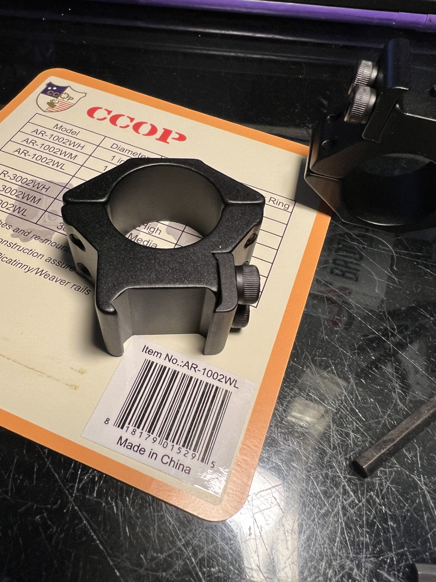

one note to owner about rings
we all know they have one slot on the pump handle and the slot will take a reflex sight because the sight needs only one slot but scopes need two and people cut the pump handle and i believe that weakens it
now this ring are weaver and have no cross strap or screw and can be found on Ebay
so just some info
https://www.ebay.com/itm/201841205152

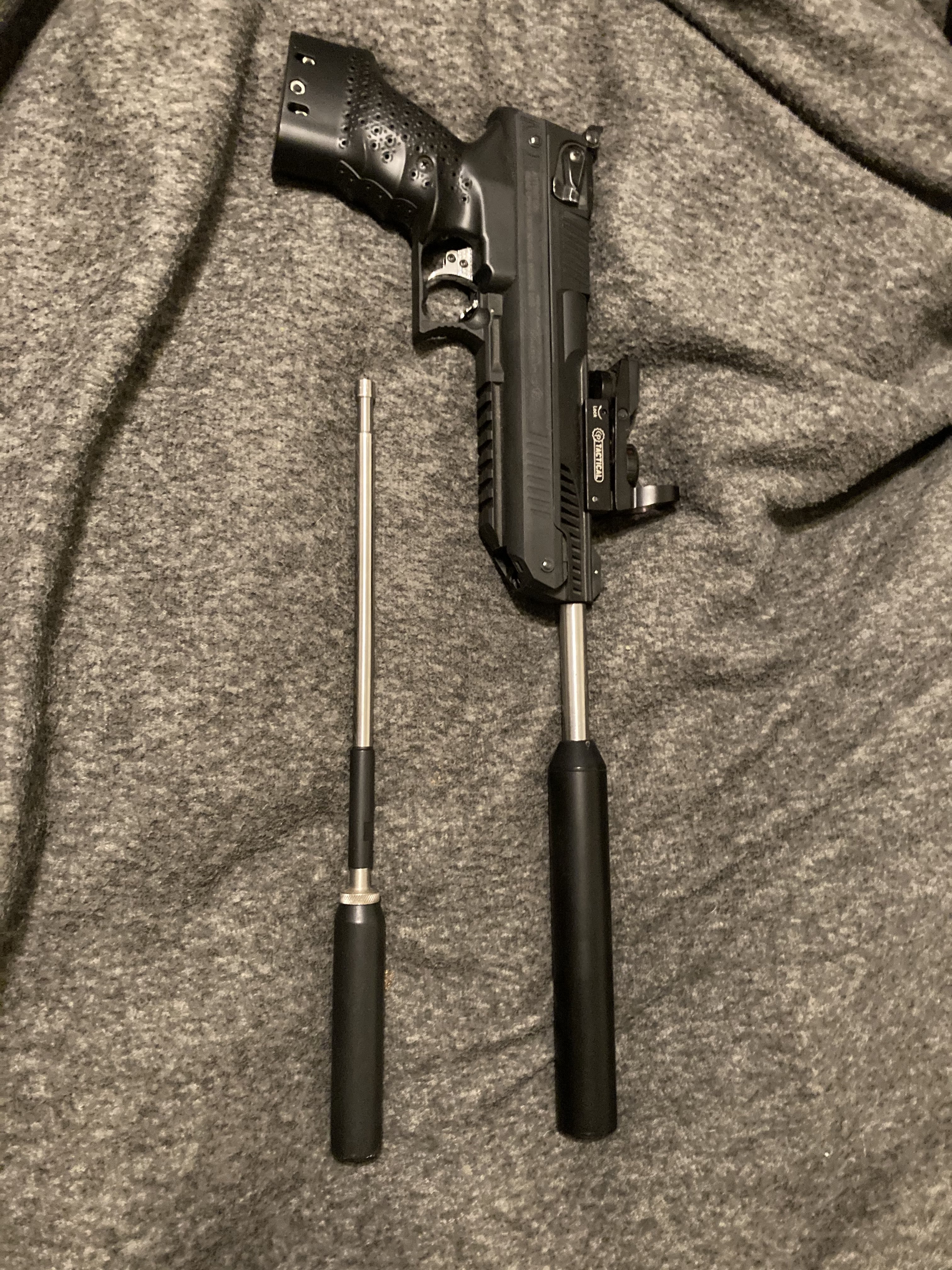

The .177 is my favorite by far, and with the moderator it’s just a little pop on four pumps.

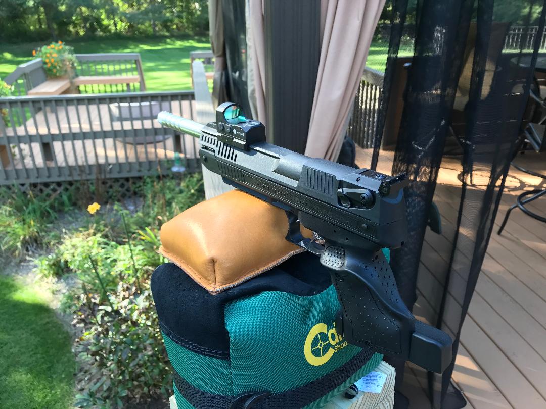

Mine shot high, had the rear sight all the way down and still high at 10 yds, two pump. Put a mini reflex sight on it, problem solved. Great air pistol.
