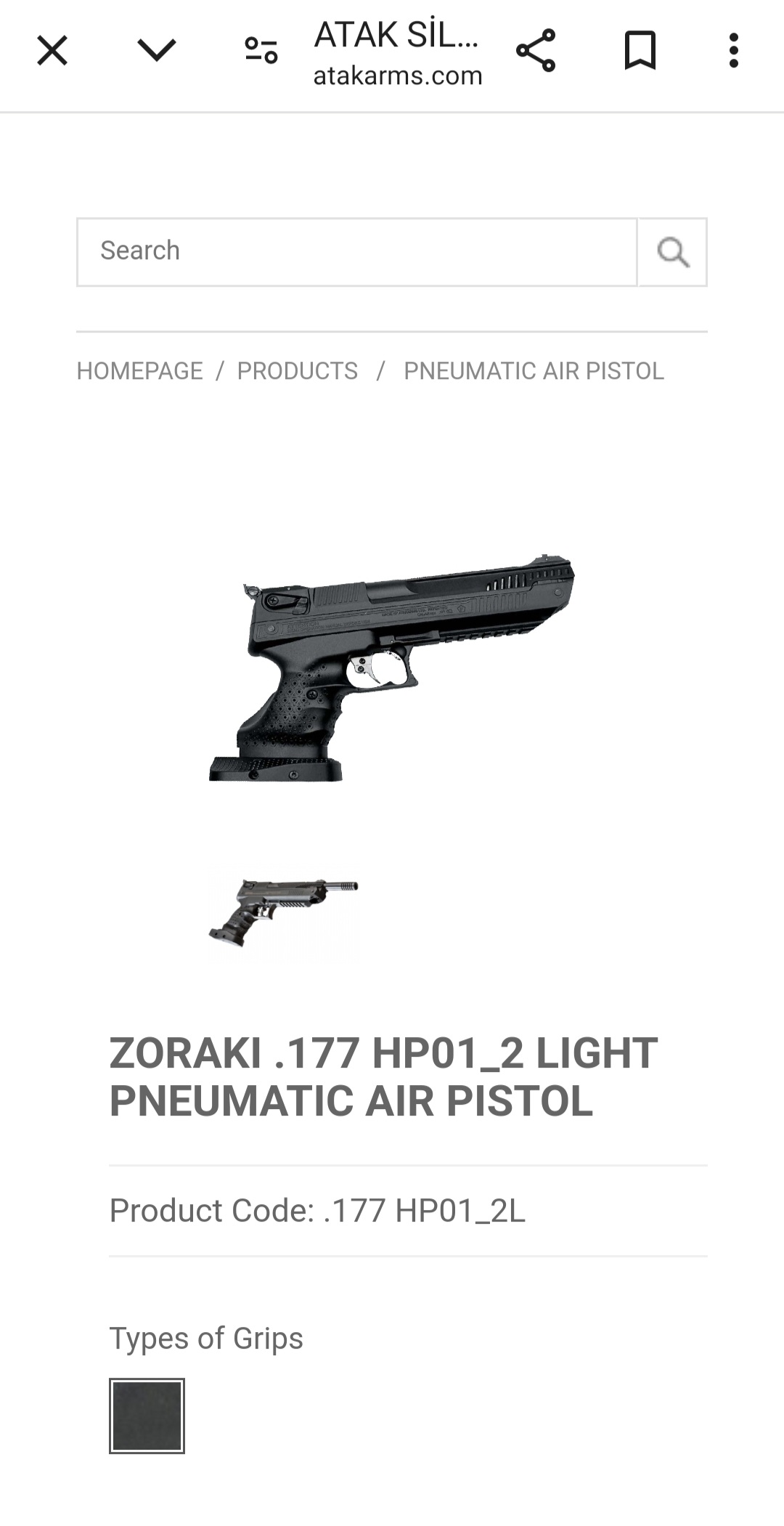

Good afternoon! I have two questions about the Zoraki/webley pistol. For those who have the light version and also the ultra, what is the real difference between the two besides the longer barrel? as the Light can also go up to 4 pumps just by turning the valve. Because, superficially, they appear to be the same pistol.

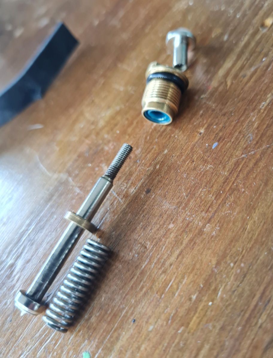

Haven't owned the ultra, but own a mk1 light version and have rebuilt/ used it in standard form and also with a 300mm HW barrel (in 4.5mm).
I believe they beefed up/ and or improved the casting on the valve block on later models as there were reports of them cracking on the mk1's.
In terms of the 3 pump/ 4 pump differences.....this is just a theory, but if they changed anything I'd suspect it was increasing the plenum volume by reducing the valve spring dimensions. In my mk1 light the spring almost entirely fills the plenum-
They didn't change the swept volume in the pump, and as my mk1 with longer barrels tops out close to 8.5fpe for 3 pumps (remember it's a 4.5mm too) it suggests the increase in the ultra over the light comes from the barrel length, rather than the extra pump.
Whilst doable, you'd have to be very 'mechanically unsympathetic' to try and put 4 pumps into the light version, and the only way I can see that you could achieve it sensibly, would be to reduce the pump volume, or increase the plenum volume ....
As above though.....just a theory 👍

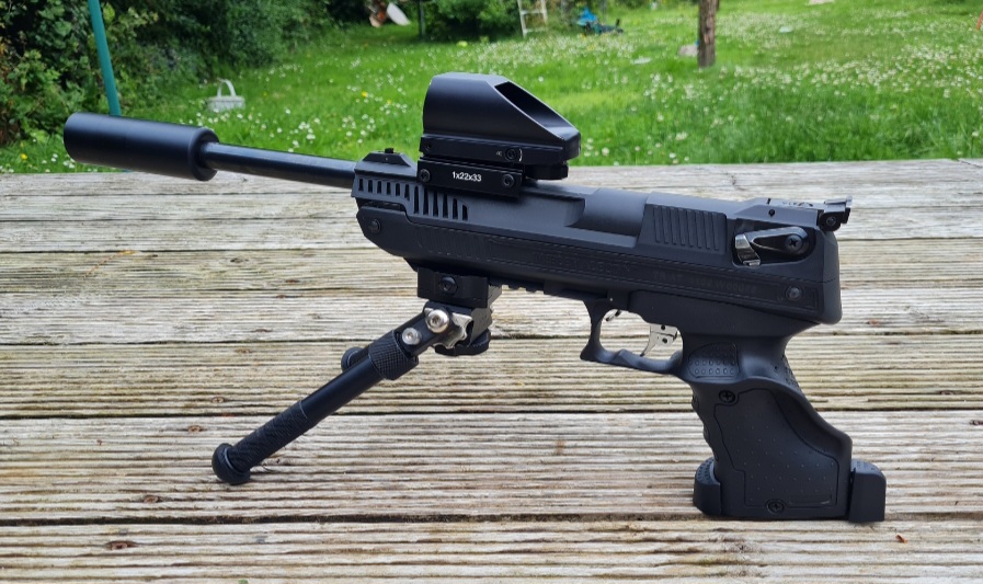

The only thing that I've done to mine is remove the "palm shelf", so I room for my hand !! I added a red dot sight. Not a bad shooting gun.
It's not much more than a toy, so I haven't paid any mind to the FPS, the shot to shot fps spread. Got the sight adjusted, and put some pellets through it.

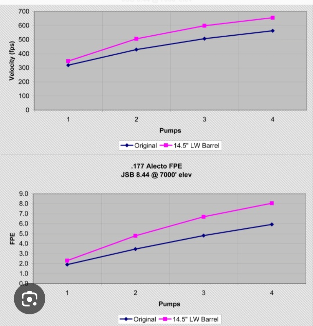

I believe there must be some difference in volume between the standard and ultra Mike, based on the data below posted by a fella on the GTA detailing the output differences going to a 14.5" LW barrel-
His max outut results mirror mine after I turned up a longer barrel, except for the fact his takes 4 pumps to make 8+ fpe and mine only requires 3. The only way I can see this being possible (keeping manufacturering changes sensible) is if zoraki shortened the second stage pump rod (increasing head space at final stage) or increased plenum volume to reduce final pressure.
If this isnt the case, I'd love for someone to explain how adding the volume/ pressure of the 4th pump (regardless of effort) doesn't increase output.....
EDIT.....his results were at 7000' which is some pretty thin air. This might go some way to explaining it as my results are closer to sea level 🤔

I have a Zoraki HP01-02 with the improved trigger in .22 and just ordered a regular .177 (yes, they call it light). I'm trying to find someone who machine a HW barrel to give the .22 a bit more velocity but it's true that a short distance one pump is enough. I screwed the restrictor once all the way to get that extra power but one day the gun didn't shoot, i closed it all the way but the trigger wasn't releasing the shot. Tried opening, closing... nothing. And not a good idea, after a couple of times the gun "blew up" meaning the pump cracked in my hands. Now i think they seal the part and it's harder to modify but never tried again.

Yes, I understand increasing barrel length will increase fps Mike (providing any give action is producing enough energy, which is generally a given with total loss valves) that's why I turned up the longer barrel for mine....so I could make the UK limit on 2 pumps instead of 3. As it happens I had to back off the pressure relief valve so it activated around 3/4 in to the 2nd pump to keep things legal.
I think it may be more pertinent to compare Gary's 1 pump results against my own (rather than max output). My Alecto hits 3.2fpe with RS and 3.5fpe with 8.4's, with my barrel being 2.5" shorter than his. That's an additional 30% odd for 1 pump. Before adjusting the pressure relief valve, mine hit 6.4fpe for 2 pumps.
Atmospheric pressure is only around 1psi different from his location to mine (according to google), so either the pellets are shedding 30% of their velocity in his extra 2.5" of barrel, or my action has to be producing additional pressure per pump.
