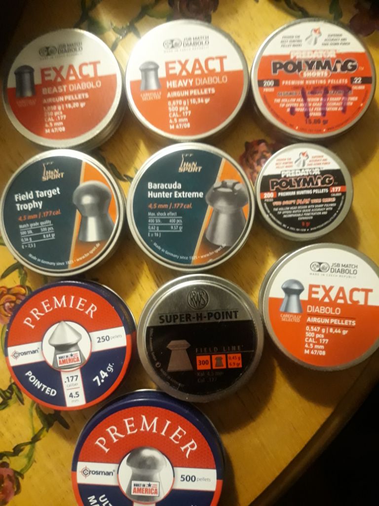

I would try the 7.4gr Crosman pointed pellets (not their crappy oversized 7.9gr Super Points though). The 7.9 CPHPs work fine in several of my pistols too.

Cool to see what other pellets do. Your close by and I'll send you a sample pack of .177, if you want. Maybe you have lots of choices already?
