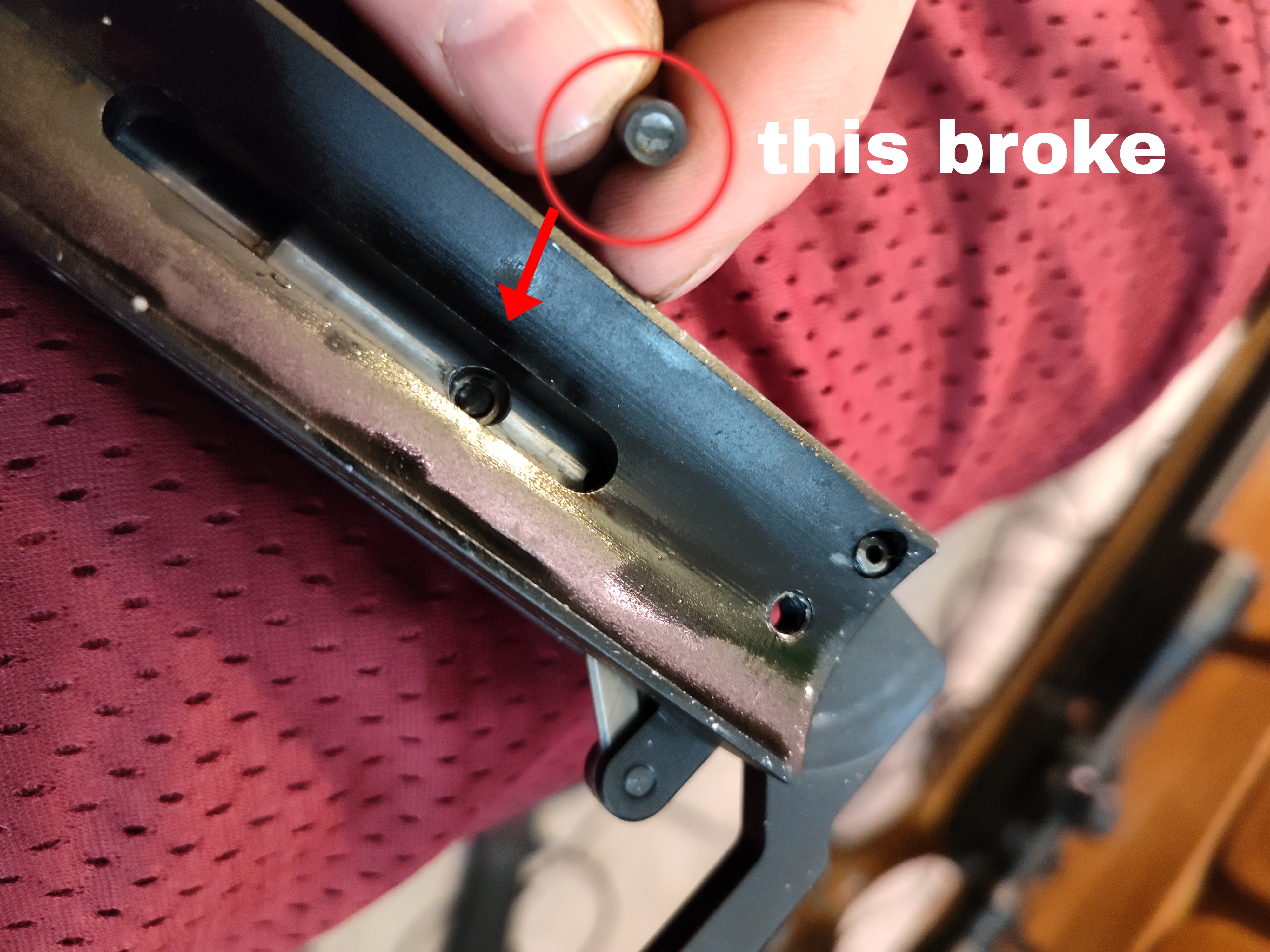

So I purchased a heavy hammer spring for my airicuda and I'd say it was a little to heavy. Backed all the way out it did shoot faster for the first 5 shots but then I went to cock it back and SNAP POW something sounded broken bolt went limp. Took it apart and seen that the little piece that pulls the hammer back ofcourse to my luck had snapped. I'm working with the guy who sold me the spring he says he can make a stainless piece that threads in but I don't see any threads. Anyone have any idea how I could fix this? Jb weld maybe?

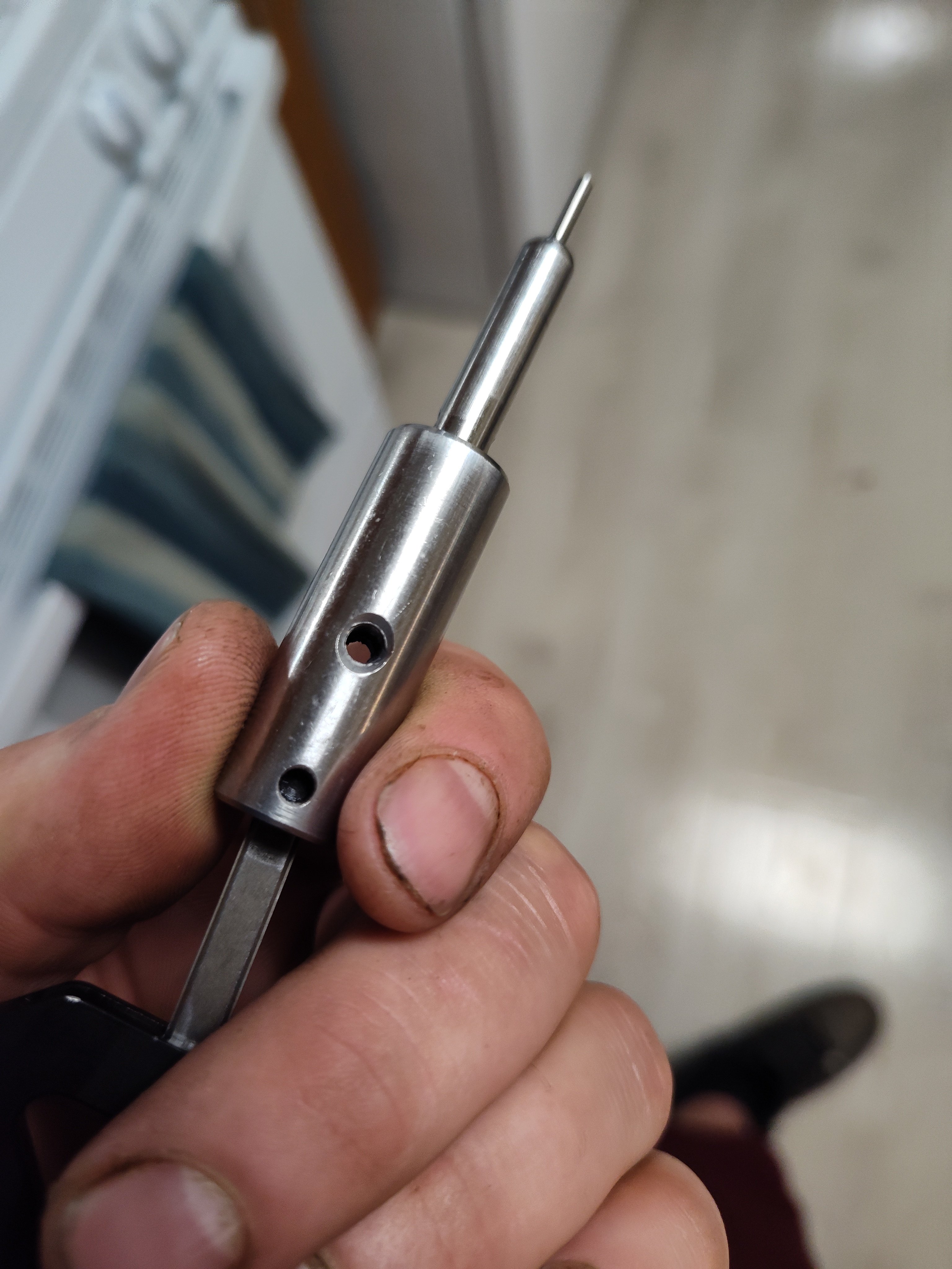

I've removed the broken screw from the threads with an easy out bit #1
Alien Airguns on eBay is going to send a reinforced replacement pin bolt catch thingy. Shout out to that guy.🤘
