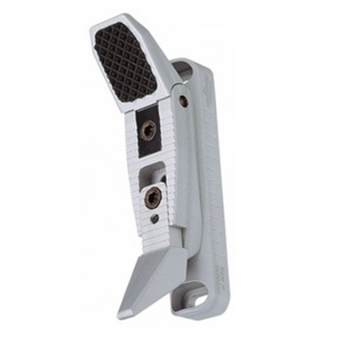

You will need to buy an MDT shoulder piece as well.

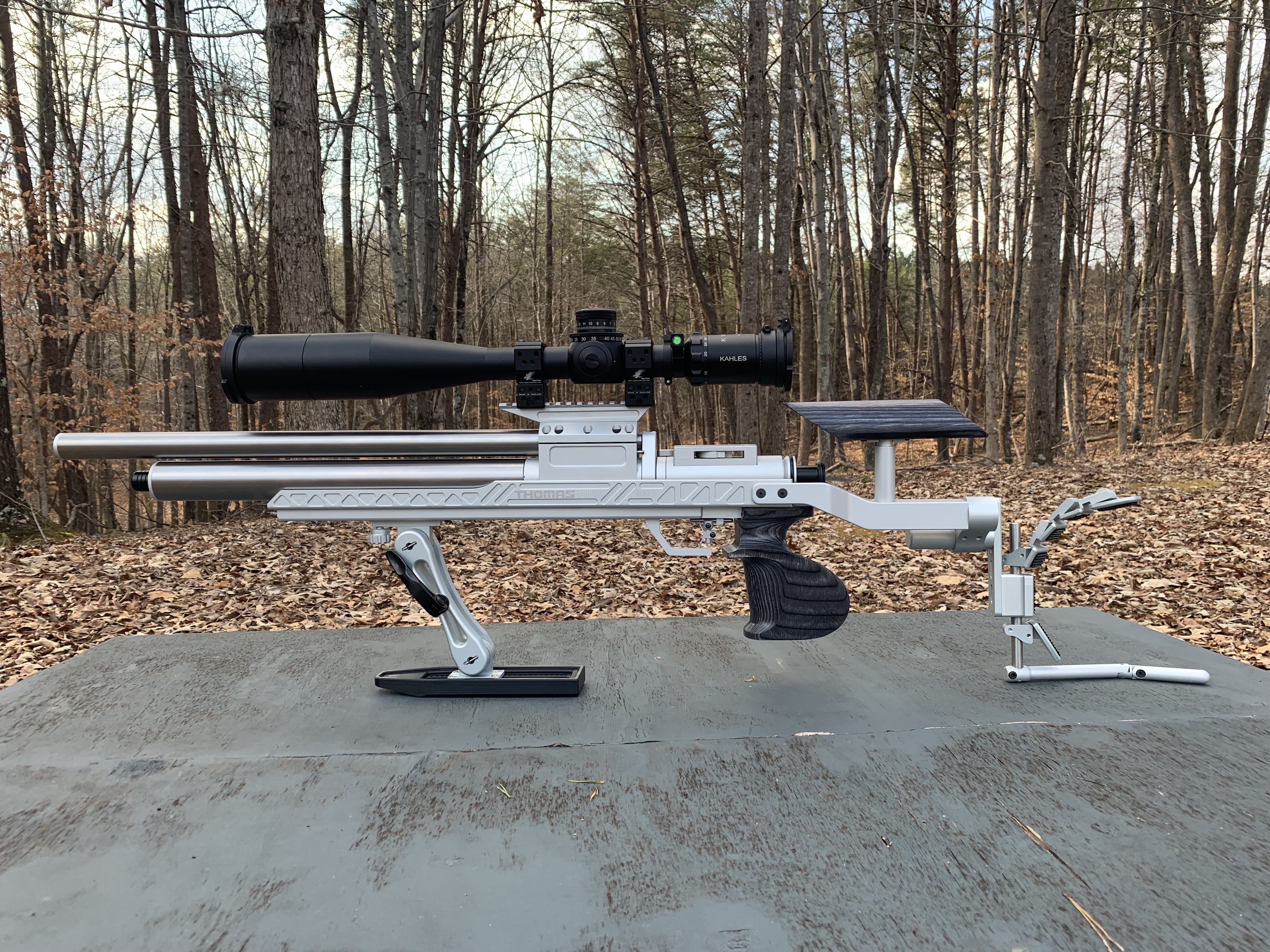

This model is the full length shrouded version. 100 plus shots at 3300 psi fill.

There is a new butt pad rule for 2025 AAFTA FT, I think the total 'cup' can't be more than 3/4" or 1". A bipod stop is probably all the hamster 'depth' you'll need, I swing my hamster/knee rest out of the way for offhand shots on my Thomas (I hold the chassis right in front of the trigger guard).

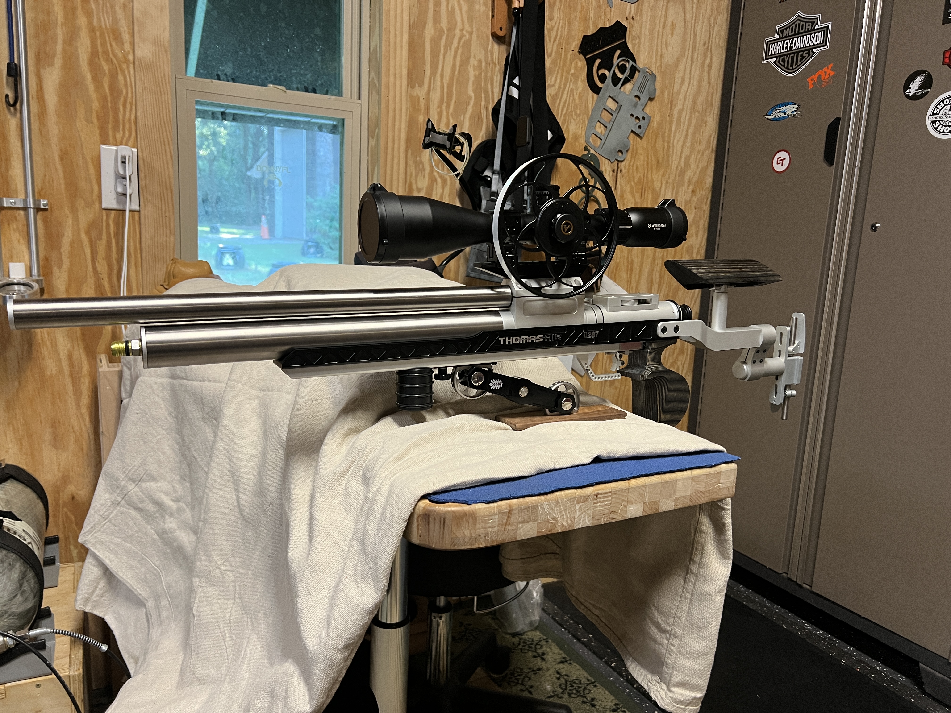

A bit of clarification is probably needed here...
The Thomas i'm running the light hammer, long hammer spring and heavy valve spring in is the original Thomas FT Prototype Carbine #001. This rifle is a bit different than the others out there and nothing like the current models on the market. I have tuned it a bunch of times since I bought it in late 2018 looking for the best shot count/velocity, I got it to a point where it felt really good but never really felt 'close to perfect'. After these mods (which I found while tuning the rifle for 2025 Worlds and/or AAFTA Pistol) this rifle woke up and shoots like a completely different machine, the lock time feels super fast, velocity is ultra consistent (std dev under 3 for 70+ shots), I was fairly nervous about the chrony lane at the Worlds but the rifle never wavered. I seriously considered moving to WFTF for good because of how nice this rifle feels with this current tune, its that good.
On my other Thomas, #293 there is a special hammer/spring unit with a bunch of other tuned fiddly bits that are not stock, like an air gauge...
I have found that by experimenting with the tune (which also means on occasion making/sourcing/changing out some parts) I was able to get some additional performance from these two setups over where they were when I received them (people who were not Mike). I have found this to also be true of Cricket, FX, EdGun, USFT, AirForce and any other mass production airgun I have received to date.
