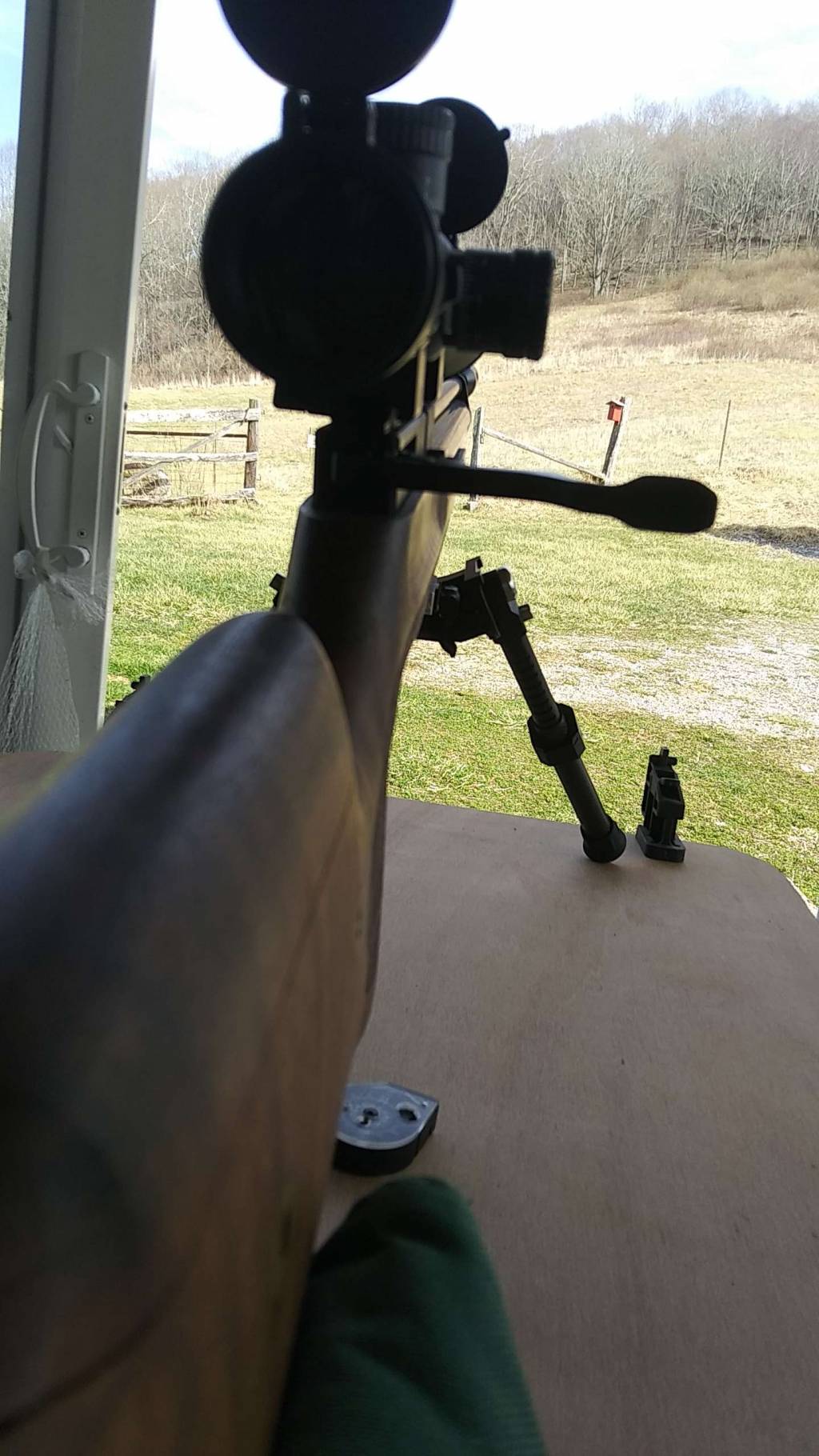

Cayden .22 shooting 150 yds - almost too easy
