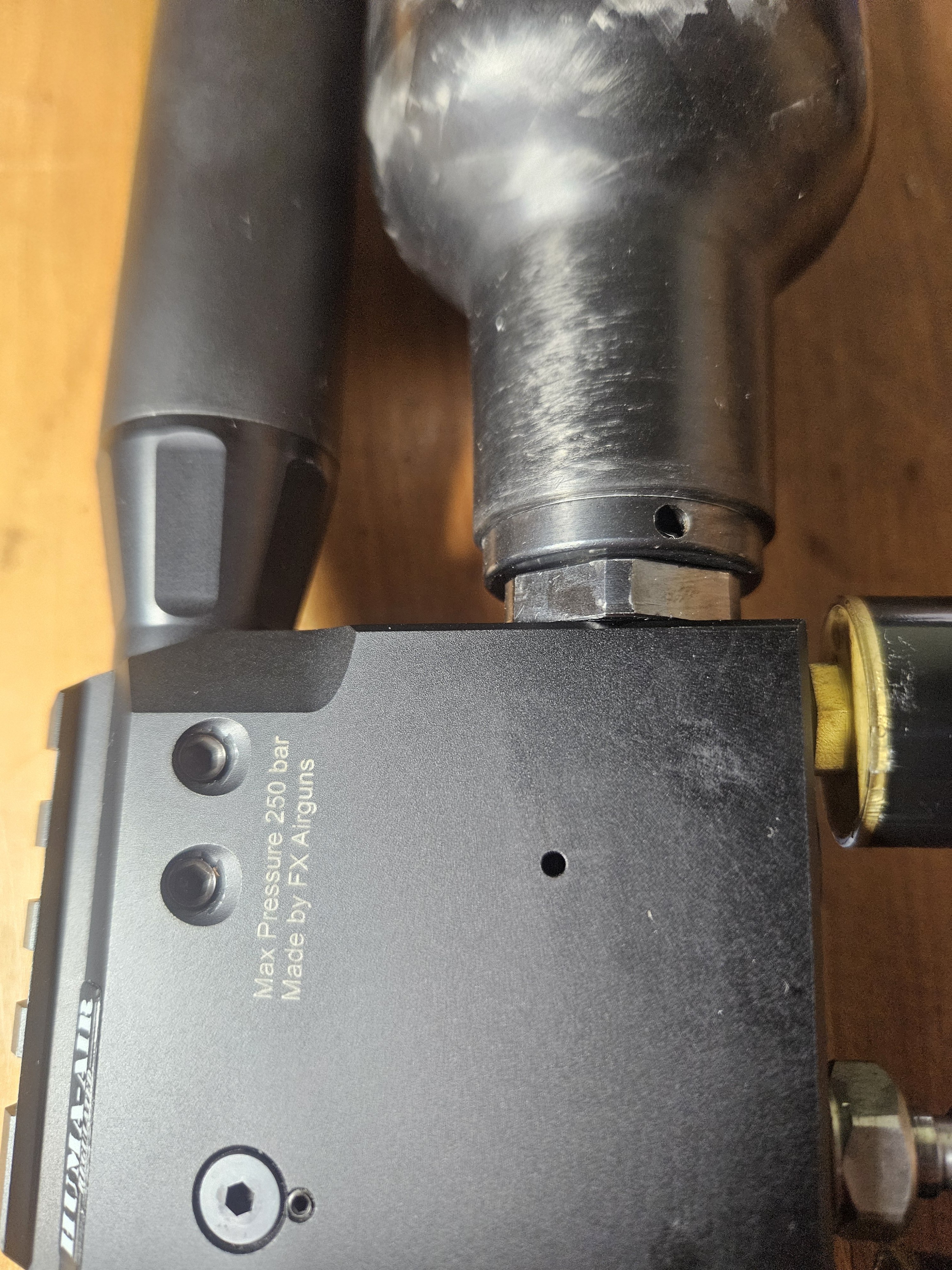

Actually, I just did a Crown MK II O-Ring replacement today and could not see that 'Hidden' O-Ring deep within the threaded recess. So, I called Utah Air and asked about it.
The tech asked for the serial number and finally said that the serial number indicates that there is no 'Hidden' O-Ring on that particular rifle and that when they send the O-Ring fix-it kit, they send the O-Rings for ALL Crowns, which means that you could possibly end up with an extra O-Ring.
I simply replaced all of the others, except of course that one since it wasn't needed.
Finished the reassembly and no more leaky.
I suppose that it's possible that the HUMA may need an O-Ring in that position, but I was only resealing the original regulator Rings.
Good Luck!
