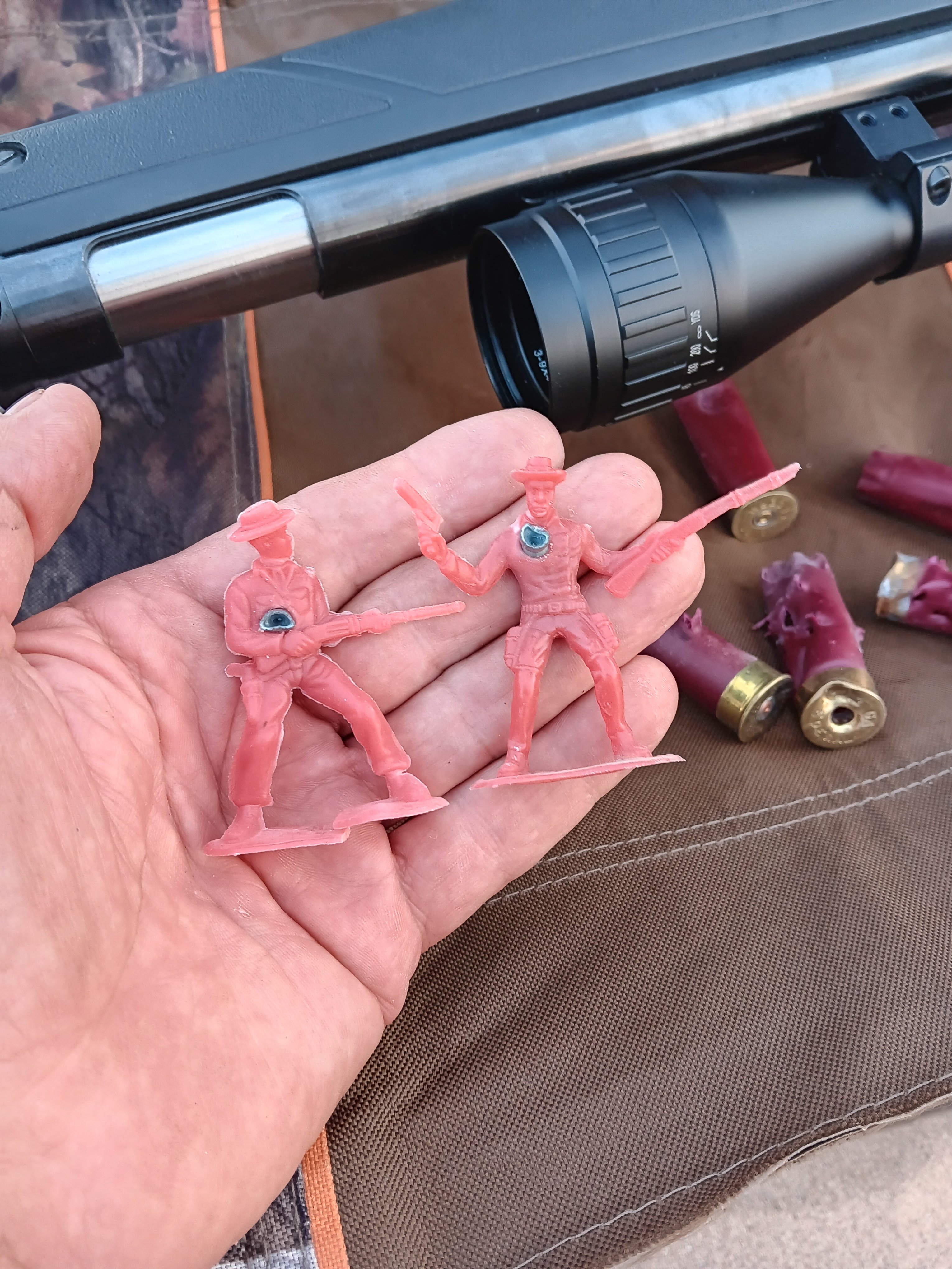

Maybe "accuracy" is a subjective term. Anything 1/2" c.t.c. and consistent at 25 yards to me is a very accurate pellet rifle. I sight my pellet guns at 25 on paper (I rarely shoot patterns at any other range).
A 12ga. Shell is about 3/4" wide and 2 3/4 long (fired). If I can crack one every shot (regardless of orientation) at 50 yards 100% of the time, I'm shooting at 2MOA or thereabouts.
In my experience every HW .22 I've had will shoot most pellets to this accuracy. The better pellets will reduce those patterns to nearly 1MOA on a good day. A great day is when it happens 30 times in a row without a significant flyer or slight POI change.
With that being said my HW95k will outshoot them all. Whether it's the barrel or the weight or both I'm undecided. But it will get almost 100% on a shotgun shell out to 70 yards and routinely prints .50 ctc 15 shot patterns at 25 yards. On a hot day with venus in retrograde it does better than that. That (to me) is an "very accurate" pellet rifle.
I'm not sure how much more accurate a .177 is. Nor how innacurate an HW .22 barrel may be. But the few .22 HW's I have shot have performed very well. Certainly above my expectations for a spring piston pellet rifle.
