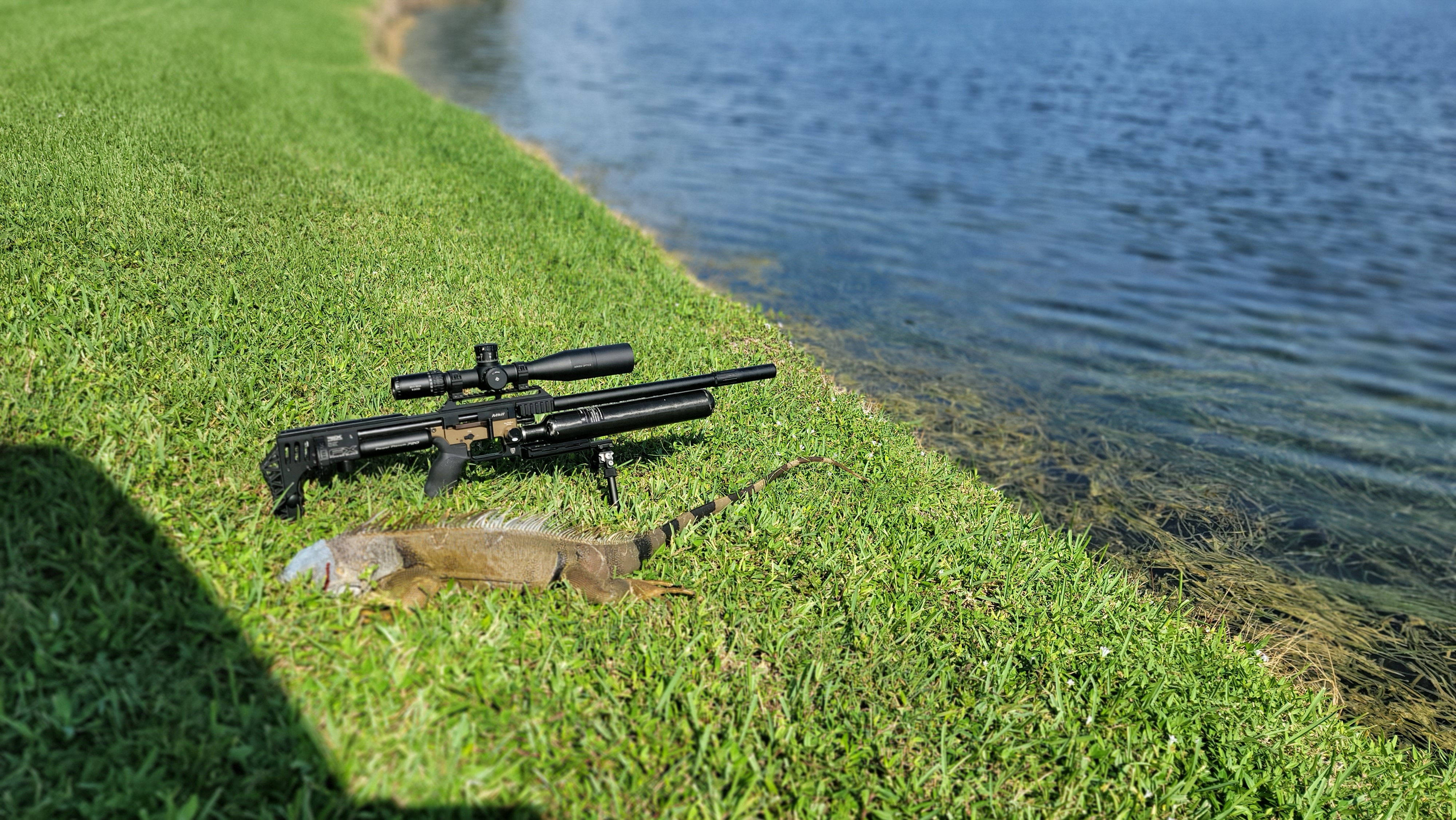

Is the compact version worth getting for slugs? I currently run a .22 700mm with 700cc bottle, 720 plenum, powerblock, and I'm running javelin 30gr v2 at 960fps. But this gun is long as **** for me, and I'm started to get annoyed with the weight.
My idea is to get a 500mm .30 cal barrel and run a dual 300cc bottle. It may still be weighty but it'll be more compact and manageable for me.
I've read post of some of y'all having issue running slugs with the .30 or at least the .30 hybrids and needing specific speeds. So given that 500mm may cap me at about 940fps with the 50gr, am I better off getting the 600mm barrel or will the 500mm be more than enough?
