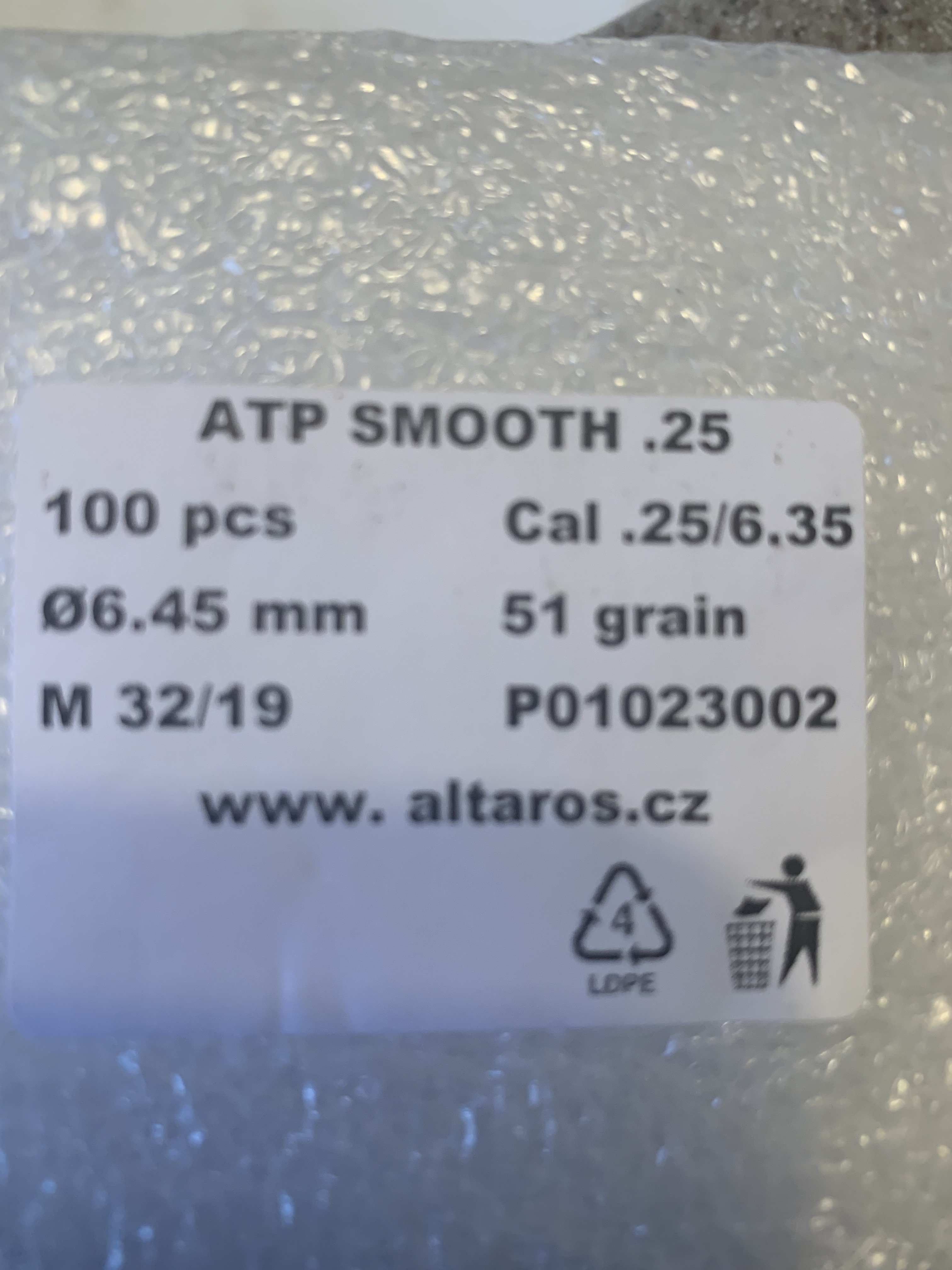

702 FPS with 50 gr @ 200 bar = 54 fpe.
606 @ 130 bar = 41 fpe.
Thanks for the data points! Hows the kick and the bark?
Once you crank like I did… you’ll wake the neighbors along with their dead grandmother buried in the next county over. I’m just hoping the jams go away with more rounds through it. I now rotate the cylinder 3 full rotations after fully loaded but it might just burs from the grooves they cut in each hole to hold the rounds in place.

Same diameter? Curious because I shoot those from my K1 rifle and they’re very tight in the Huben magazine and never jam. Do you know which end of the slug jams?
Couldn’t say. Gave it the old wiggle and fire it out. Never saw the slug. Like I said, might be a one off due to burs but everything loaded easier the second time except for one hole but maybe fully rotating the whole cylinder once loaded resolves it.
