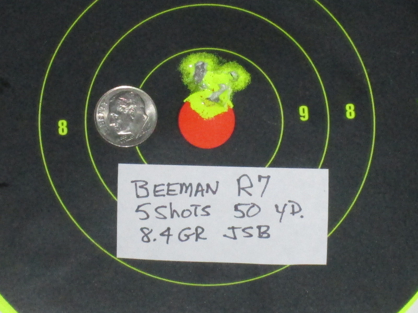

LOL!....friggin amazing
Thanks. It's friggin hysterical too. Takes so long for the pellet to get there and then there's a noticeable sound delay between the seeing impact movement and hearing the tink sound of two whopping pounds of energy.
At Sean Gabrells range I went fifteen in a row on a 4" square junction block cover at 102 yards. Great guns, by far my favorites.

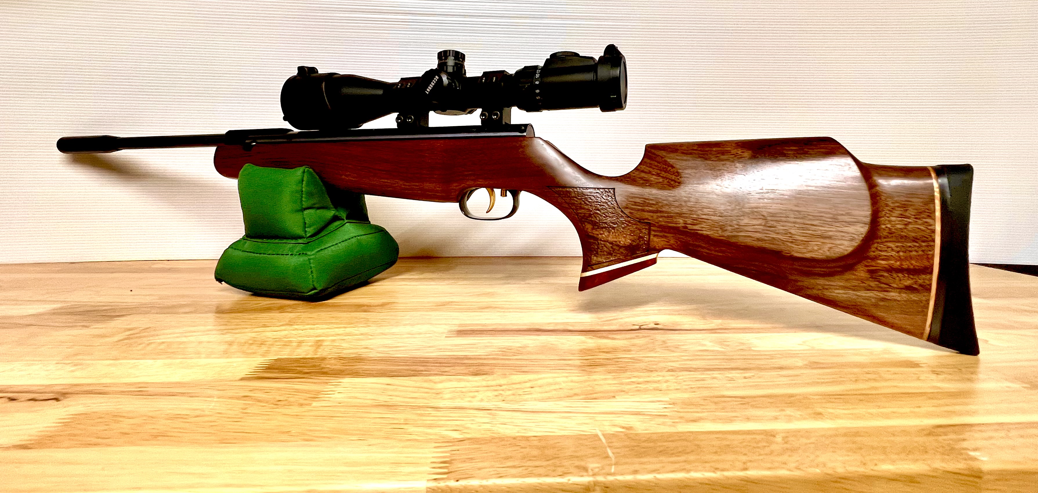

Installed the JM kit plus the short stroke piston seal. Getting 447 fps average w/ 13.73 jsb .20s. The shot cycle is super nice though. Also had the vortek in and that was much snappie and the velocity felt higher, I’ll have to chrono that some other time.
Any updates ? Looking to see if it’s worth adding the short stroke or not.
Sorry, have since sold that particular 30. Worth it for experimenting and just how fun it was to shoot. Keep in mind I was limited to ~10 yards. Either kit works, kinda felt like a shooting a pcp, (uninterrupted view through the scope while firing).
