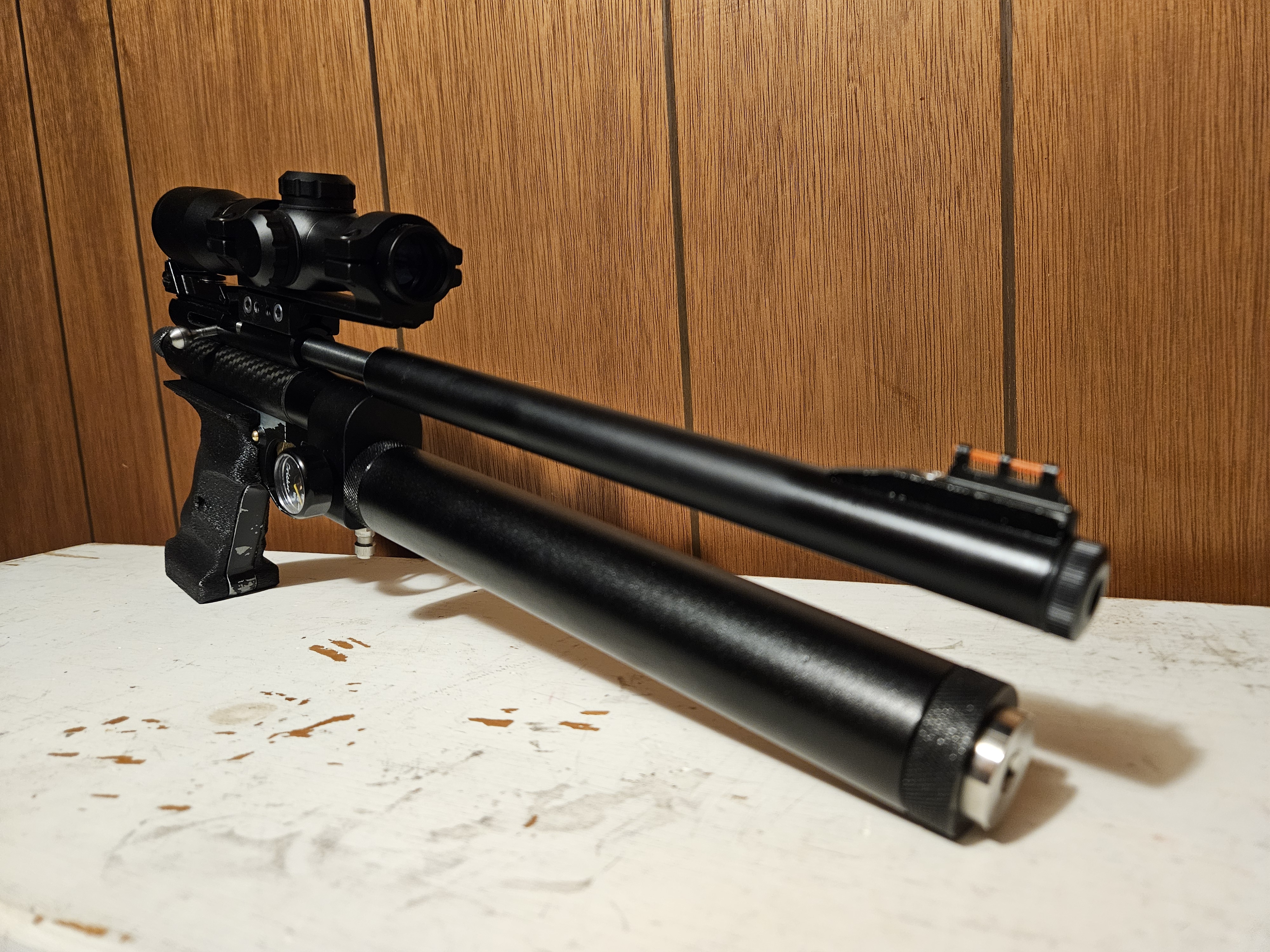

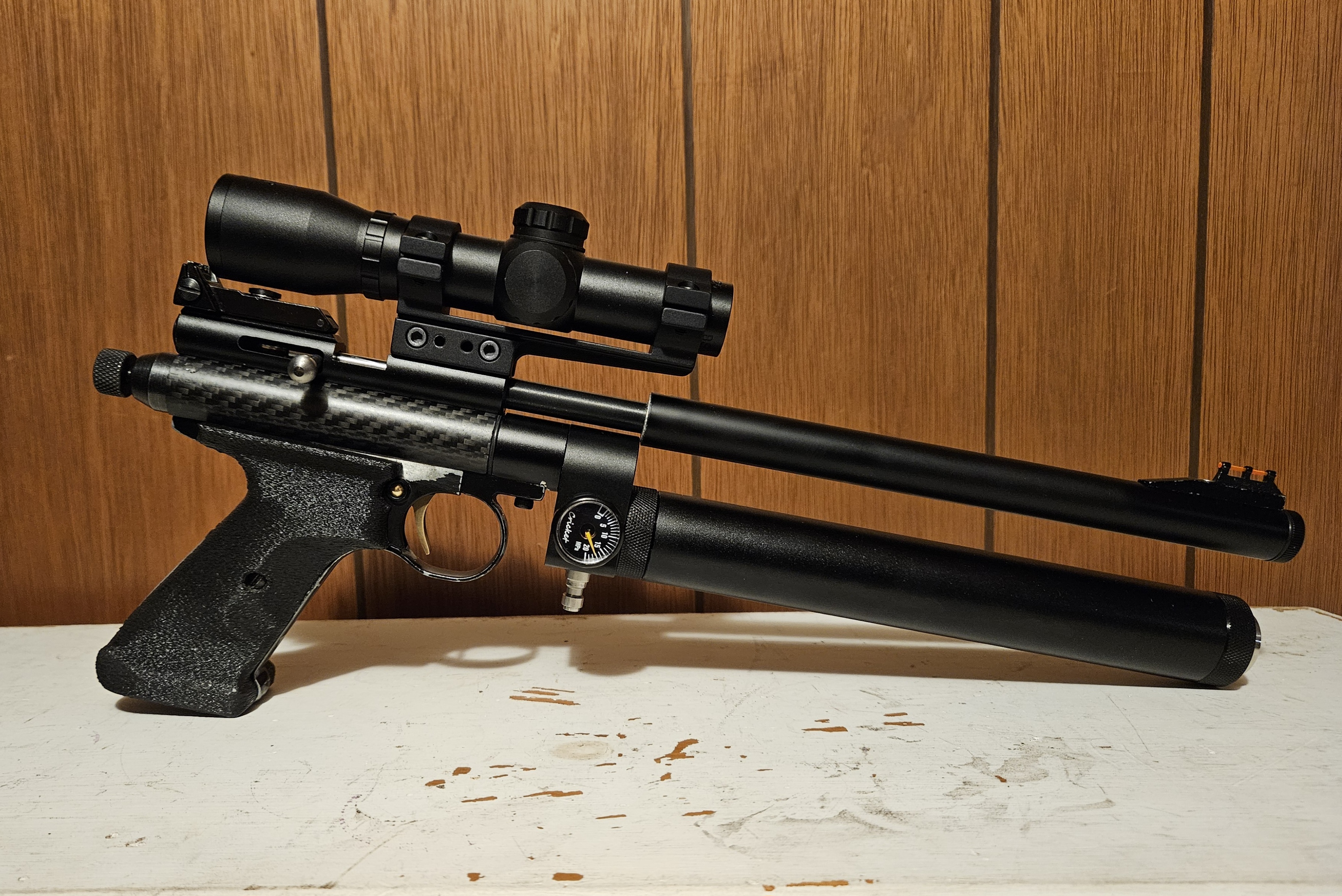

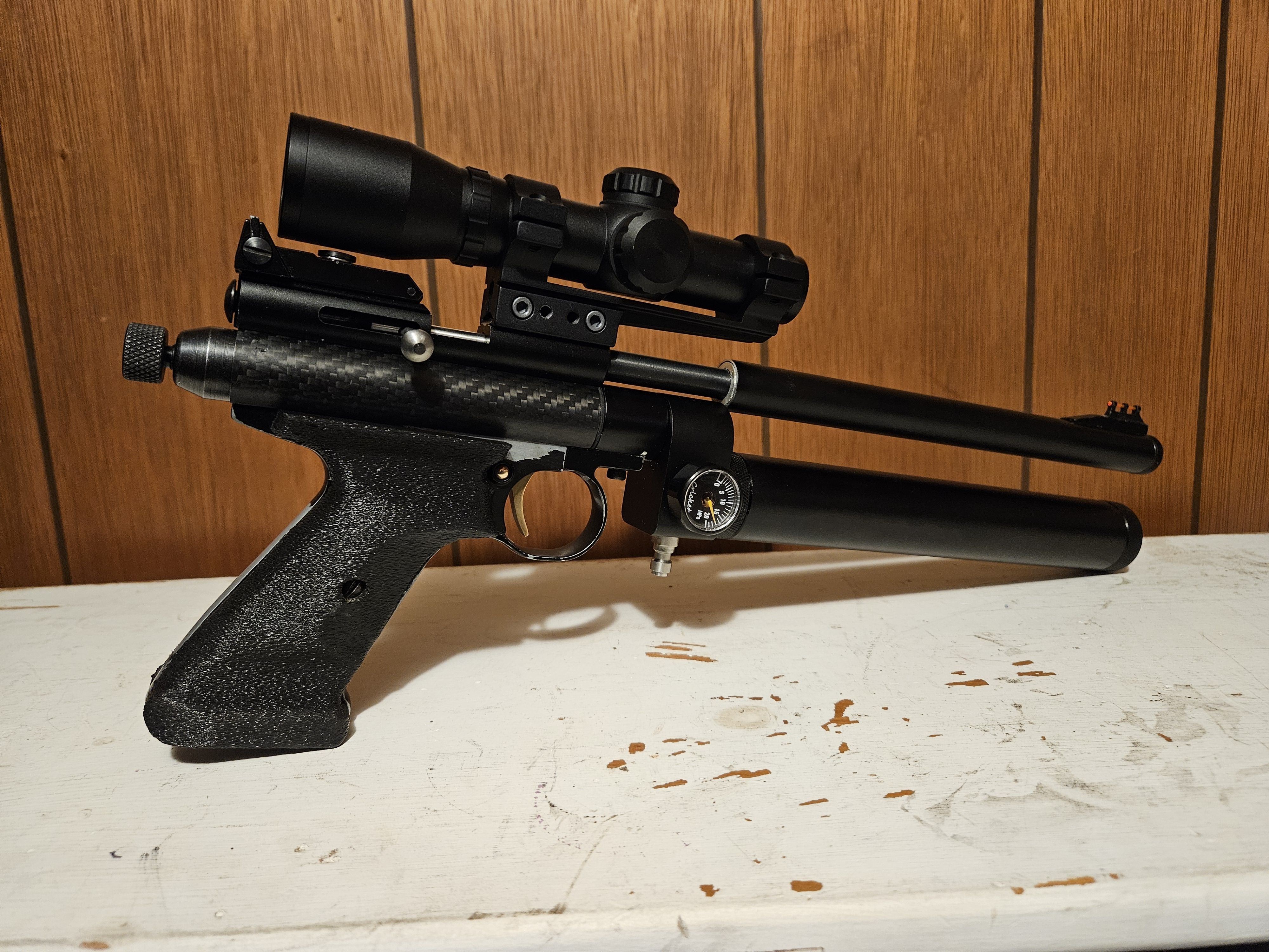

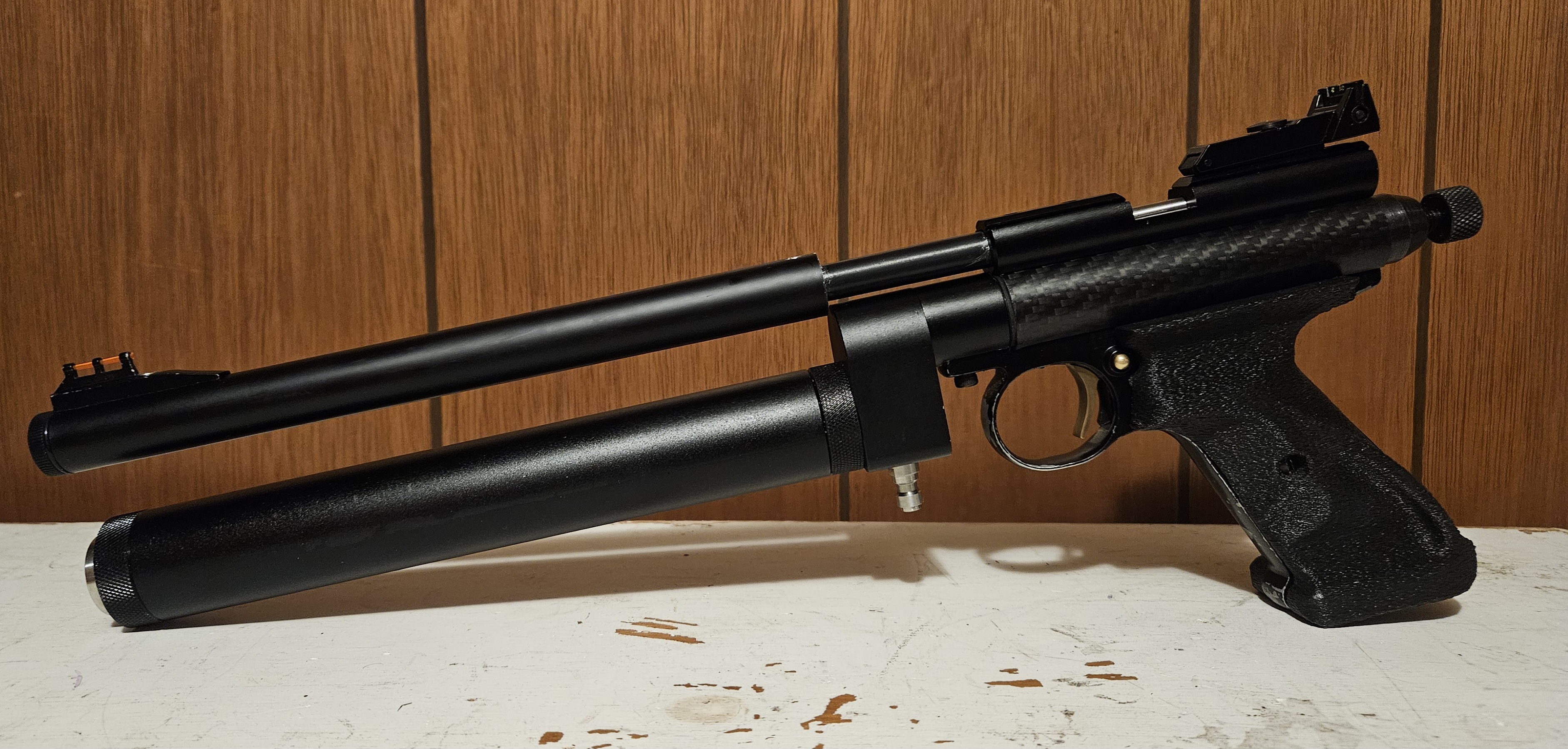

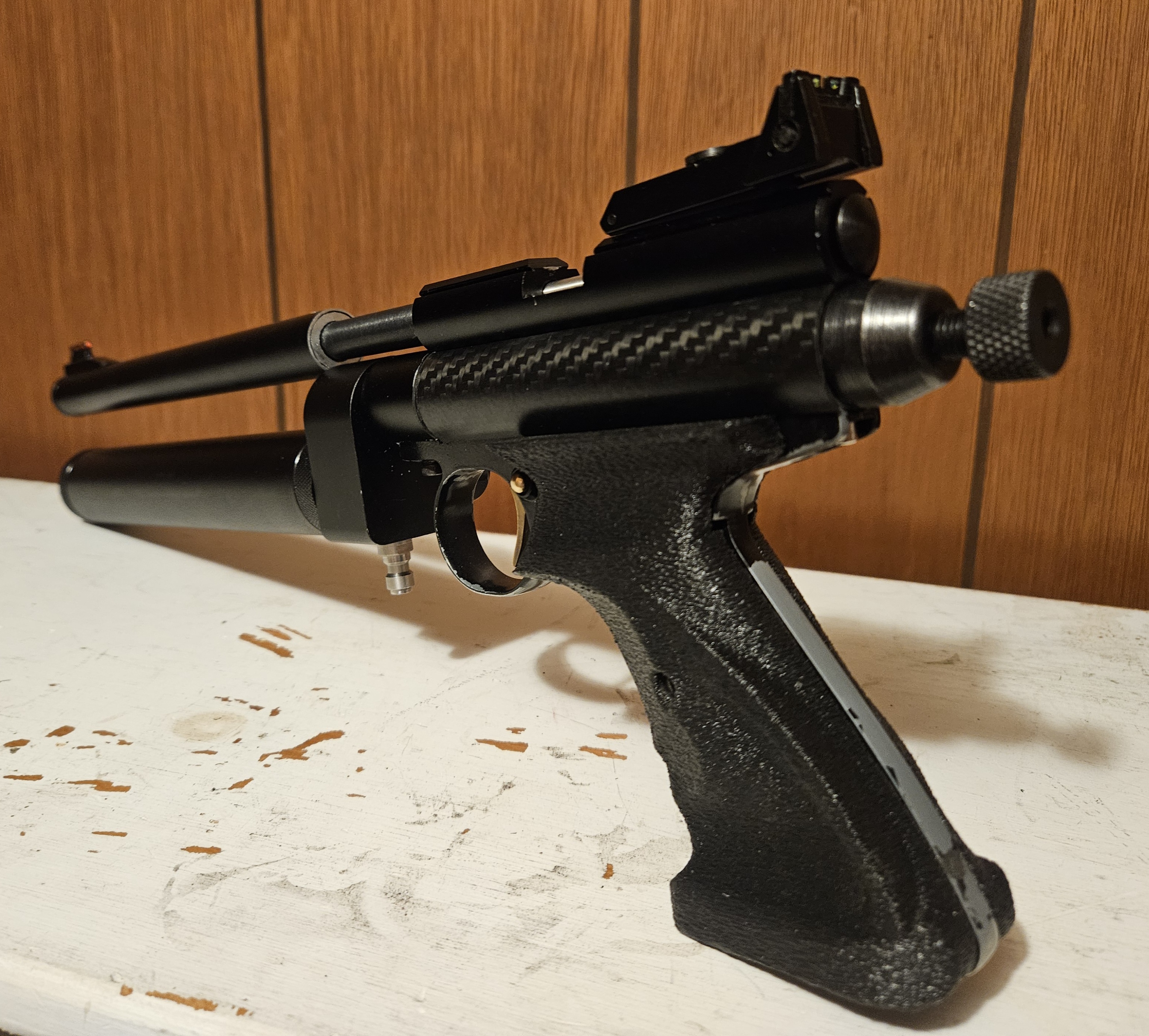

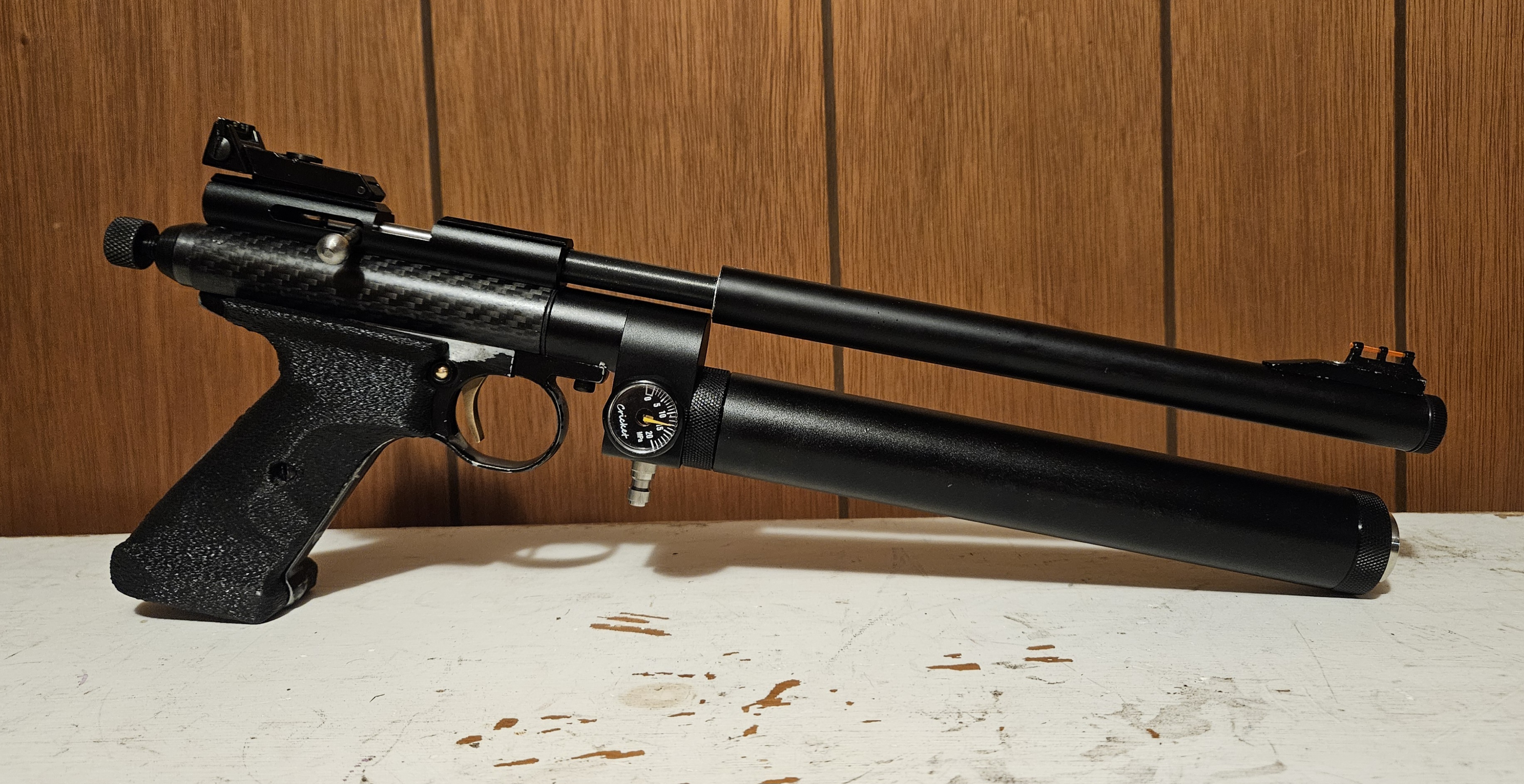

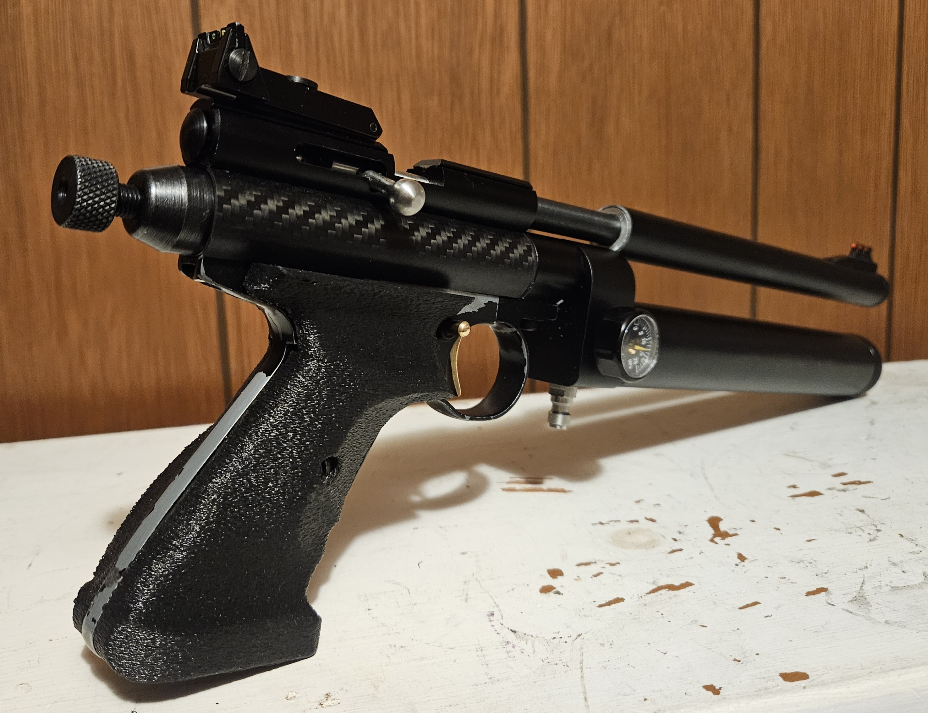

I had a bunch of parts laying around and decided to come up with this.
Pcp, running 550 fps on a 2000 psi fill and current spring. Have some better springs coming for it, hopefully break into the 600s with this 10" barrel. I've seen north of 20 fpe with this barrel, so shouldn't be too hard to achieve my goals.
Getting plenty of shots off the 100cc tube, and pretty quiet thanks to the shortened Prod shroud and air stripper. No baffles needed for now.
Trigger could be better since it's a single stage, but it's as light as I can get it. Maybe put a Prod trigger group on it some day if it proves worthy.
Drilled and tapped the breech for the metal iron sights I stole of a gun I can't even remember, as well as the front sight tapped to the shroud.
So far I'm holding quarter sized groups at 20 feet, so hopefully I will achieve my goal of squirrel hunting soon.
Maybe a nice set of zebrawood target grips to finish off? Need to repaint the grip frame too.

Yep I used one of these and might buy a couple more for carbine and pistol builds I have in mind.

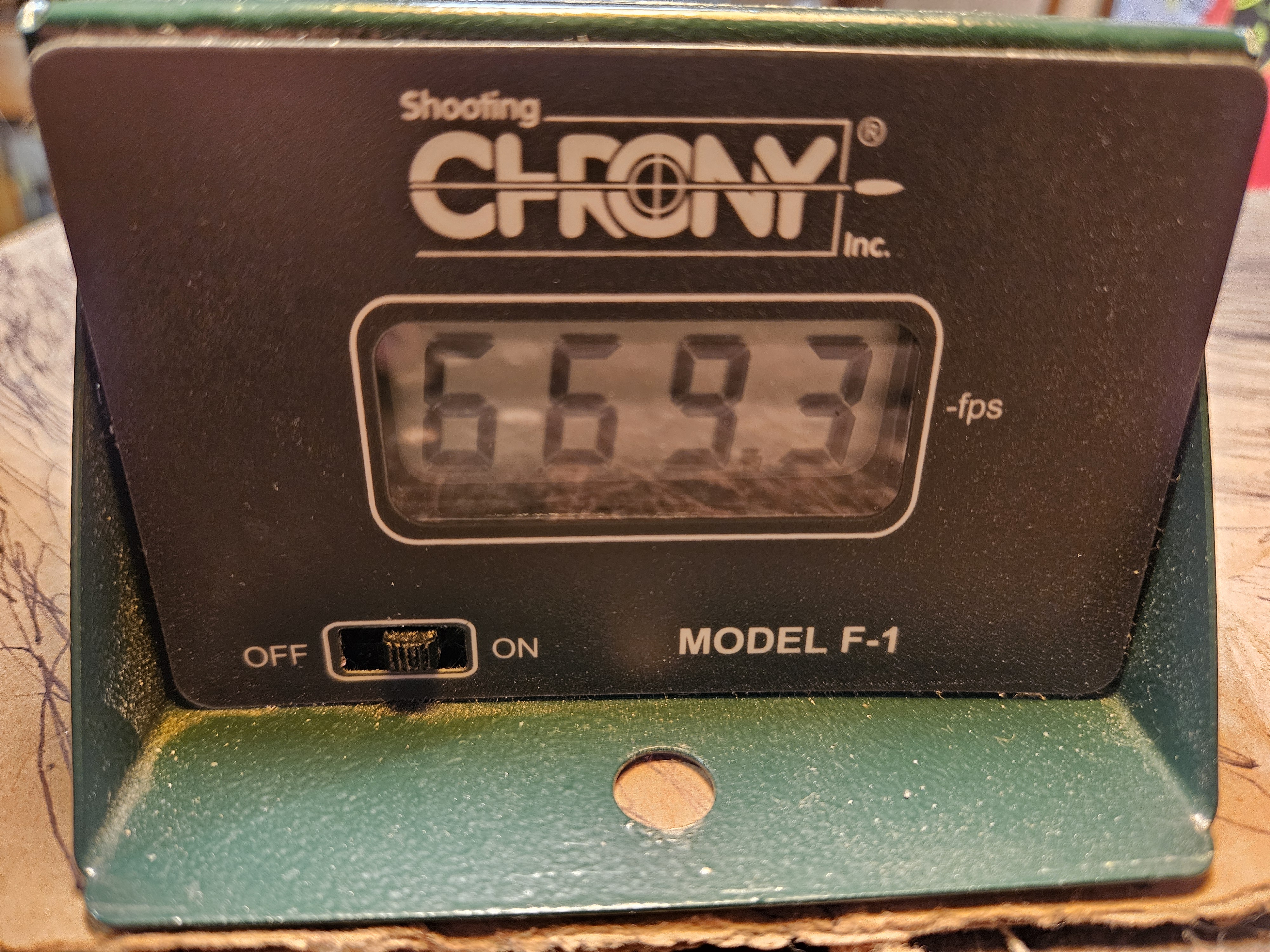

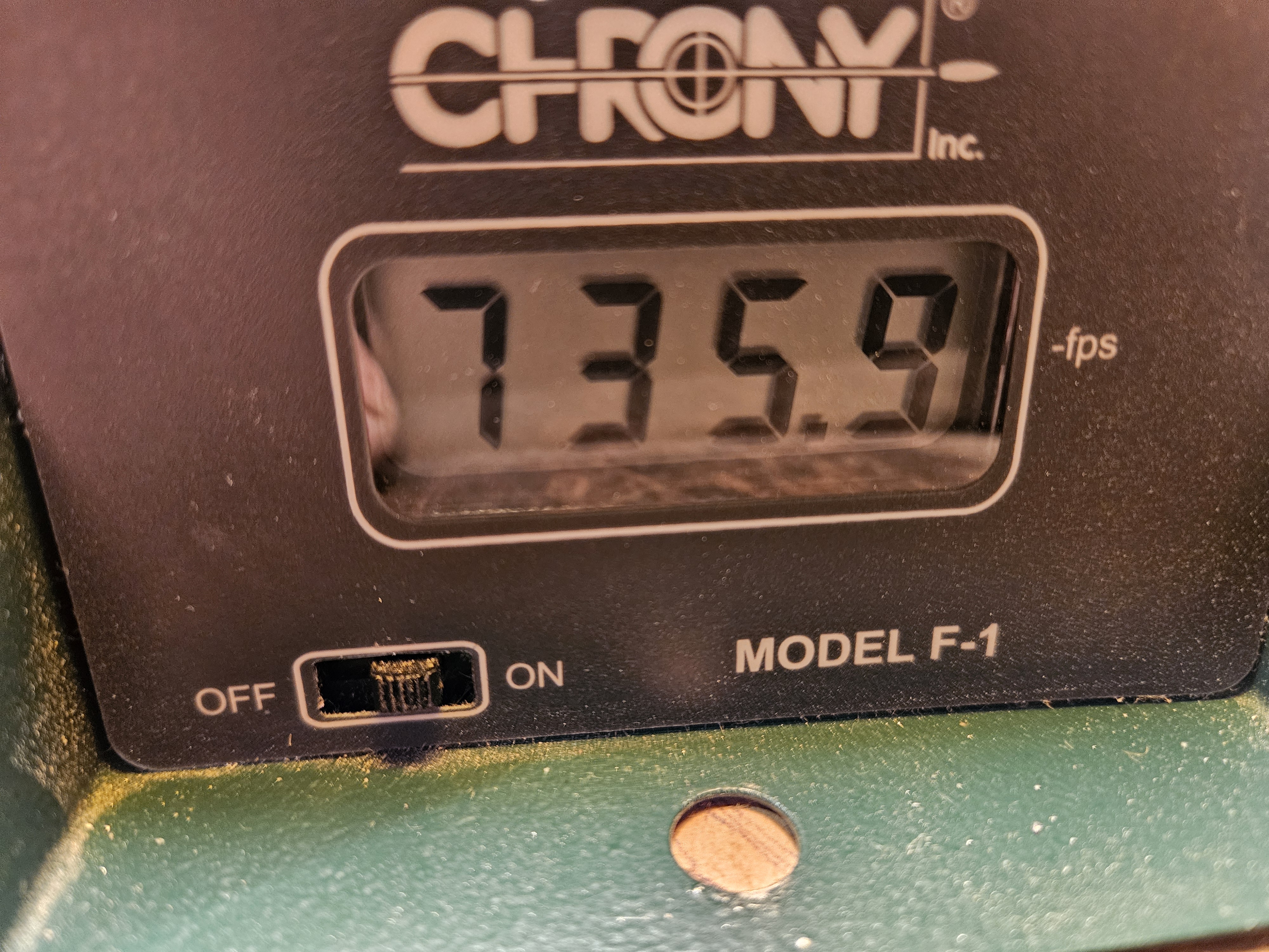

Got my hammer spring set today. Went with the .042" wire and it's not doing 730s for 50 shots with 14.3
And doing 660s with 18.3 aea pellets for over 60 shots.
Way more efficient than I had thought it would turn out. Not too much louder than before due to less bounce. I will probably dial it back a bit to make it even quieter.
Next up will be some nice grips.

Here she is with the Edge 2x20 mounted up with a BKL-254.

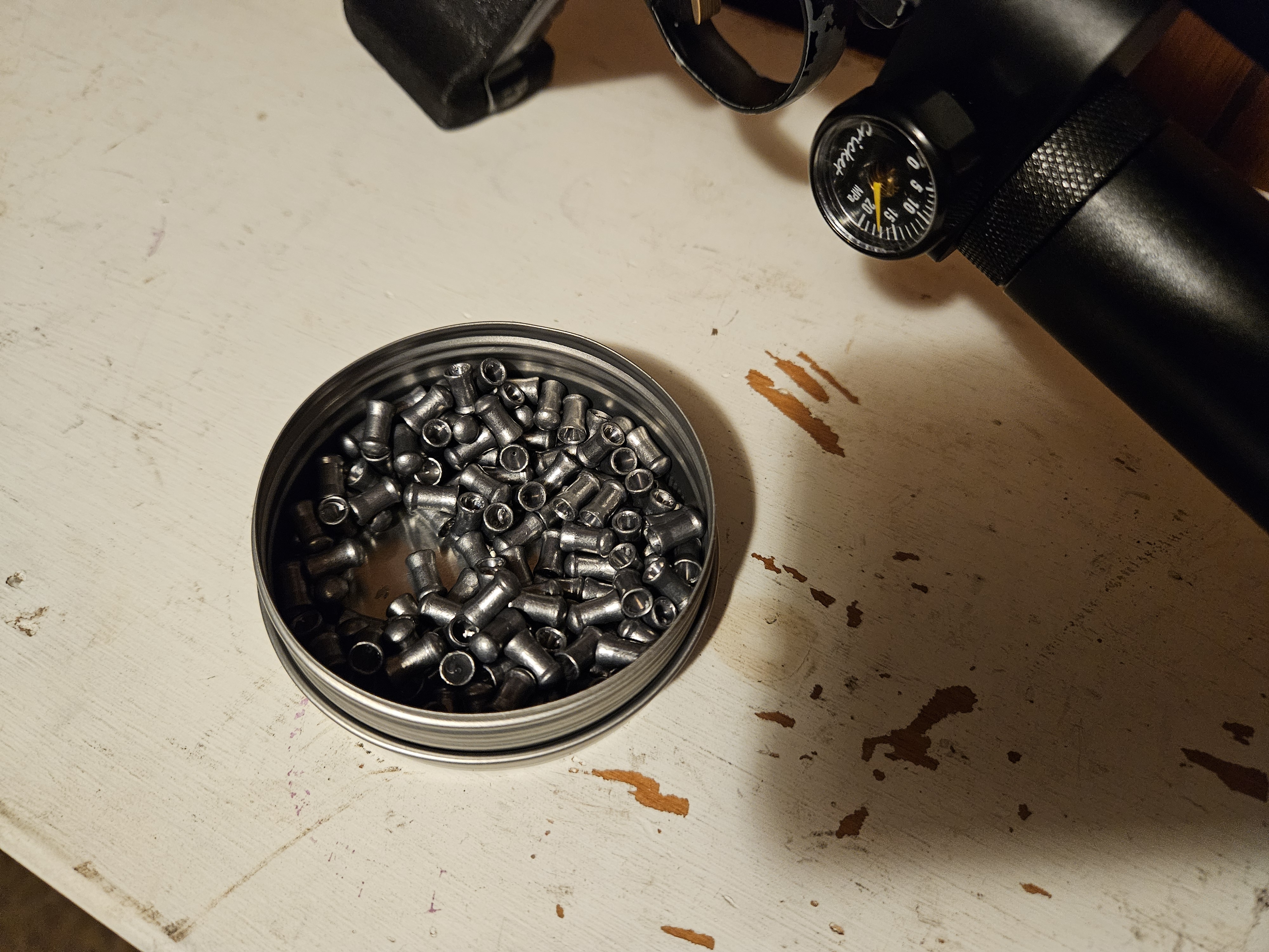

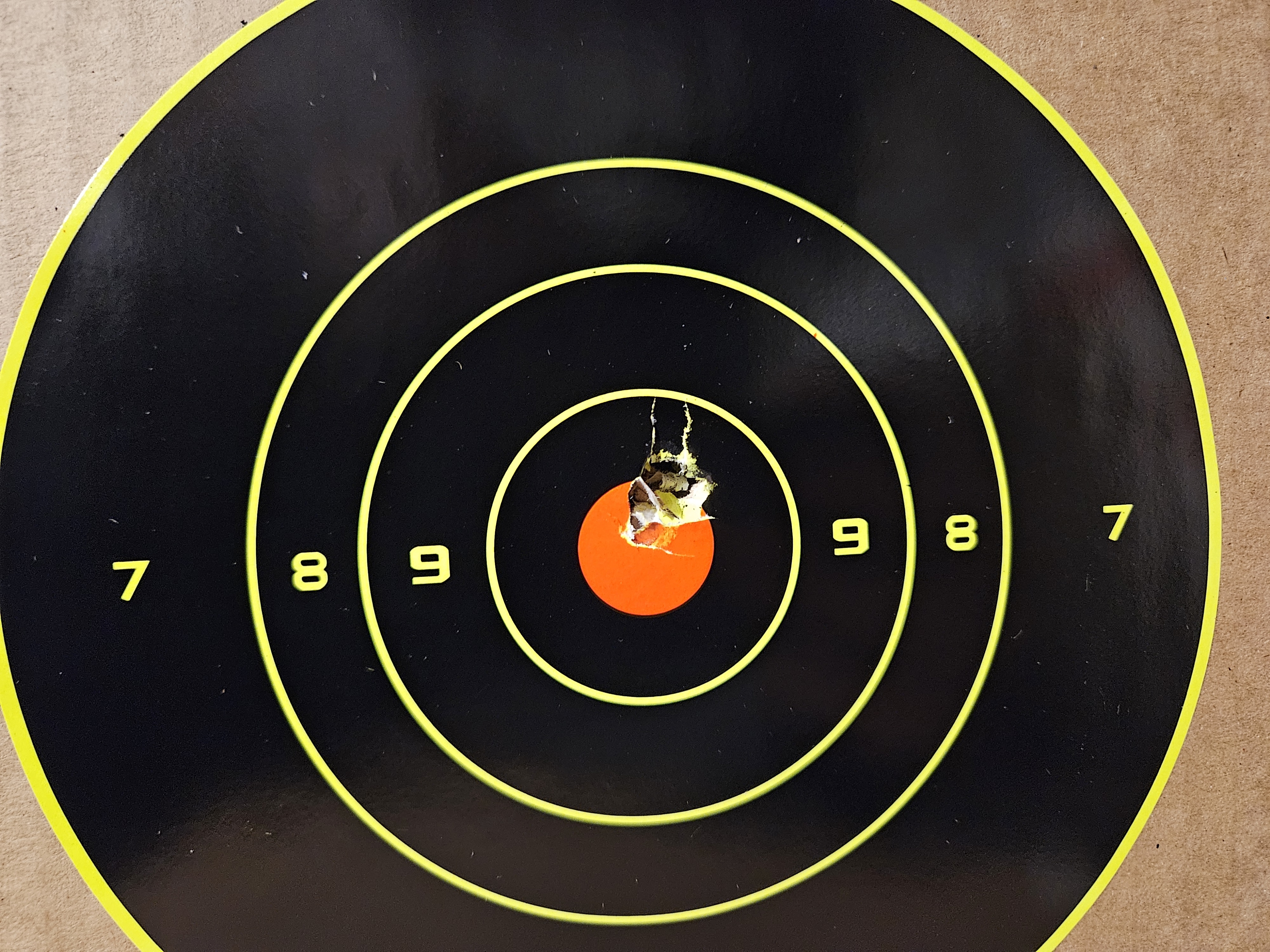

I sighted in on the 7 yard basement range, and it's dead nuts with hades and polymags. I decided to try some Apolo 25.4s I had laying around, and they gave me this 10 shot group.
That's a big ass chunk of lead for a pistol, but im going to recenter the scope with these and try for a squirrel or some pest birds tomorrow. They also bring the report down considerably.
