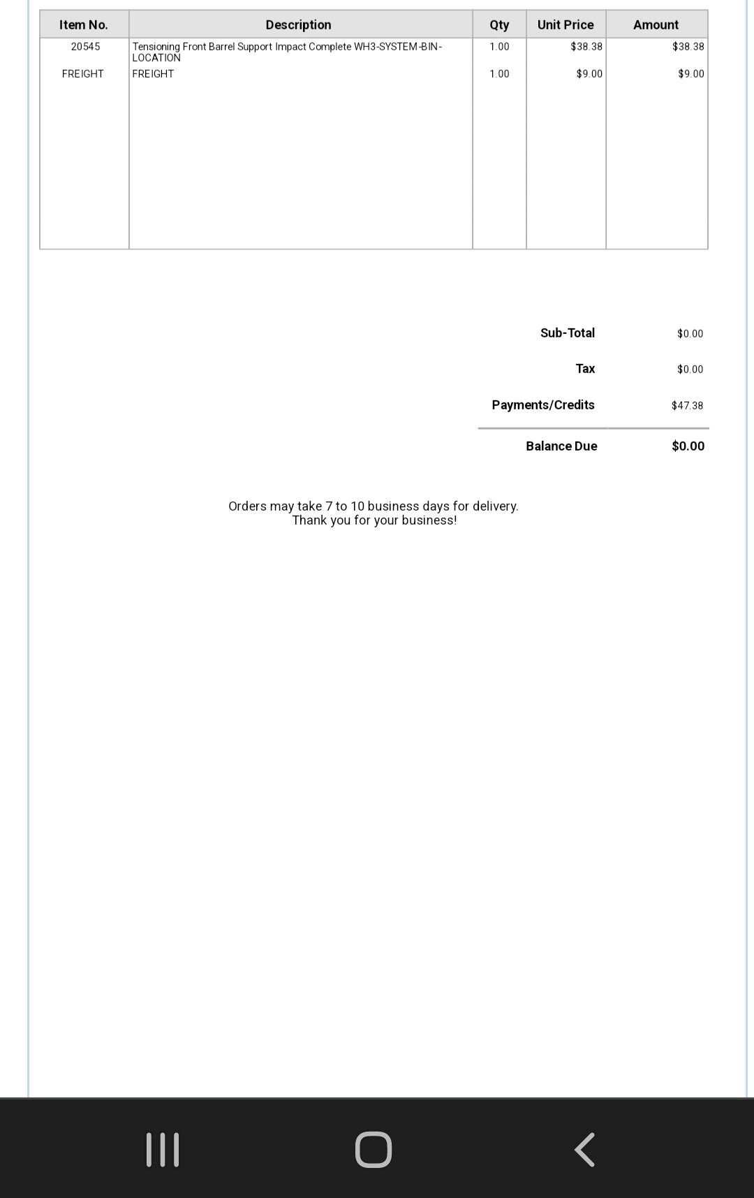

Does anyone know if the front barrel rest with the clamps for the Impact m3 in the tensioner kit comes with the new FX impact M3, just wondering if i should replace it on my new M3, is there any way just to buy that clmp front rest.

I ordered one directly from FXUSA
