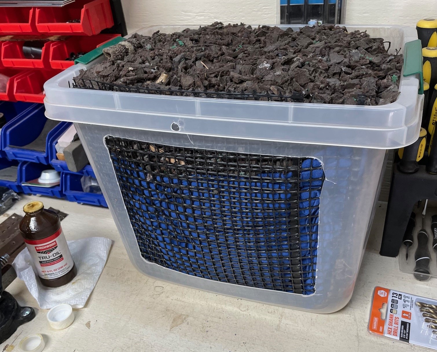

I use plastic hardware cloth doubled over with an old T-shirt behind it to get rid of the cardboard "smack" to make it even more quiet.
Plastic tub with a hole cut in it. Piece of plywood cut to fill the back (just in case). Hdwe. cloth, t-shirt hold it up against the hole with your hand and fill the open space with rubber mulch. (I had just built this one....need to scoot the t-shirt up a little.)
Very smart. Thank for the tip.
