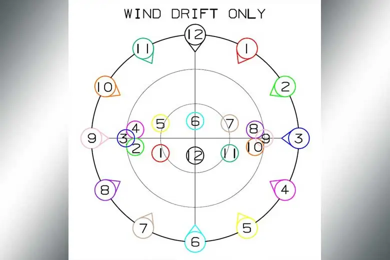

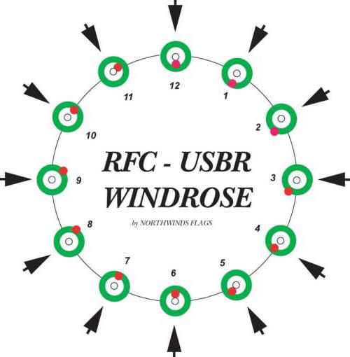

So i began to set out wind flags and strings and study the wind and watch how it affected my Point of Impact.
Then i started to apply the info from my Rose Chart and began to watch how using all of that info changed my POI compared to my it point of aim.
WOWZA!
Within just two sessions, with my least expensive rifle scope combo, my KZ scores jumped to 88%.

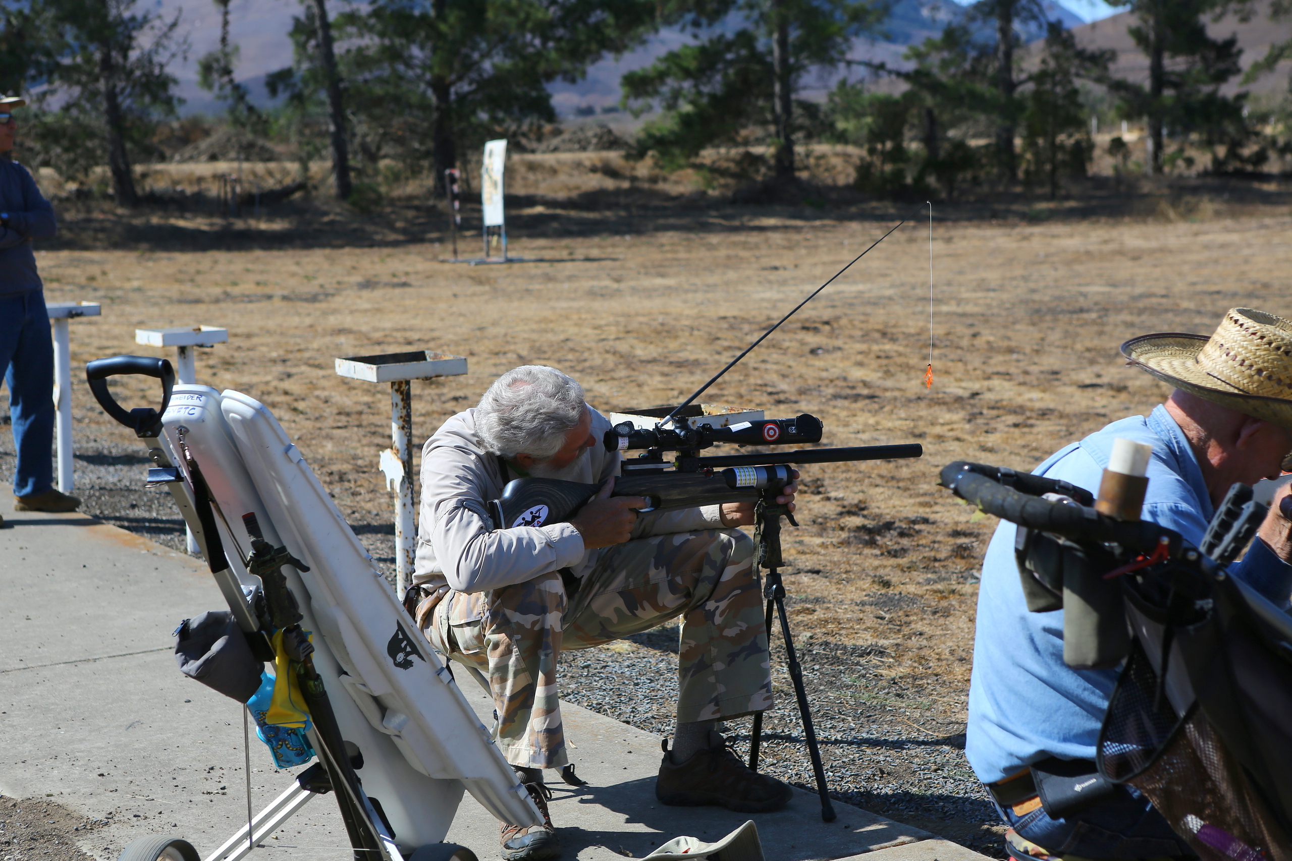

There are wind flags ( Streamers, Magnetic tape, feathers etc hanging on short posts or zip ties close to rifle ) then there are WIND FLAGS that do more than flutter against the wind giving vague indicators of speed & direction.
Shameless plug ... I came up with this idea a few years ago using a telescopic R/C antenna on a swivel mount, Long string and a very stable flag type end. As such you get an accurate Direction, able too with practice get an idea on speed being how far the flag is pulling string back while able to see this with your non optic open eye, as the flag is out in front of you and slightly above your line of sight.
When done with shot it all collapses to @ 4-6 inches
It is slowing catching on and it's been fun watching others apply such a flag/wind devise with much success.
I bought a wind indicator like that from Cameron that I used on Sunday and it definitely gave me a better idea what was going on vs my other one. It's nice it swings up and out so far making it more visible! Now I need to find the right string to use along with a tiny swivel and feathers.
