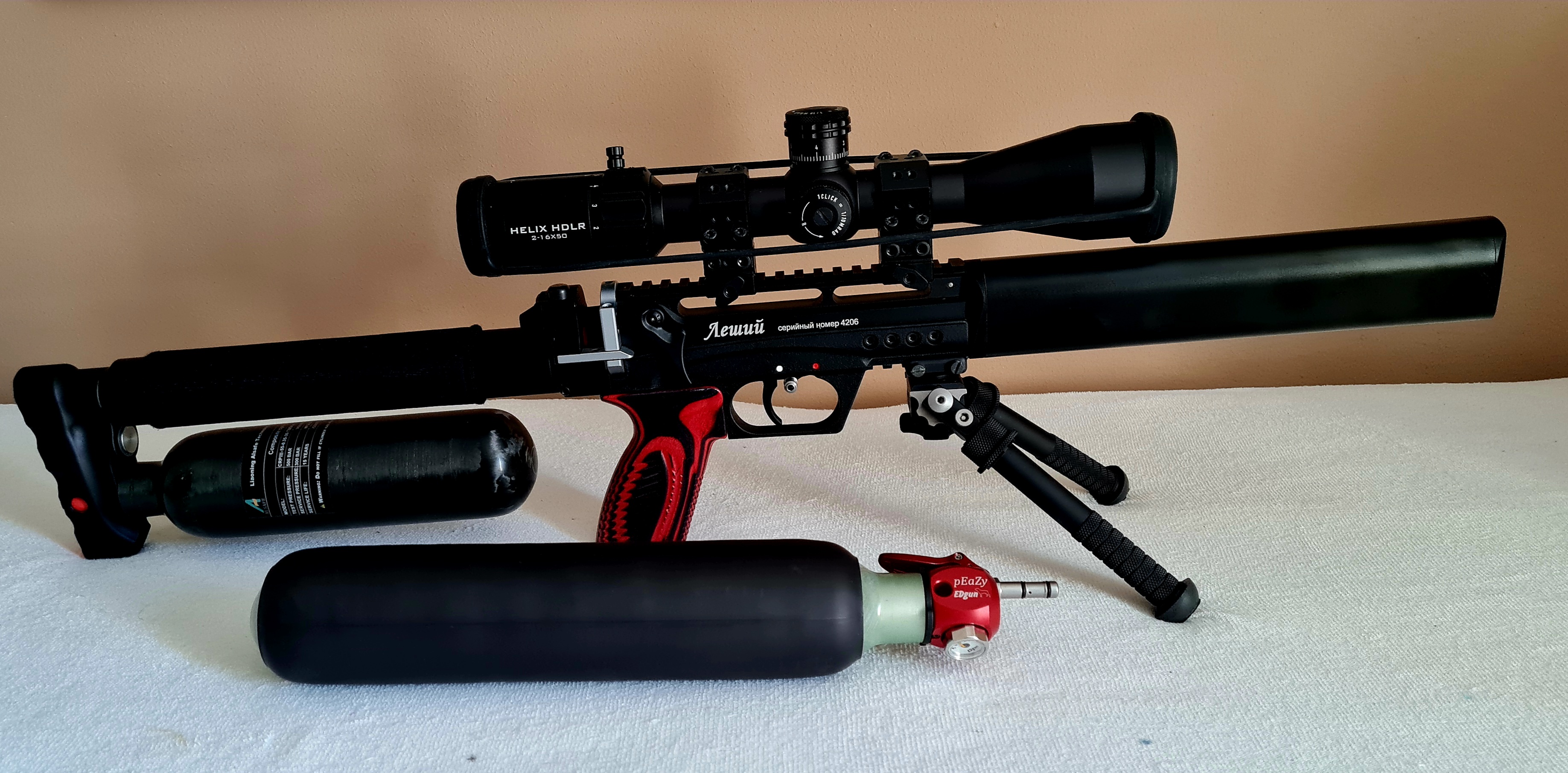

I did read this whole topic, 35 pages, took me a couple of days, felt a sleep a couple of times, but I survived.
After all this crap in this topic I decided to sell my Maverick and buy the L2 from Ed. I think its the perfect gun for me.
Respect for Ed the creator and businessman.
Peace to you all

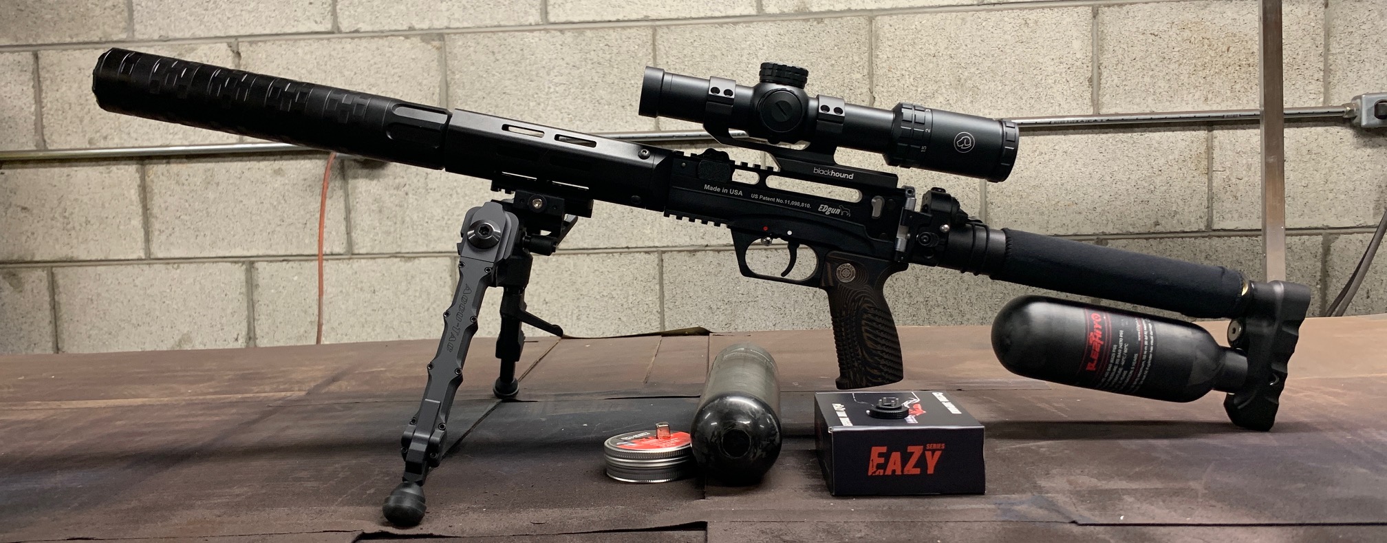

That is funny, I did the same thing, but not from reading this article. The Maverick VP just got to heavy and cumbersome to carry for hunting the woods.
Haven't even sighted mine in yet.
