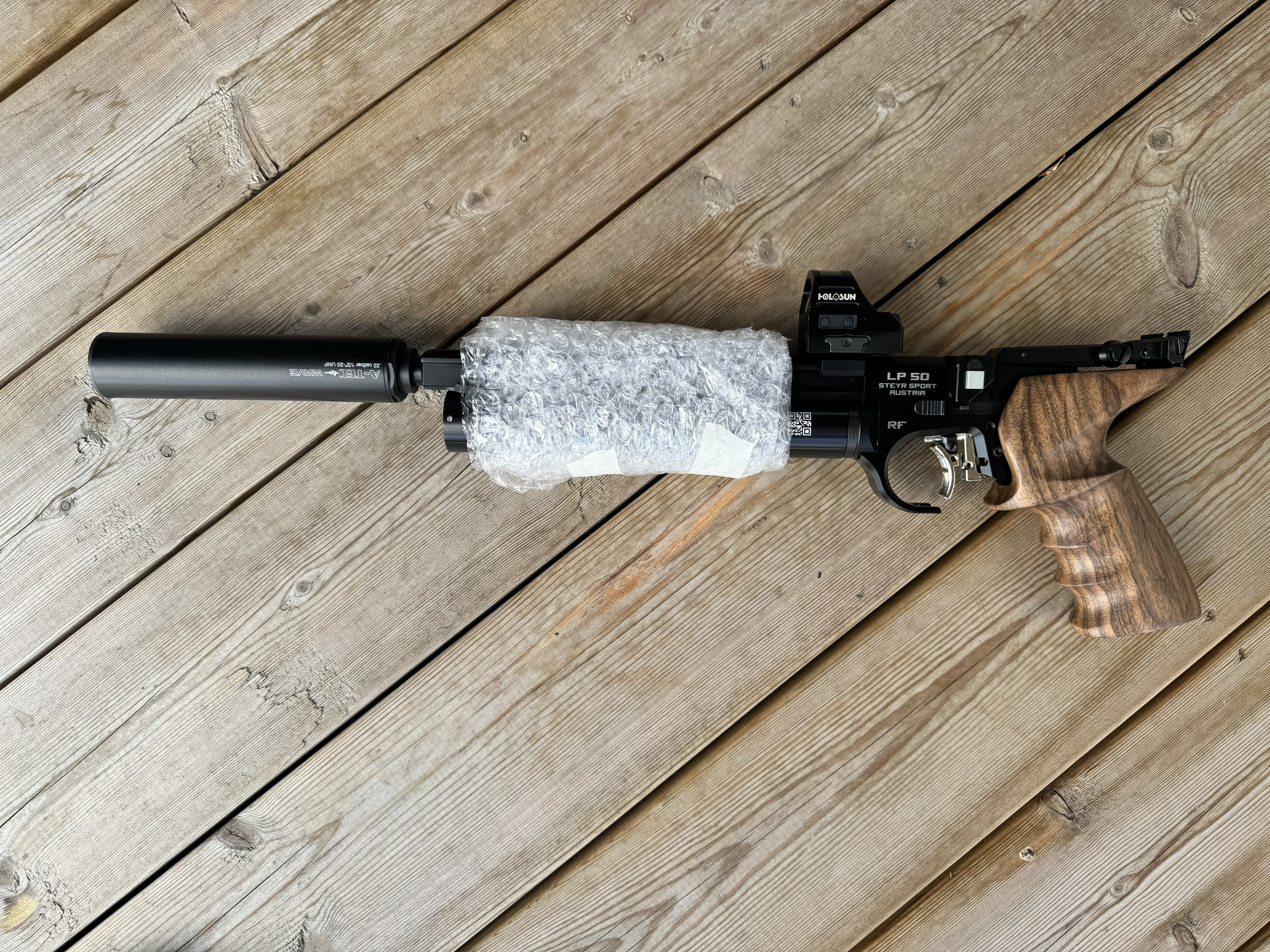

A moderator helps, but two turns bubble wrapping reduced the sound even more. I am certain there are more effective sound reduction material that will keep the “Steyr blast” down, but this was what I had available at the moment.
G -,
(Just kidding but) 8 or 10 turns of bubble wrap or 1 XL Tee shirt would probably work even better.
To most folks surprise, there's a LOT of noise that comes from between the breech & the end of the barrel on these RF & HP guns. That's even after you've taken steps to block off the 3 holes drilled in the top of the barrel. Don't know about the standard LP50. I haven't heard one of those lately.
I used some Dynamat material attached to some Ballistics cloth and wrapped it around the barrel with small Velcro straps. Works great to snuff the ports.
I went a step further and took this thin brass sheeting (a little thicker than aluminum foil) and used a little 3M spray adhesive on it to stick it down over the 3 ports drilled in the upper barrel on my LP50-RF. The clearance is so tight between the "shroud / barrel surround" and the barrel that's the only thing that would fit and still let me slip it back on.
I couldn't use something like @stoutblock is showing in his picture because there isn't enough clearance between the air cylinder and the bottom of the "shroud / barrel surround" for the velcro straps to pass through. VERY tight clearance on mine.
Anyway, it does block off the air from escaping but the pistol, but, even with a Weihrauch moderator on it is still louder than I'm comfortable with for "backyard friendly".
For a pistol that's tuned to 4.8 fpe, it sure lets out a heck of a crack when you pull the trigger.
