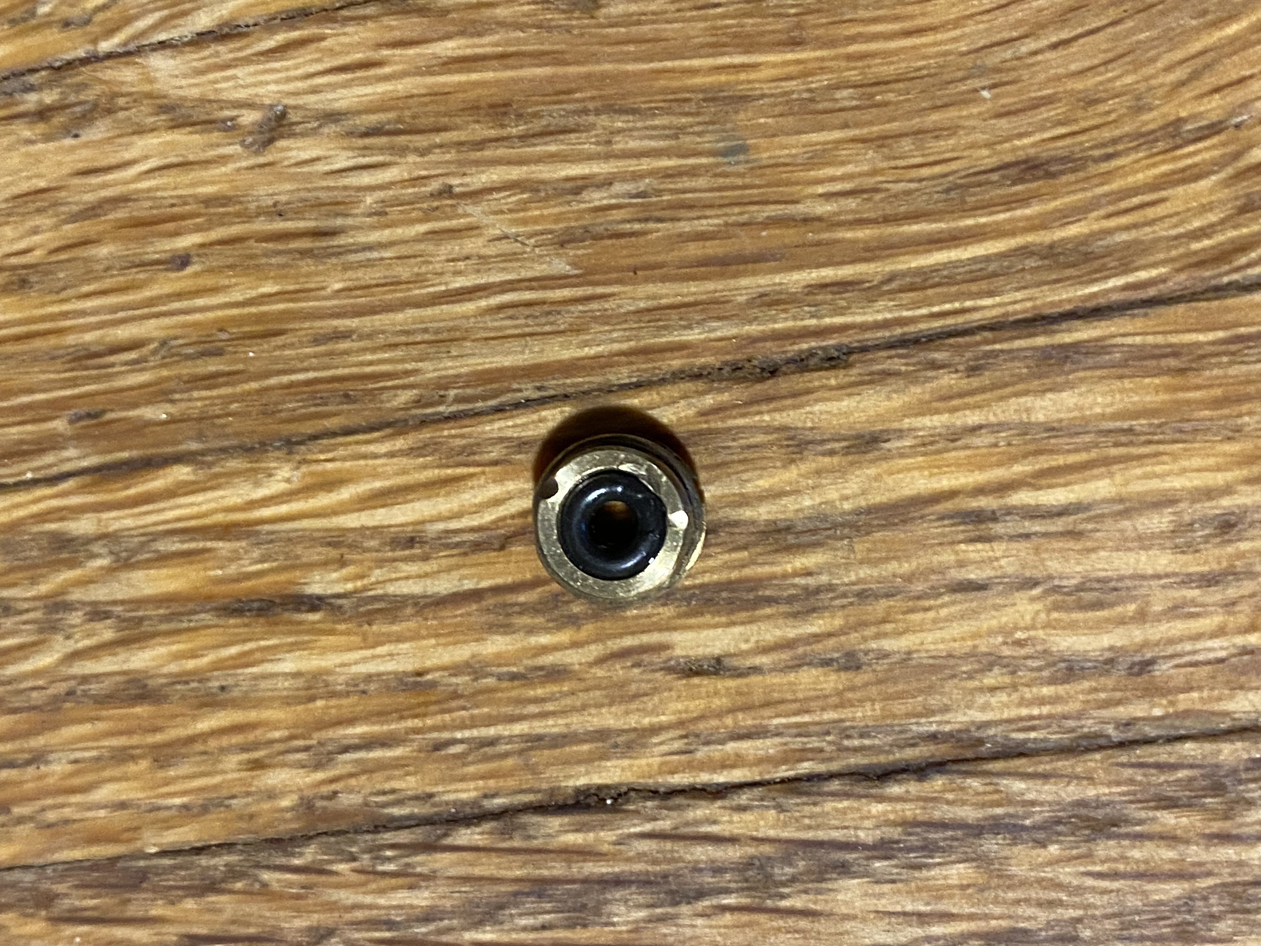

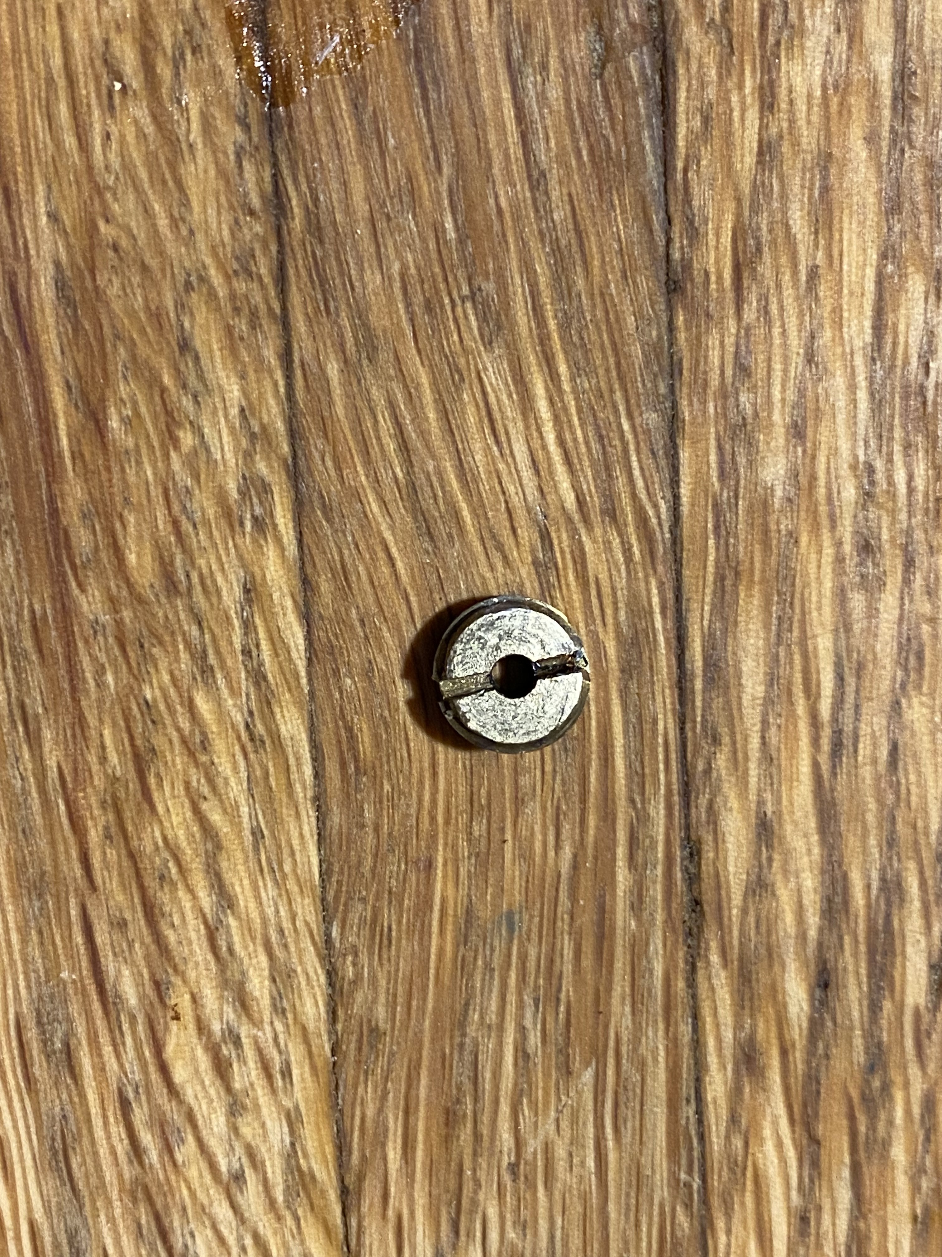

This piece that holds the poppet o-ring unscrewed after first 500 shots! It looks like I have to take the poppet out to screw it down tight with a flat head screwdriver. Should I use lock tight?
Use Vibratite on the retainer. You want access and if you bind brass, you'll end up destroying it to take it out.
