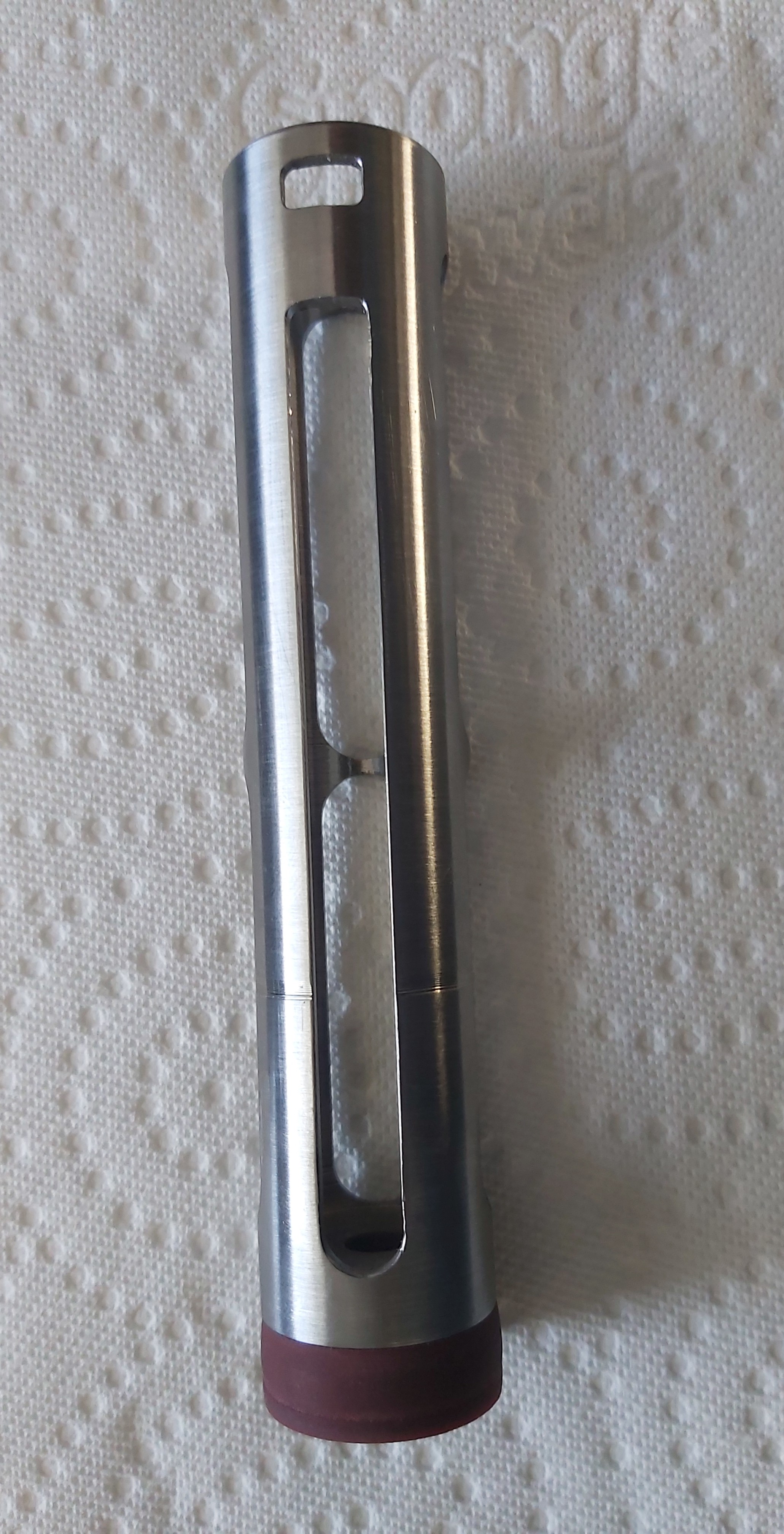

So it was for Weihrauch. No bionic pistons . Guess there may be issues with it.Vortek was teasing with a "Bionic Piston & seal". It looked interesting & was briefly advertised on their website. These were going to be for the Magnum Gamo guns 33mm too.
There's 2 kinds I guess of the 33mm you tell by what color your guns is . I think blue is common 33mm and yellow(???) was magnum guns don't know what or why 2 unless the piston button/ anvil part they attach to is different (???) being for some reason no one want to offer the seals outside buying from custon air seals Australia .Vortek was teasing with a "Bionic Piston & seal". It looked interesting & was briefly advertised on their website. These were going to be for the Magnum Gamo guns 33mm too.
