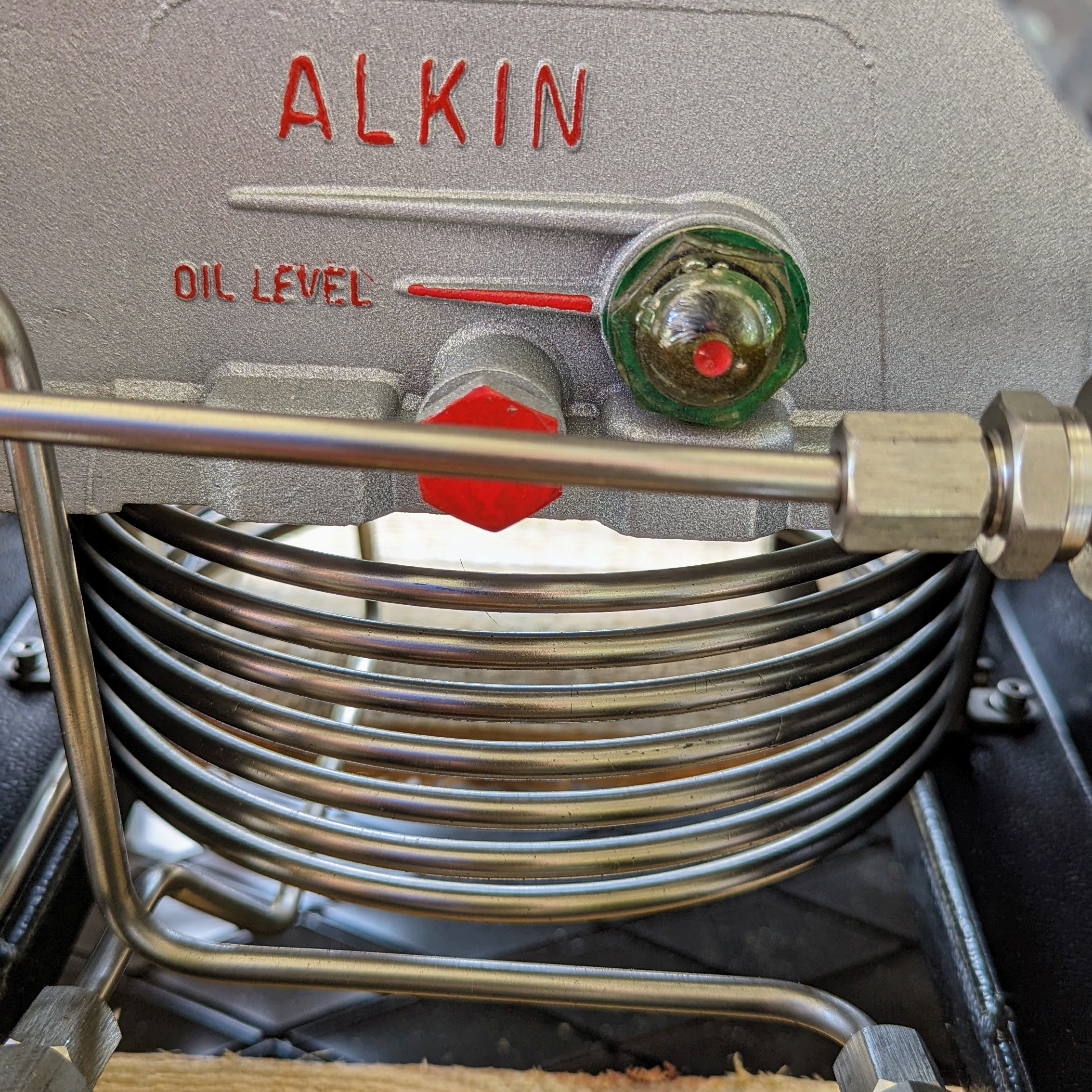

I got the Horizontal model W31 , How do you tell if you got the auto drain?View attachment 464914
That's a vertical, without auto drain. There are several features to identify the auto drain model, some of which are solenoid valves (electronic 'blocks') where you have manual valves on the left-front of the compressor.

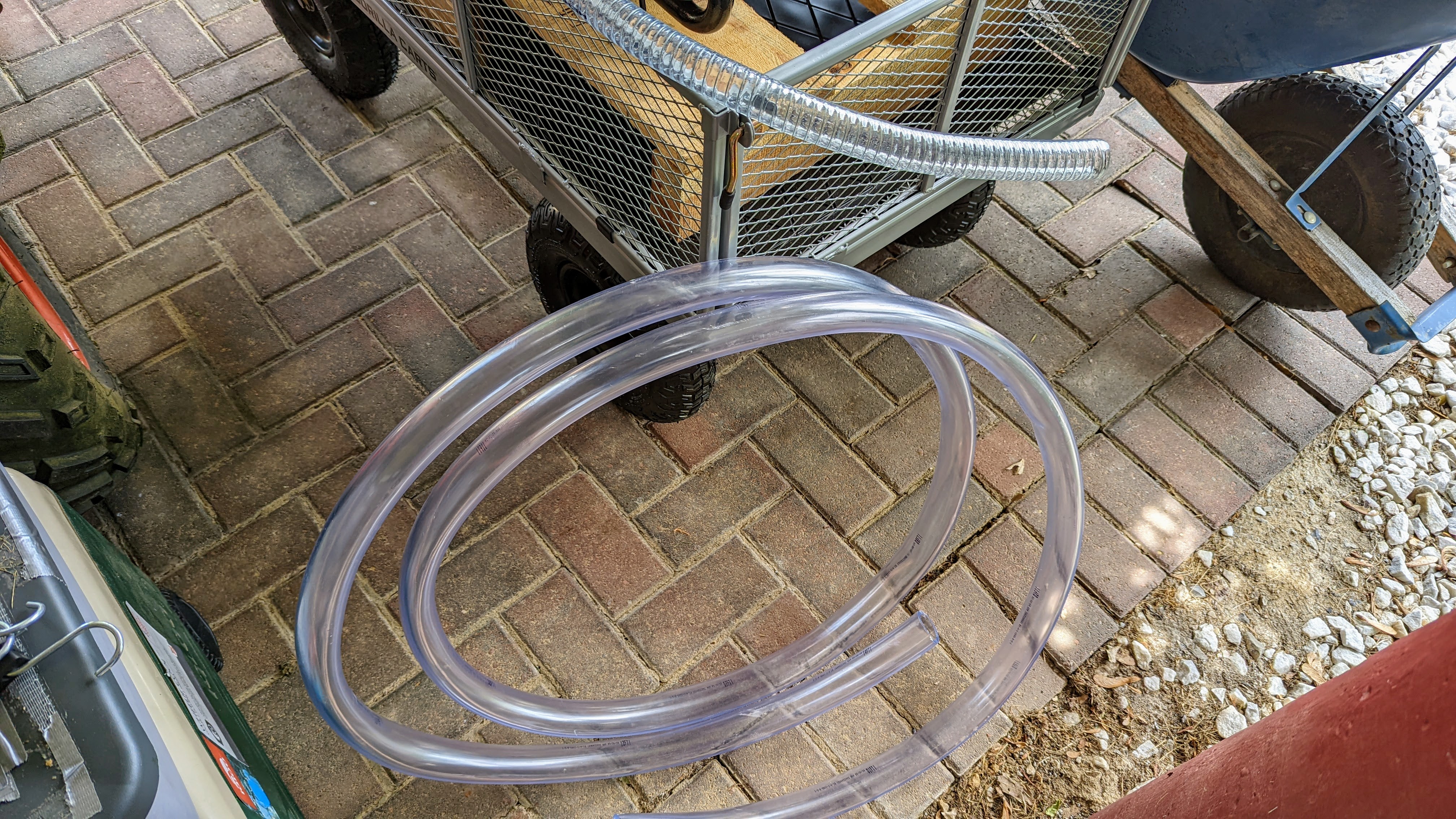

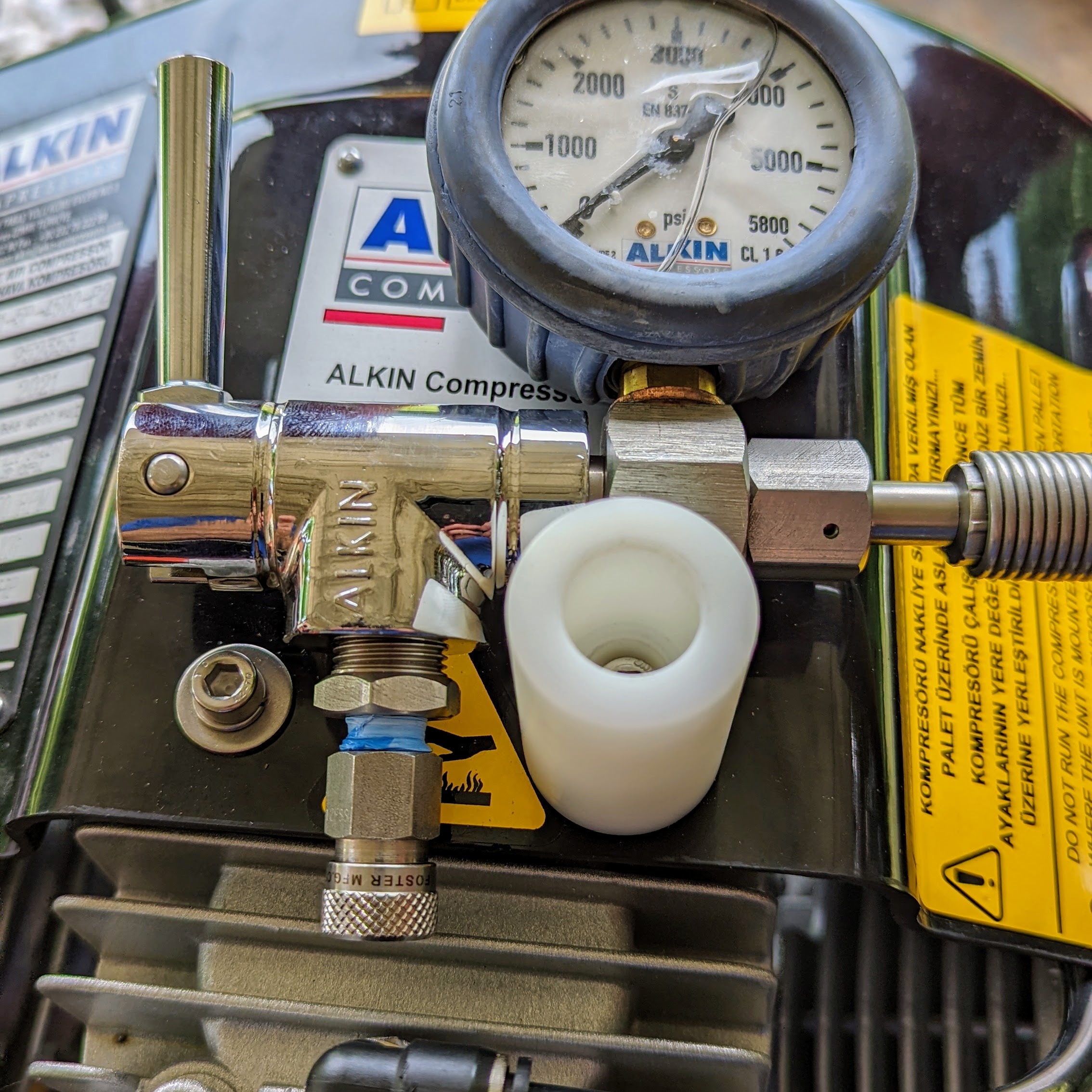

Yes mine came with a valve to drain the oil, Also a tube so you can get the oil out farther, I see the oil on the site is a little expensive but not as expensive as the Mobil one jet oil I had to use in the Shelden, The jet oil was like 35 to 40 a QT ,, Just glad I don't own a JET,,
Mike
MikeView attachment 466530View attachment 466531
That’s a nice addition to make oil changes simpler.
