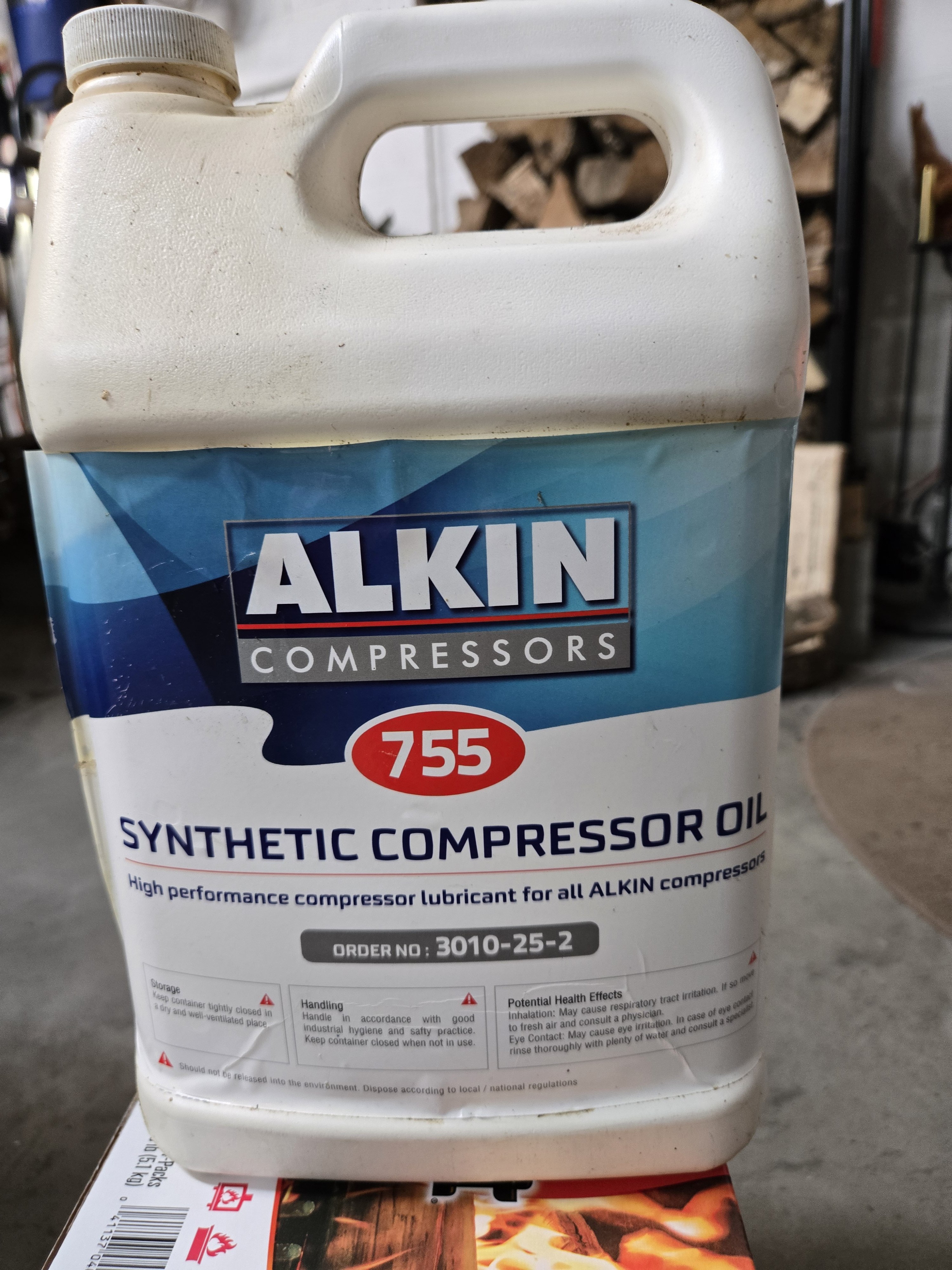

Here is a pic of my older jug, nothing on the back. Doesn't really say much unfortunately.
Reactions: RAMJET66

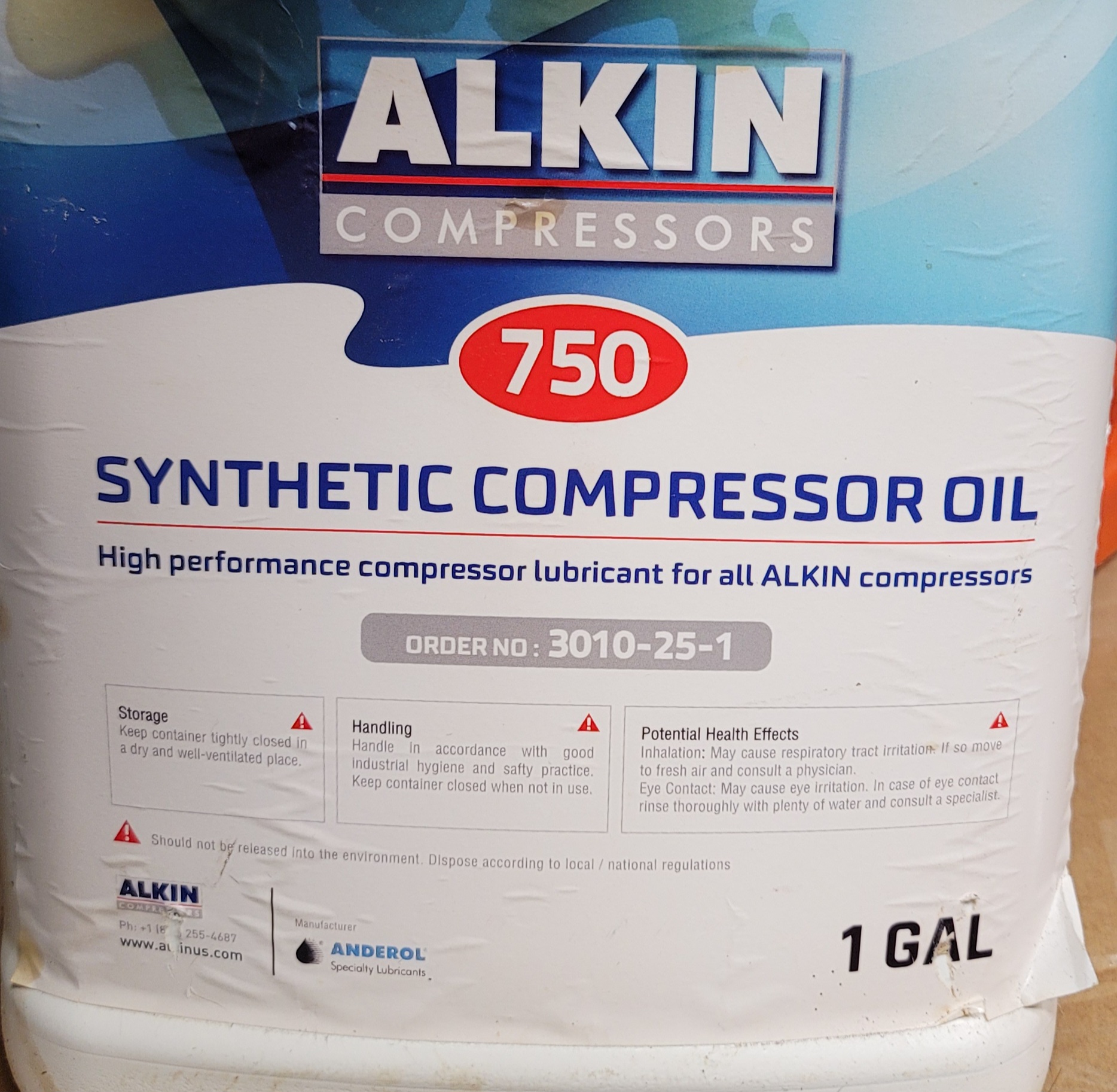

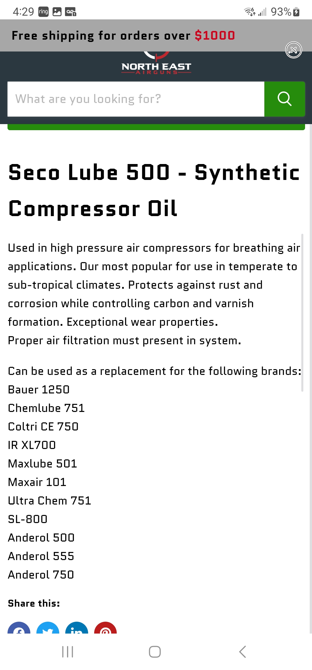

Alkin 755 oil is Anderol 755 rebranded. It can be seen on the photo at the bottom of the container. Bauer, Coltri, and Alkin all sell oil that they buy from oil manufacturers. Filtertechs sells Secolube 800 which is the same as Anderol 755. I've been using Secolube 500 which is equivalent to Anderol 750.
Alkin W31's hold 550ml or 19.35 oz. of oil. A gallon of oil should provide 6.7 oil changes. Alkin's W31 users manual recommends Anderol 755 or 750. Secolube 500 is Filtertechs equivalent of Anderol 750. The difference in the two oils is one is a triester and the other is a diester. I don't live in the tropics nor do I run my compressor as often as a business does so I'm comfortable using the less expensive oil.
