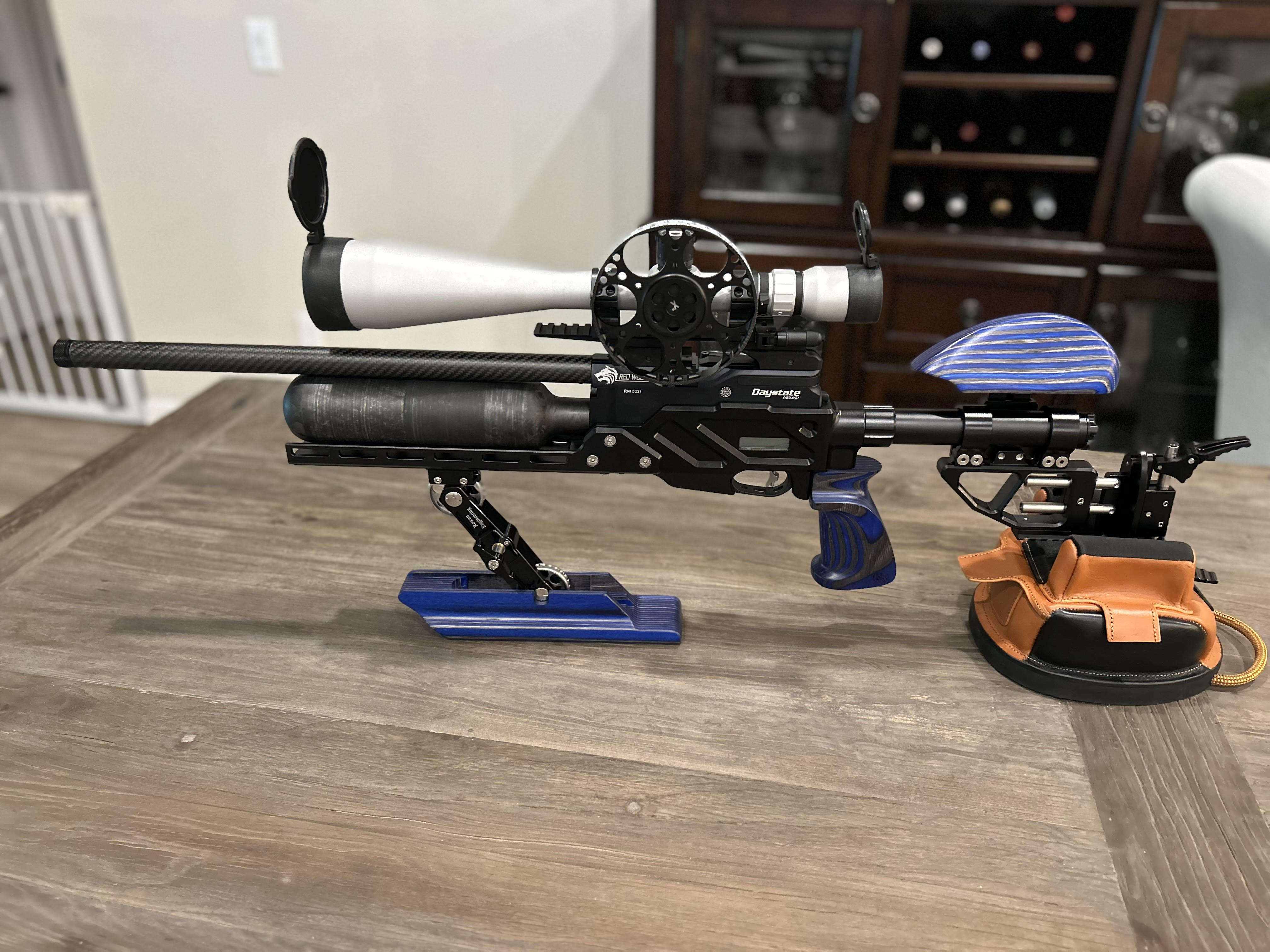

Hey buddy! Although heavier, I wouldn't trade my PRS chassis for nothing!! Although I haven't done this yet myself, like Moterhead suggested, we really need to play with the weight distribution to get things more comfortable. Although they are heavy, you will find with the correct weight distribution, the gun will actually not fill as heavy as it actually weighs. I can almost guarantee our guns are way front heavy of the balance point. If you play golf, its the same concept as club head weight.
I should have got you to go to New York with me this weekend. Heading out in the morning for the GP up there.
Keith

I’ve been thinking about a smaller air cylinder up front as the Redwolf is so good with air when tuned correctly. Meanwhile Wish I was heading north - it’s frog weather here…glad I’m an old navy diver!

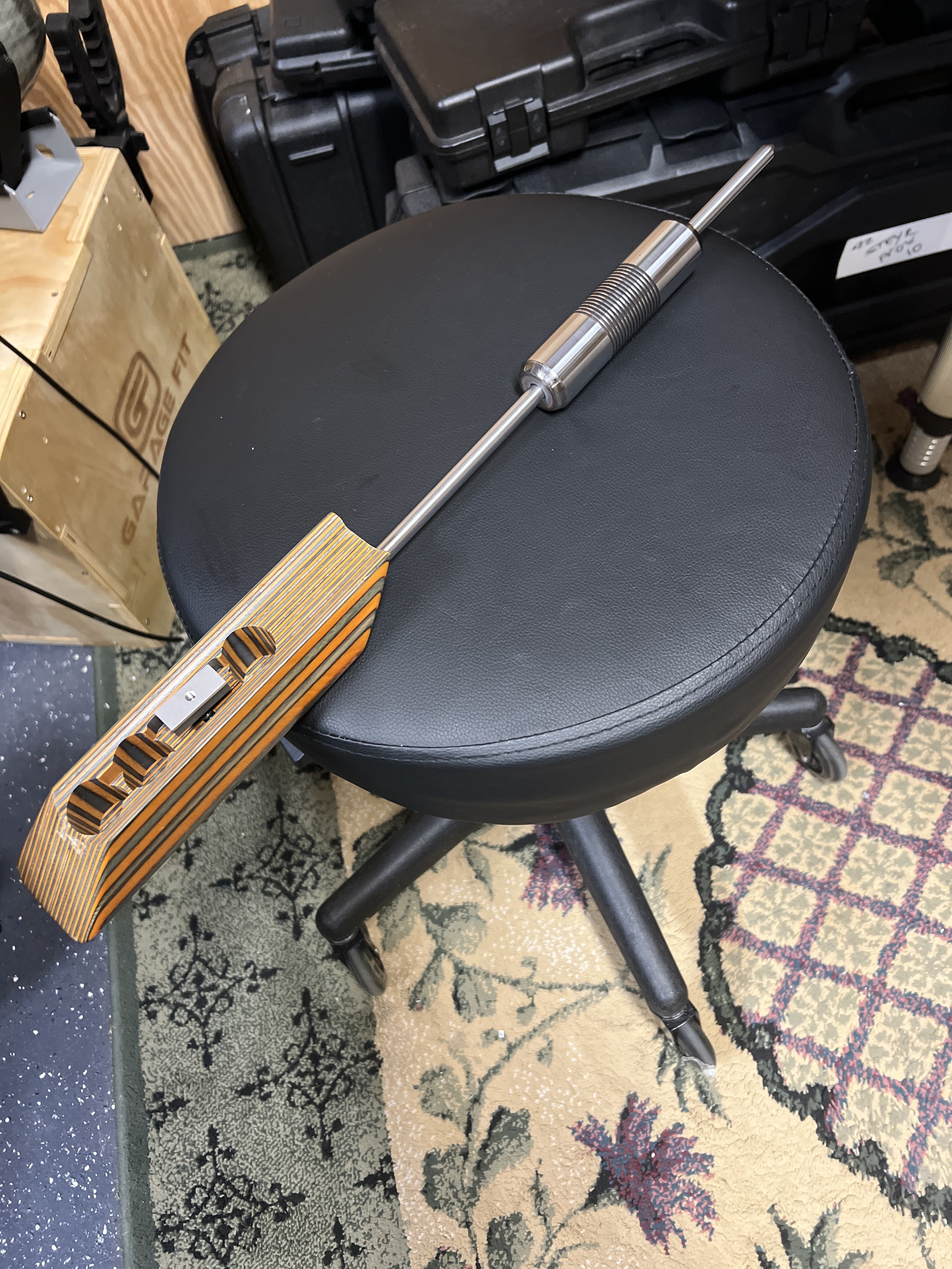

My Allen Z Steyr came with this gizmo
