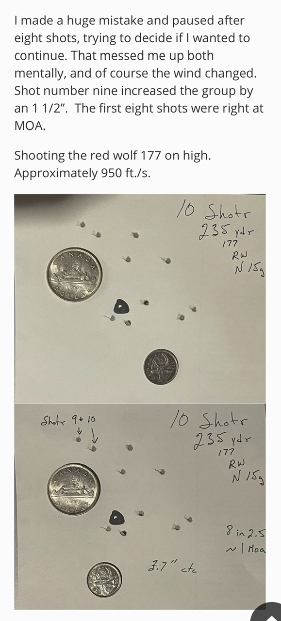

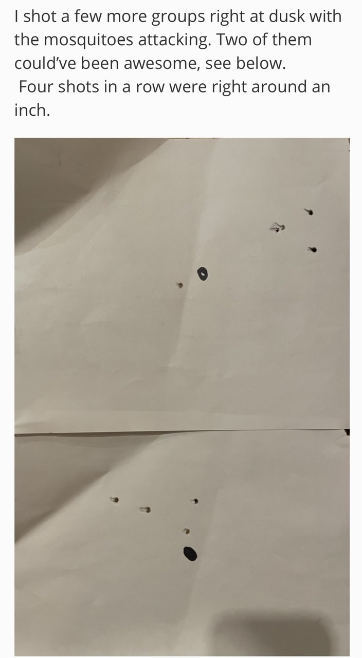

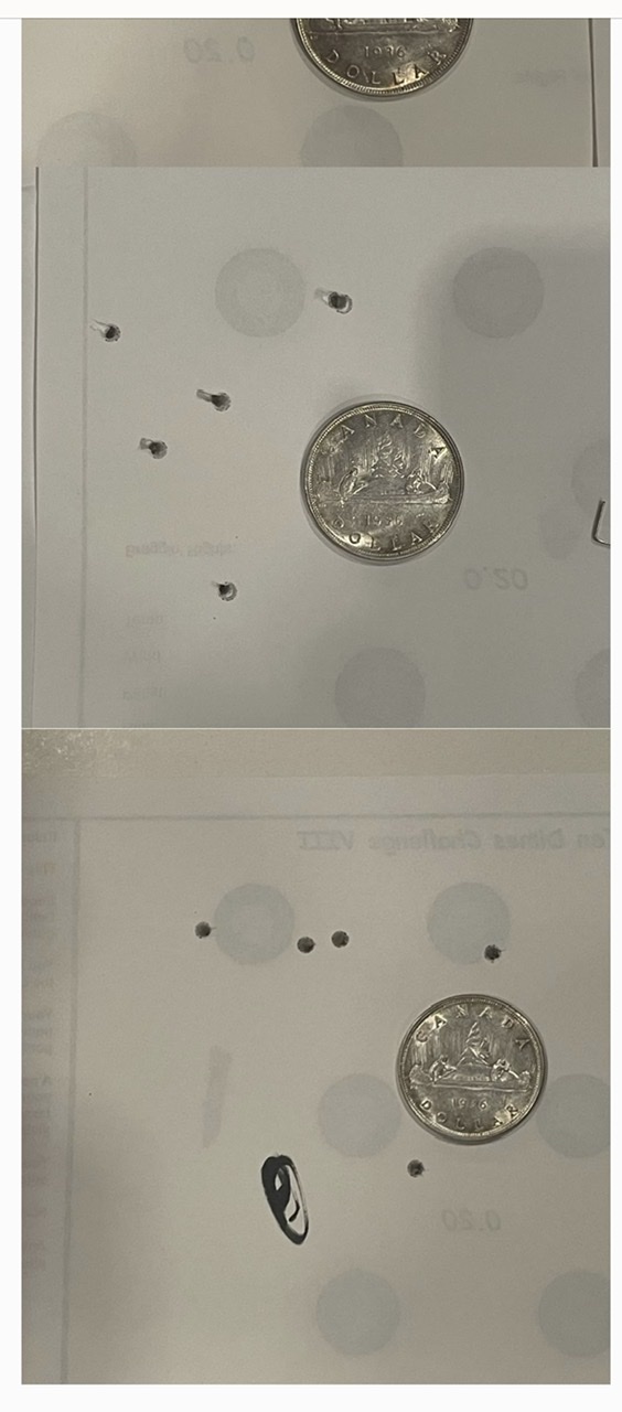

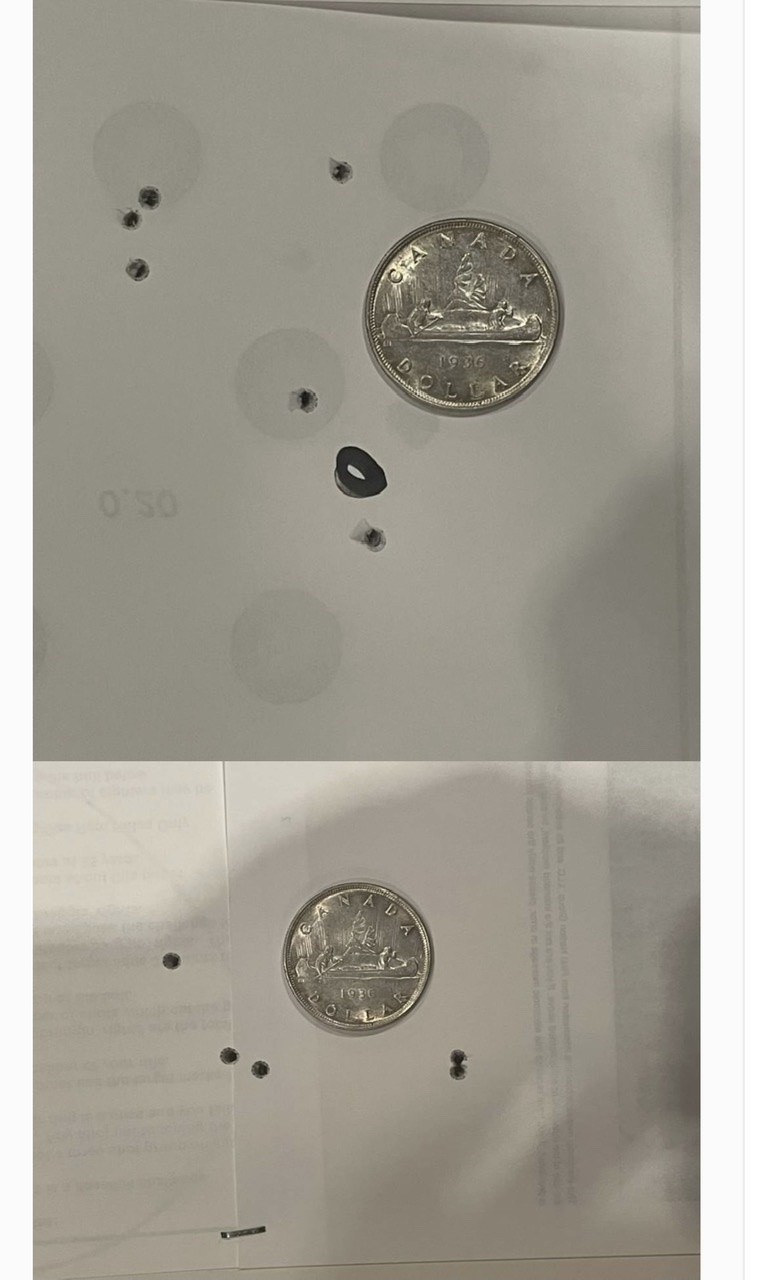

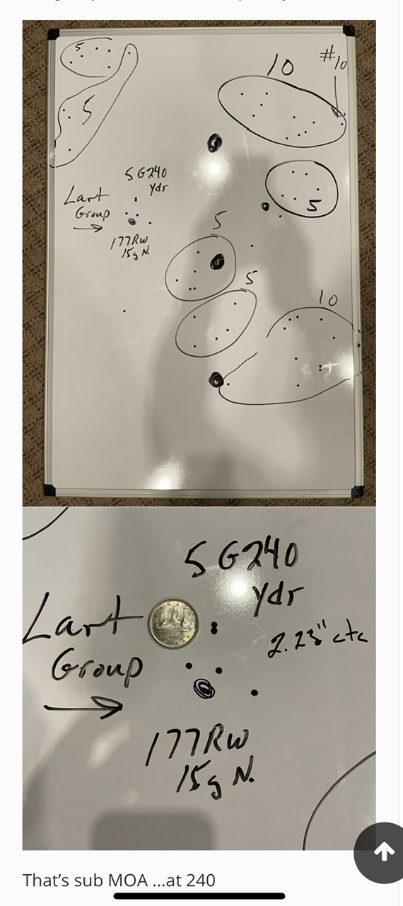

I had a chance early this summer to shoot the red wolf and various other rifles at 235 and 240 yards. Experience some absolutely fantastic conditions a couple nights right at dusk. Below are the resulting targets. They are either five or 10 shot targets. If you think it’s hard to keep that last, fifth shot snuggled in your group at 100…
I was shooting my red wolf 177 on high power, with NSA 15 grain slugs 🐌. Scope is a beautiful March, recoil is almost nonexistent. It sounds like a young girl farting when it goes off. The trigger on this rifle is the best I’ve ever had on any rifle. It was tuned for Airgun an Nation, for a giveaway.
Enjoy the pictures of the groups, I promise you I enjoyed shooting them. They were plenty of mosquitoes around back then, and I’m sure I ate a few of them with my jaw hanging open in disbelief.
