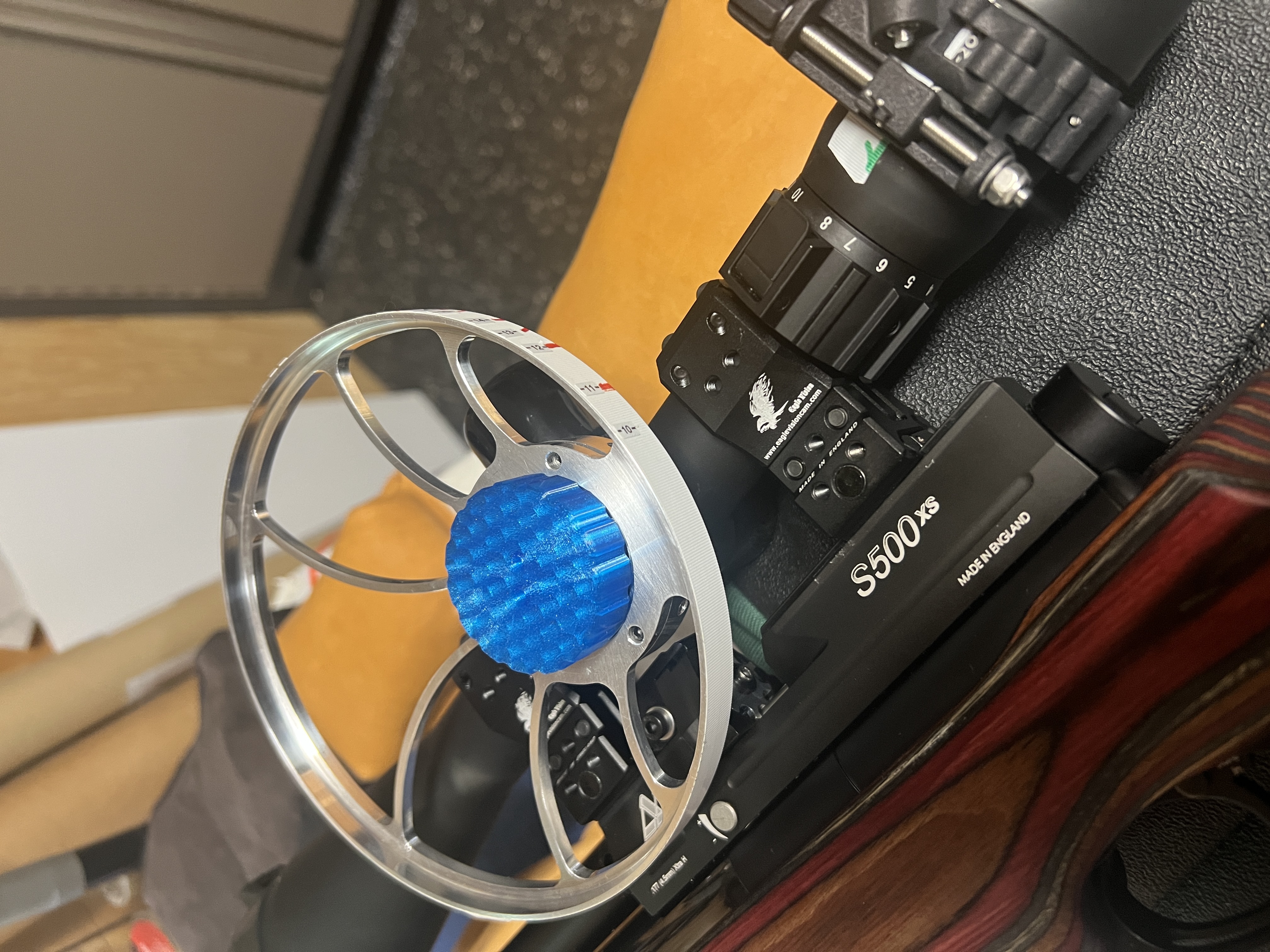

The picture posted shows my TM1000 HFT pistoli with a Scope-Werks 5"nautilus wheel. Note pistol only needs to range from 10-35 yards for pistol HFT. Eric makes a 3D thingamajig to turn the IR feature on and off pic #2.
notice i am using a Maestro occular dual pin indicator for my S-tac.
