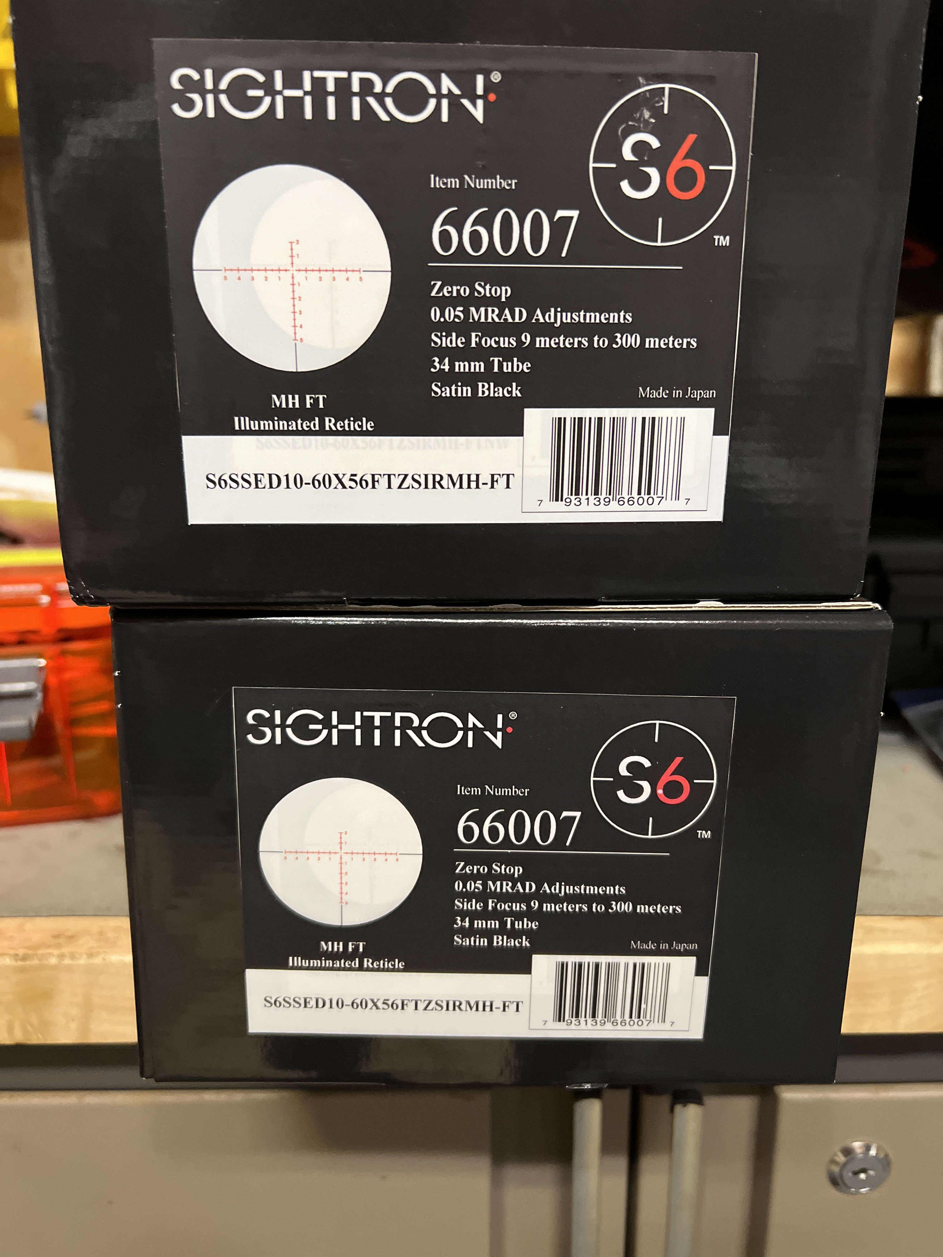

I believe the key limitation is 16 x. As I own the new S6 it’s amazing to 35 yards then blahzay but turn it to 30X and I can differentiate by the 1/2 yards to 65 yards easily… that said it’s 16X In HFT so blahzay
Hey, I’m curious about the focus adjustment, how is the yardage spread in the 35-55yd range compared to the S3? They’re touting a big difference but I’m wondering how significant it is? Thx
It is significant see the pictures I posted but remember to truly utilize the ranging resolution effectively you need a higher magnification level than 16X

Update - Sightrons S6 for HFT specific use aka the S6. I’ve used it for several Hunter Field Target matches now, thinking I would replace my Sightron S3’s or Athlons on my field target guns.
Please remember this is a very general usage and field of view and ranging comparison against the dark painted Baton Rouge field target faceplates placed in open lanes and the brighter yellow painted faceplates in the woodlands or Boerne TX and my various colors of faceplates at home in black barrels - if I had a scope cam I’d film this but I don’t.
Initial findings were at 16X, the S6 FT specific scope is impeccable it brightness and target acquisition from 9.5 to 35 yards; unbeatable! BUT after 35 yards at 16X it is a bitc’n pain like all the other scopes I’ve bought and used to range find with.
Some uniformed conjecture to follow:
Apparently the extra cam? Inside the scopes parallax feature creates extra sensitivity in focal point parallax adjustments which creates greater sensitivity at higher magnification thus I can separate ā€œinchesā€, yes INCHES, at 65 yards at max magnification, but this same feature makes it crazy sensitive at lower magnification and (I) blow right past the clarity crispy focus point…. I’m not an optician or scope reviewer, just an end user with 68 year old eyes.
Real world Data from 12 matches: regardless of gun, My previous KZ scores were seldom better than 42%. But I could / would average 30% in the forced lanes using Sightrons S3’s, Athlons Heras SPR 6-24x56 or S-Tacs 4-20x50 scopes; provided I turned down magnification for forced lanes to 10x or less.
This is noteworthy =!
With the S6 I scored 66% to 77% or greater overall for three consecutive matches. But apparently the added weight of the S6 wreaks havoc on my forced lanes; Specifically, in the last 4 matches I have hit zero positional shots or 8X4=32 missed KZ’s because of weight or a weight distribution issue but to be fair I have NOT reduced magnification in the forced lanes while using the S6 ā€œyetā€ because I love the clarity as my KZ’s wobble about- stubborn fool perhaps?
Prior to yesterday’s match, i spoke with a WFTF shooter who also owns the new Sightron S6, he was teaching / coaching me on the somewhat peculiar and specific way to use the S6 more accurately. Which I haven’t had time to try ā€œyetā€. I’ll be trying his methods today? on home turf to see what I think; it Will be interesting, but all said and done…. Is the issue of missed kz’s in forced lanes a weight or magnification issue?
Maybe the S6 will work or maybe I’ll decide the S3’s are equally good/bad for HFT or maybe I’ll shift back to the Athlon Heras SPR 6-24x56 ??? Dunno šŸ¤·ā€ā™‚ļø but it is a hobby and I’m having a lot of fun spending time with it.

But, what do you think about Sightron S6 FT ? I compared it side by side with my S3, much clearer and brighter, so far it's working well for me...
I’ve spent two weeks now going back and forth between my new S6 and the two older S3’s, I score KZ’s just as well with the older ones as the newer one @80% average.
But I’ve also shifted to 13.4 weight pellets and lost enough belly fat to get my elbows on my knees when shooting, so……
As far as ranging goes, the S6 is superior 10-35 yards with zero errors and unbelievable clarity.
The S3’s are not as bright but still very very good. Yet it’s still a struggle 40 yards out.

Quick update - the S6 ended up on my HP .177 Redwolf in PRS Chassis because, well, the combo is perfect for Bench Rest.

I have both the s6 doesn’t snap into focus like the Falcon too much play in s6 optic quality wise no different only thing I wish the falcons reticle was thicker , i bought the s6 and the hype my bad a like the Falcon better.
