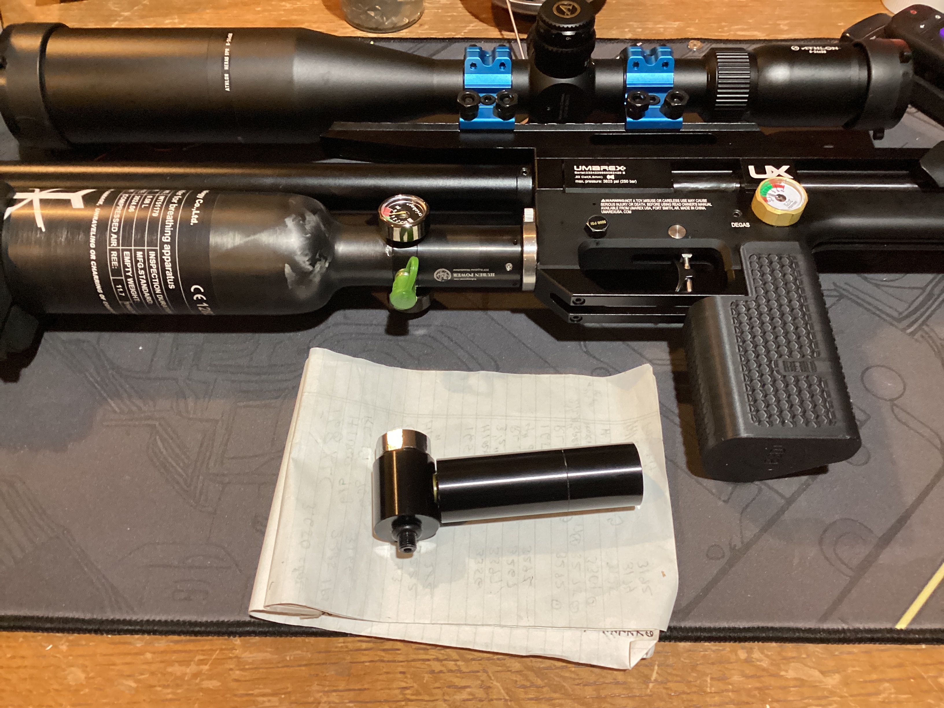

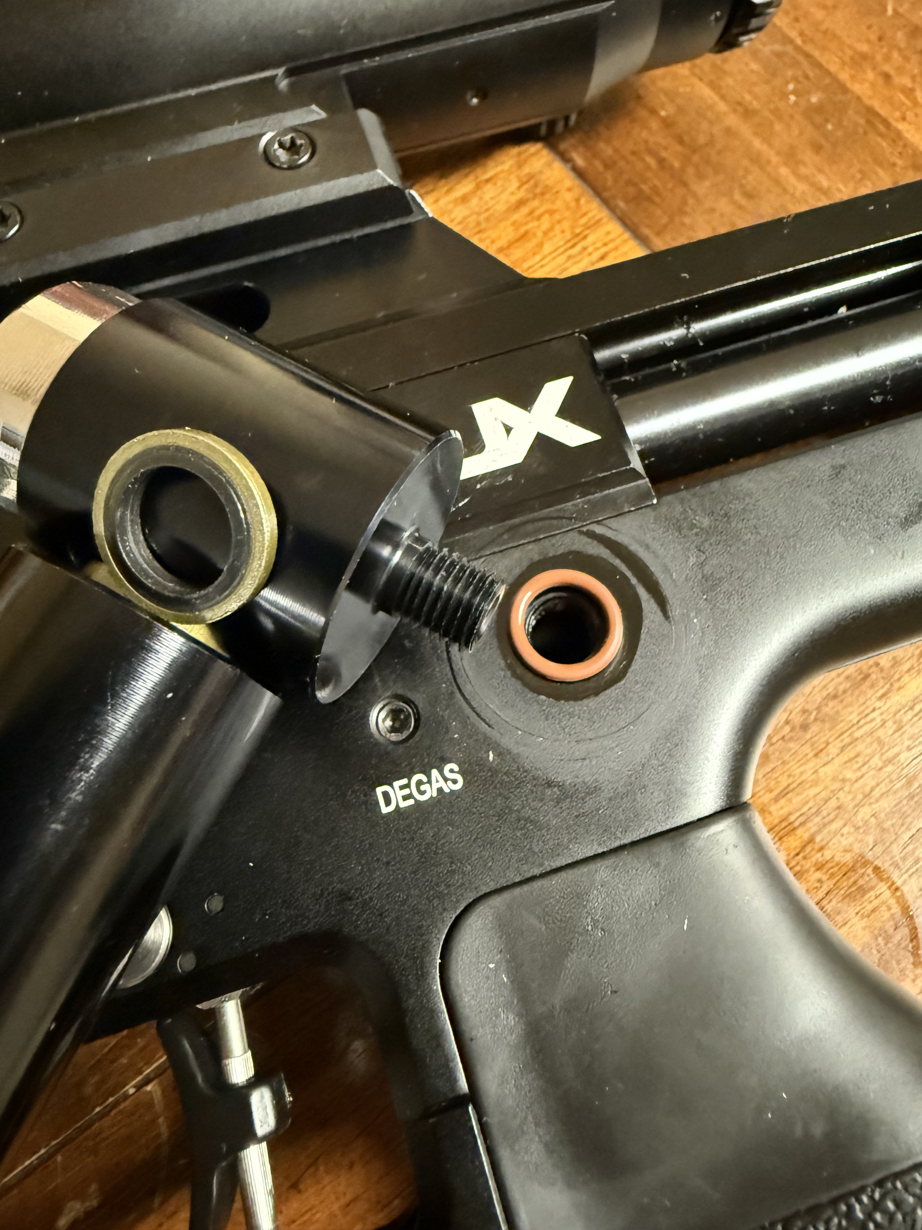

I forgot to lower my reg before pumping so I took off the tank to find I tore a o ring. I have spares from the hand pump kit but the umarex does not include spare o rings. Does it have to be exact size? The one I have is slightly thicker with a smaller inside diameter, I'm going to try and find a replacement at the hardware store. Is there kits I can buy? Also am I only able to fill the tank off of the gun to a certain psi? It started leaking out the non fill end around 2k psi and I lost all my air. Haven't tried pumping it up again. Doesn't help I got the gun today in the mail and it's freezing cold, maybe that weakened the seals?

First off, this is a known problem with the SPA M60 and Zelos, both bottled versions as well as tube versions.
The issue at hand is the 70 durometer orings used are too soft for continual bottle/tube removal under pressure.
I do have o-rings on thier way that I will be testing when they arrive but they may not be user-replaceable without a witches hat.
These are made from urethane and are 100 durometer so they are very stiff and hard.
This may allow constant removal but they may also chip, evaluation is needed.

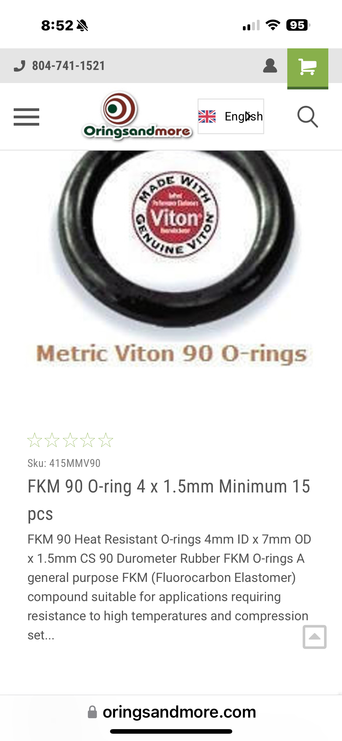

I suggest looking for 90 durometer Viton orings locally if available. I do not have the ID or CS on hand, I'm on a job currently.
