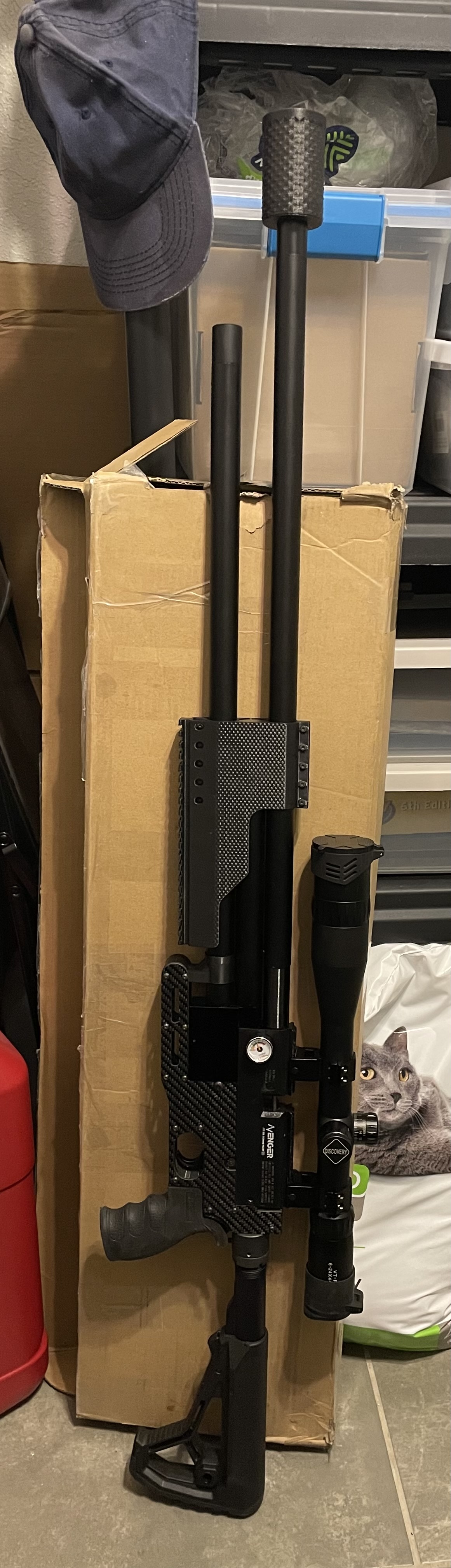

I have an Avenger in .177 I haven’t shot in a while. I had an idea a while back to rebarrel it with something that can shoot heavier ammo. The gun can make so much power and it all gets wasted since the factory barrel can only stabilize nothing heavier than 10 grains.
Well, it has a 700mm FX heavy liner on it now. I haven’t really shot it yet since I have been making parts to make the barrel mounting stiffer. It’s almost ready.
That should be able to shoot 16 grain Zans ( and other ) very nice, but it will probably not be super cool with the 3 heavier weights 20 - 22 - 24 grain
for that you would need the new 1:16 liner, that Viking airgunner seem to have good luck with at least in regard to 20 grainers.
I like shooting 10 grain slugs, i do so even out to 120 yards, but 13 and 16 are more precise in my Epic Two rifle.
10 grain make little mice almost split in 2, rats drop like a stone, and i have even dropped a pheasant at 50 Yards like a stone too, its 2 friends a few feet from it did not even notice it, they just wandered off into the tall grass a few minutes later.
At 120 Yards, a couple or 3 16 grain zans landing pretty much in the same place, will make a hole in a stainless steel kitchen sink
