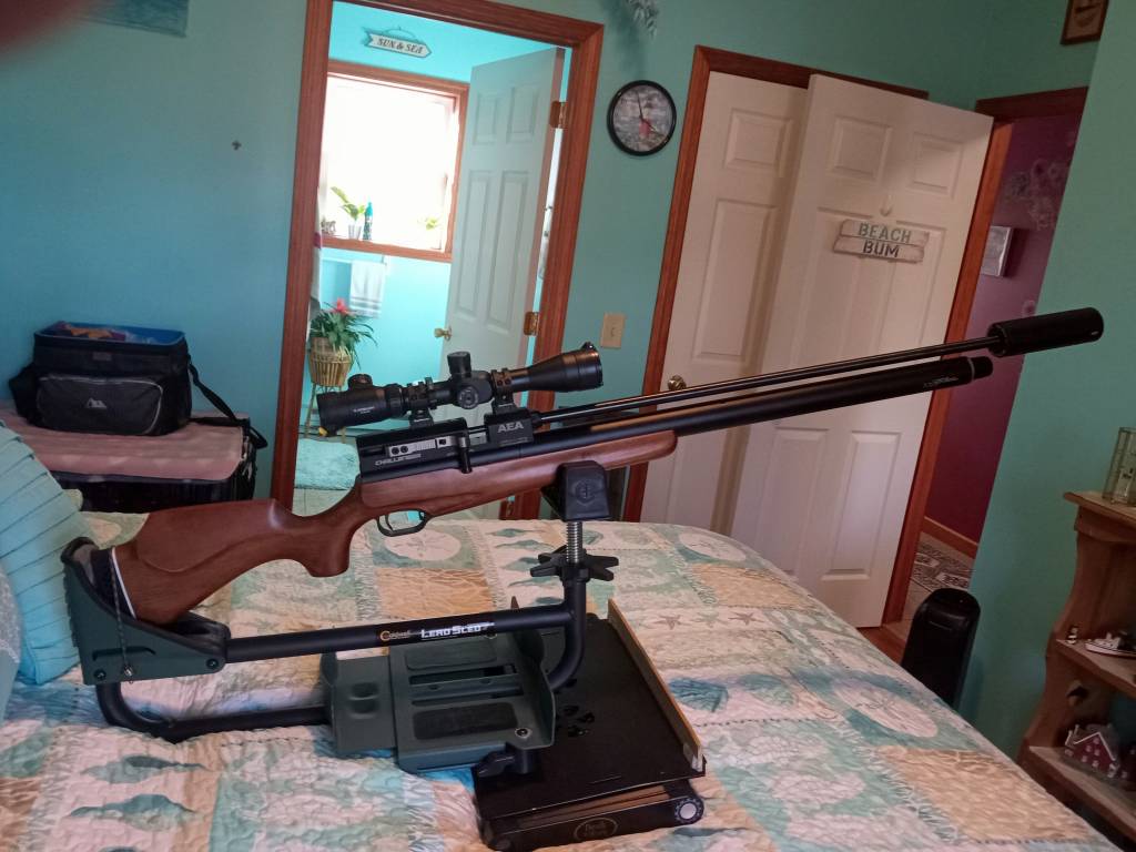

I have a Challenger 357 SL (probably one of the first 5 or 10 sold in USA) and a HP SS 30+
Haven't had a problem with either one that wasn't user error and easily resolved. AEA customer support through Pete at AEA Northeast is great. Bin has helped me out as well. The quality of support & service is a big reason I'm comfortable buying these Chinese guns, if anything goes wrong with them down the road.
The Challenger is a beast and my most powerful airgun at around 200-225 FPE depending what kind of ammo you put through it.
The HP SS 30+ is WAY more accurate than you would think with that short barrel and amazingly gets 4 full magazines (36 shots) with pretty consistent power before you need to give it some air. Rapid fire 50+ FPE, relatively compact with a folding stock, what's not to love?
AEA has a lot of options on their menu so do a little research first. For example the Challenger is a hunting gun with a heavy trigger. If you're trying to shoot perfect groups, consider the Challenger Pro (regulated) instead. In my mind, most AEA airguns are designed for hunting and/or self defense. It wouldn't be the first brand I consider for primarily bench shooting.
