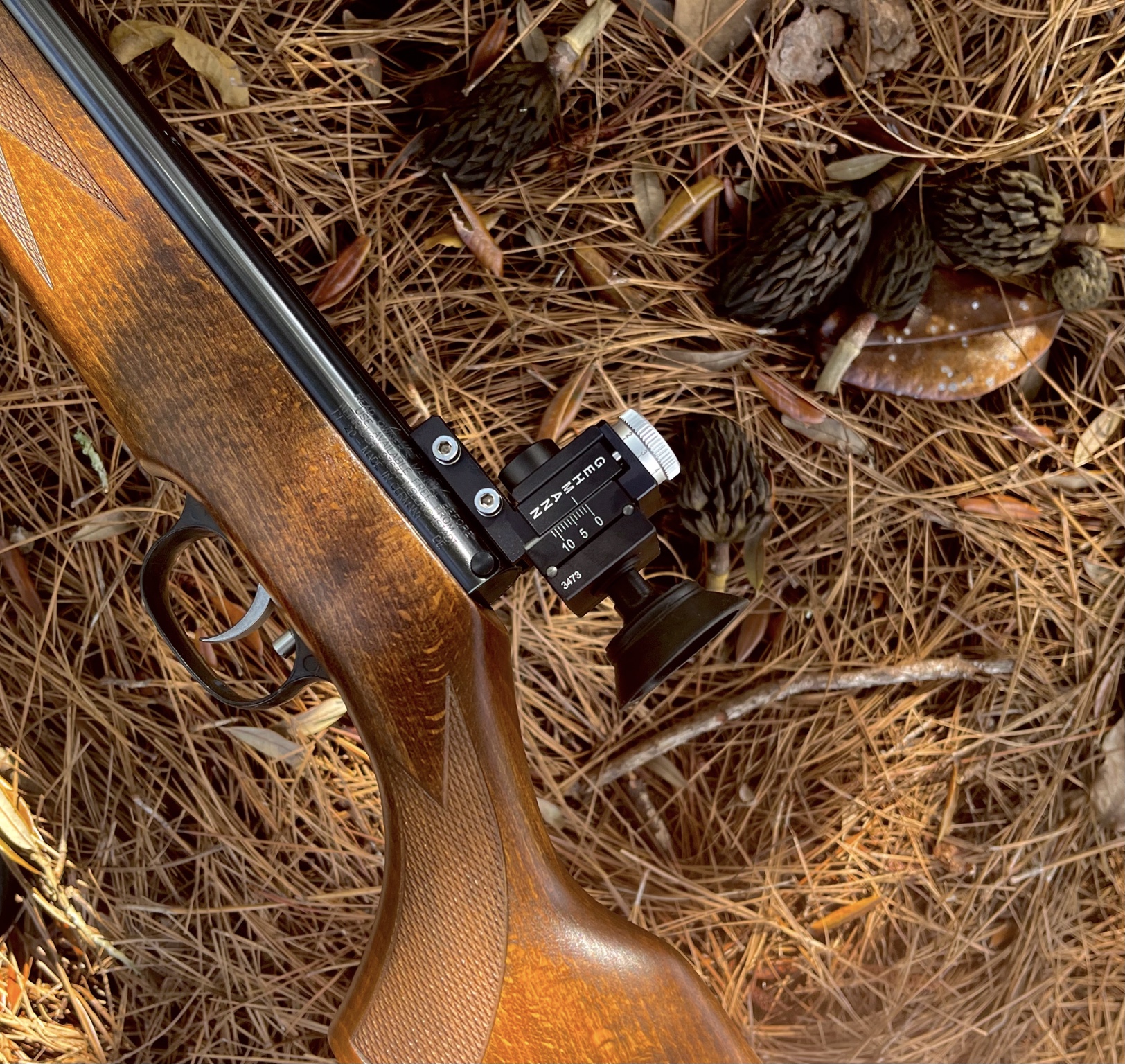

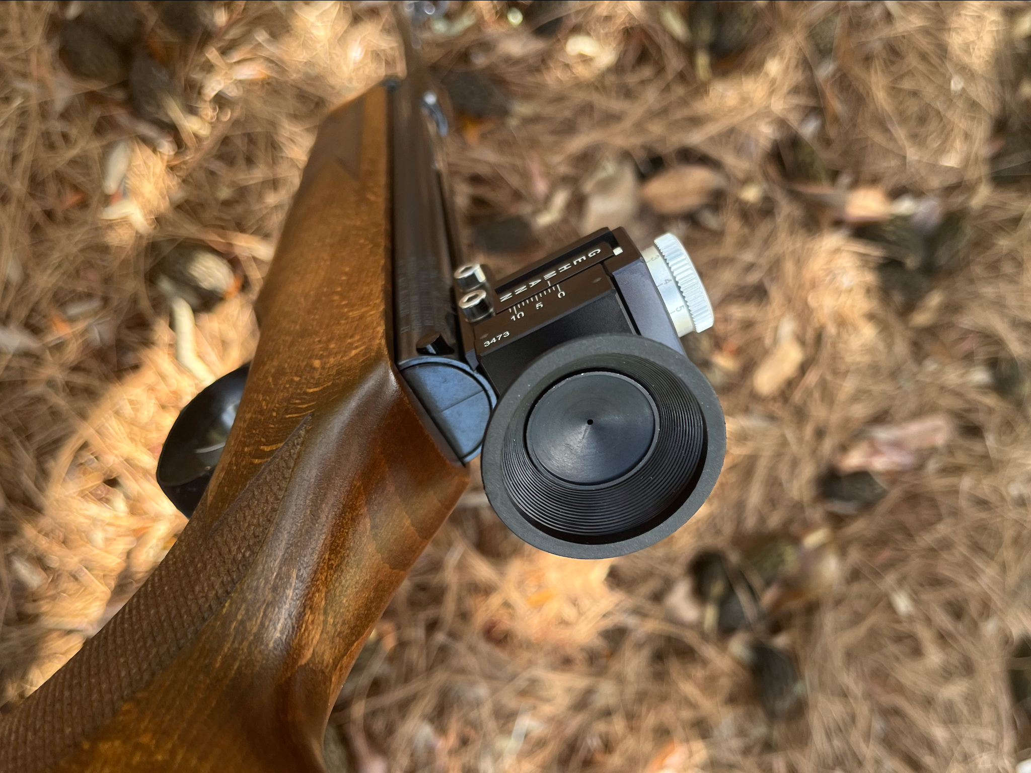

As stated above. This is a Weihrauch Diopter. And the stop is built into it. When you install it, remove the from stop (top round knob). With it totally removed, shine a light into the hole and get it perfectly centered over a hole in the receiver. Then install the stop carefully. It’s easy to mare the top of the receiver if you bring the stop down on the edge and try to tighten it in.
Thanks. I wasn’t prepared to clamp it down, wasn’t sure, makes sense what your saying. Crow

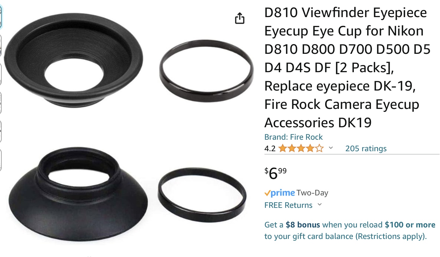

I like the factory sights on the HW 55T. Any idea where one can get a replacement rubber eye cup for those?
Mike
They show up on eBay now and then. Usually listed as a Walther eye shade/cup. The “dude” from Bulgaria lists them. Around $30.
I buy these Nikon eyecups on Amazon. They fit perfectly. $7 for two. This is a good brand. Some brands are rough.

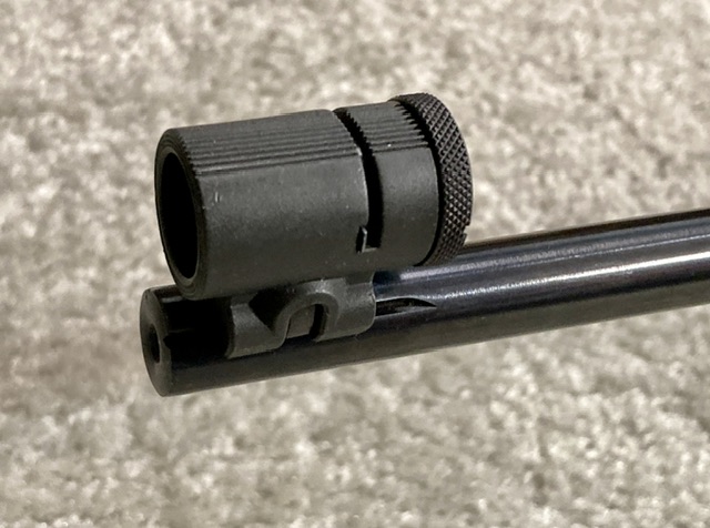

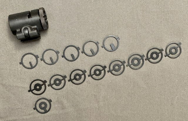

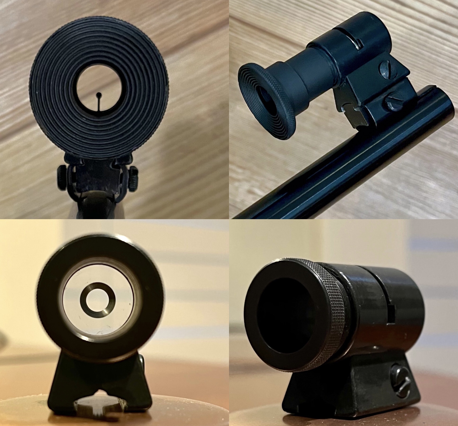

I can think of many different front sight options available today. I remember the days of getting my wife’s nail polish out and painting the front iron sight. Nowadays there’s, night sights, fiber optics, dots, etc. I like and have them all. But I still prefer the globe front sight with interchangeable inserts on my air rifles. Weihrauch still uses a good one and supplies several inserts with a new gun. However, with the new stock designs Weihrauch is making, that incorporates such a high comb (leaving the iron sights almost unusable) makes me wonder if their iron sights are on the endangered list. So my favorite sight is the globe, and my favorite insert is the “lollipop”. Followed by the “clear plastic”. Been shooting these for four decades now. I added this Walther anti-glare tunnel to my Weihrauch globe. It’s really nice as it reduces glare and allows a larger rear aperture for centering. These old eyes need every benefit they can get. Do you have a favorite front sight?View attachment 407417
top left then bottom left , actually i like top left but pointed like a tall thin triangle
Reactions: Bear-of-Grayling
Not too crazy about the post or lollipop. My favorite is that plastic insert, I use them for both bullseye shooting and plinking. For plinking I just center my target in that aperture, no problems at short to moderate ranges, I really don't have a location for long distance shooting but do not think it would be much of a problem there. I was first introduced to that type sight back about 1963 when I was on a ROTC small bore rifle team, and never looked back. Of course in those days it was steel with the crossbar to hold the aperture, An advantage of that is that it would help to notice any rifle canting. My FWB300s which I got back in the early 80's came with the plastic type and I quickly decided that I preferred it. Several of my rifles now have that type sight. I replaced the factory post on my FWB 124d with one with that accomadates interchangeable inserts so I could use one of those plastic inserts.

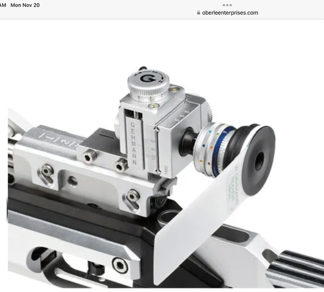

For what it's worth (not much LOL), modern top-level match shooters seldom use those any more. It's considered less fatiguing to the eye to NOT be looking through a big jet black hole.

Exactly. This is why I like this so much. Not looking into a tunnel but blocking glare. Looks good also. IMHO

And here's what your sight would look like outfitted for a high-level 10M match these days. No big rubber cup, but an adjustable iris (here with a colored filter module), a slightly enlarged dark rear face, and a blinder strip to allow shooting with both eyes open (dimensions of this limited by ISSF regs).
