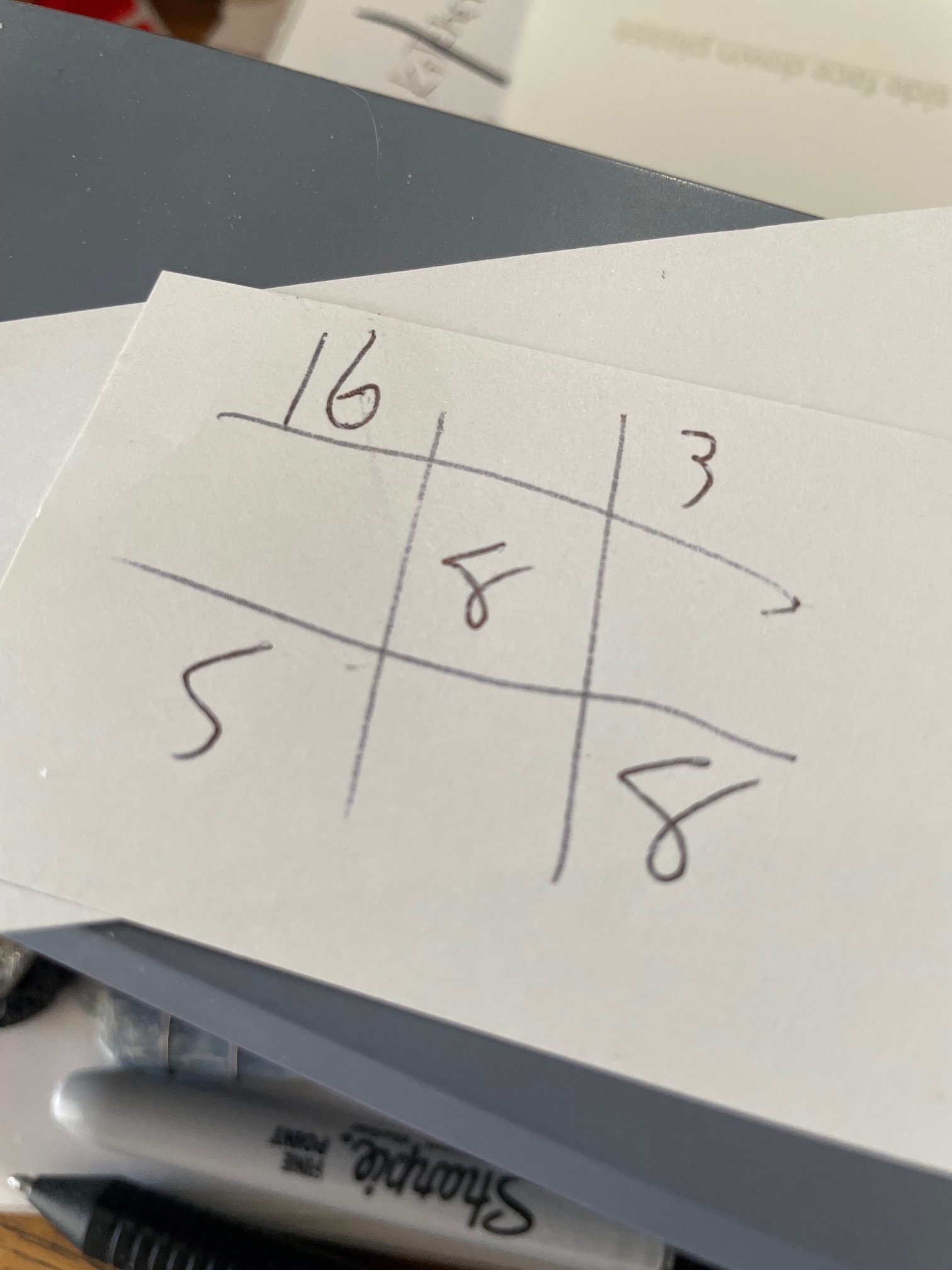

the 2 different leads mentioned a few posts ago with the Hardball that has a BHN of 16 and the pure lead that is a 5 BHN.
So first you need your finished BHN that you want in this case I used 8 BHN that is the middle number pictured below then
you have the 2 different leads the hardball is a 16 in the left corner and the pure lead at 5 thats in the bottom left corner
you just subtract the smaller number from the larger number this will give you the ratio of lead to use to achieve your
lead hardness that you want. Using this formula you get 3 parts Hardball lead to 8 parts of the pure
Reactions: Bandito
