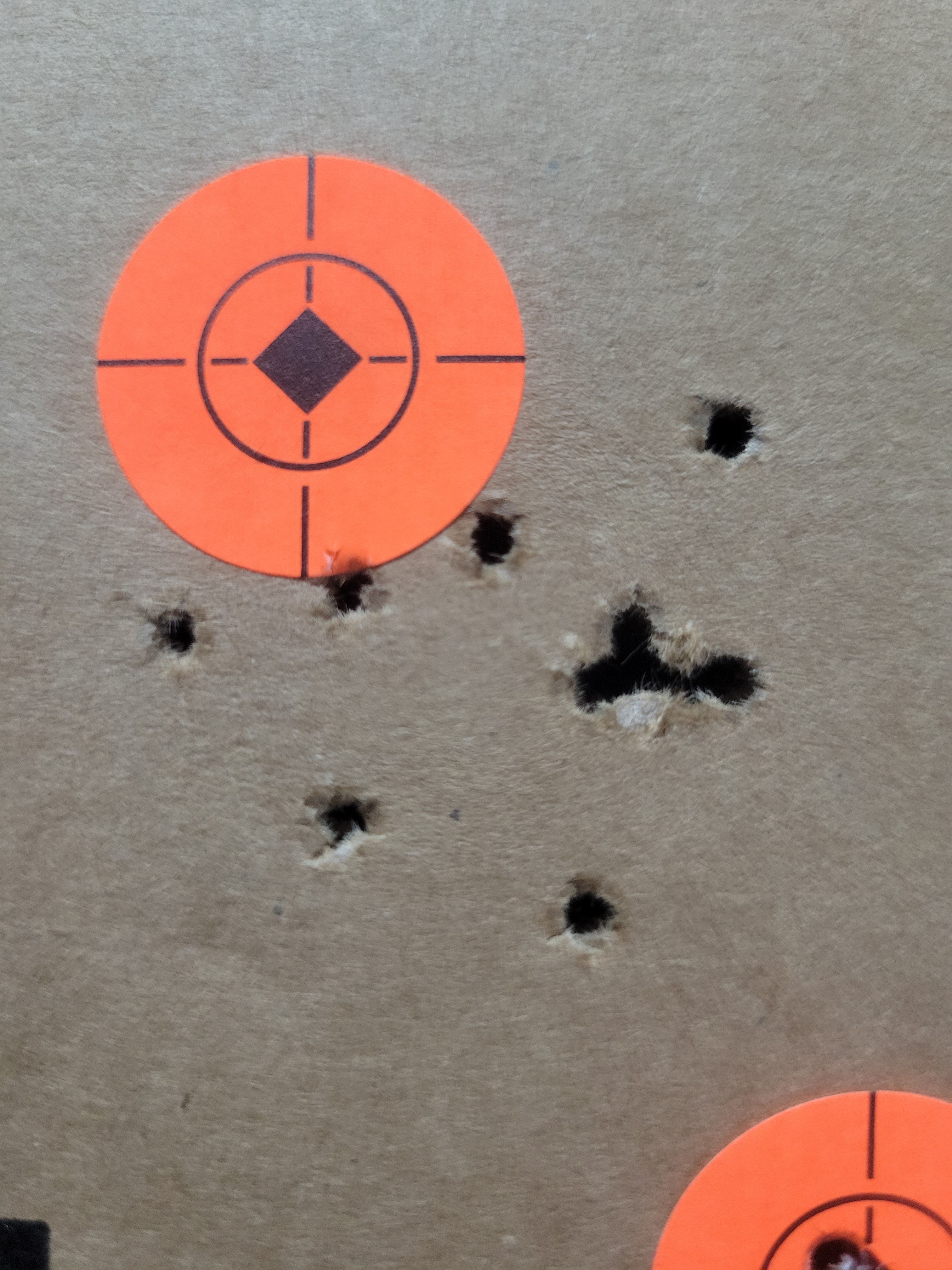

The bad: barrel was extremely dirty, one of the dirtiest I've seen. Accuracy is not good. Actually it's very bad so far with JSB 8.4gr and CPHP 7.9gr at 25yds I'm getting 2"+ groups. Scope is new so I will be throwing on a known good scope just to check but think it's the barrel. Or it's just that picky and need to try different pellets. I'm shooting at 800fps so not like it's throwing them crazy fast.
These were the JSBs. The weird part is it seemed like every other shot would be a flyer then others go in the clover leaf.

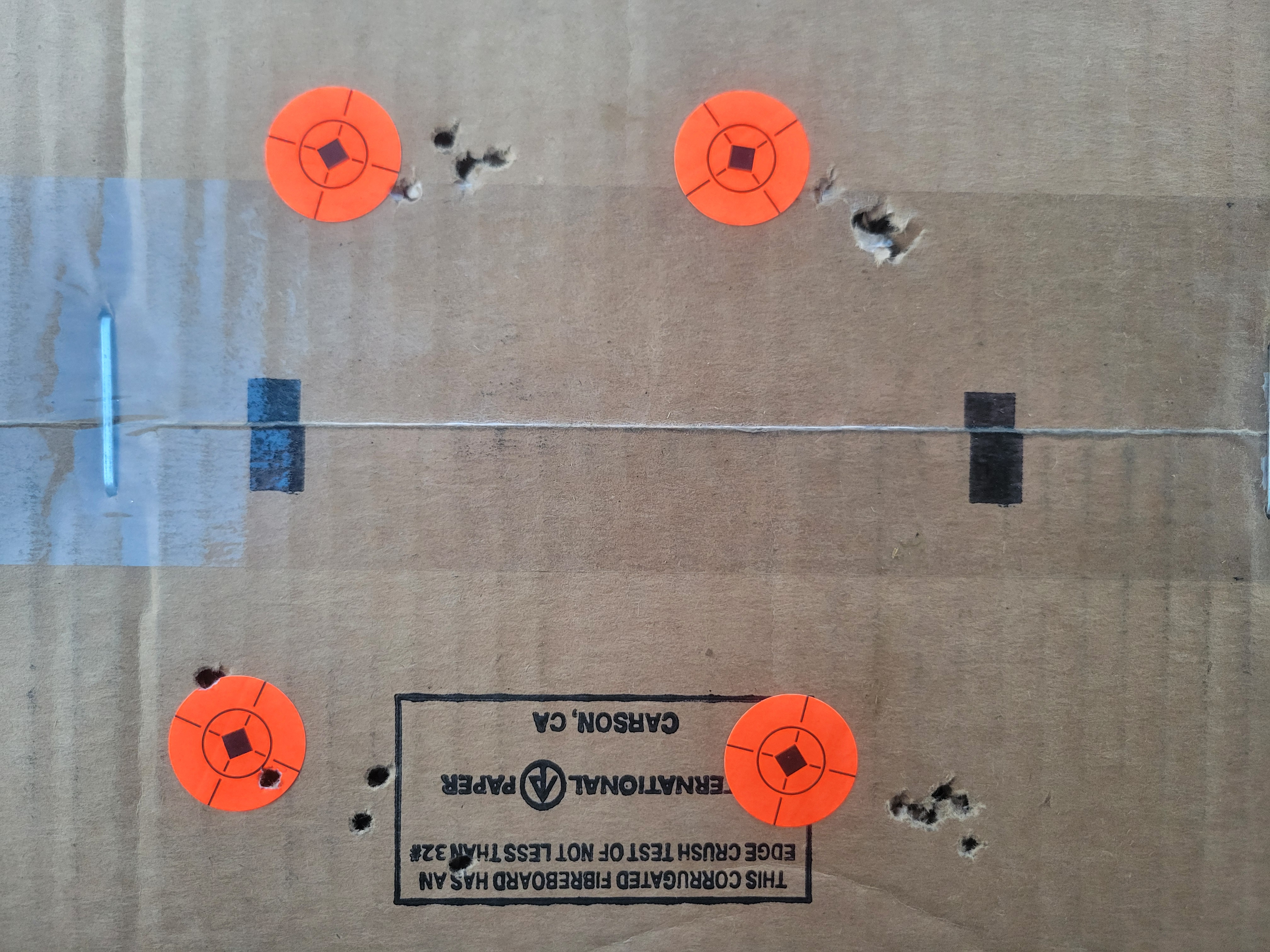

Anyone ever have a problem with the mags causing accuracy issues? I wanted to check them and it looks like they are getting skirts bent every time. I pushed some through the mag and noticed all my skirts got bent on both mags. I'm going to test some single loaded groups to see. I checked baffles lastnight, screws are all good. Crown looks good and no burrs on it. I guess I'd have to see if anything on the barrel port but how smooth everything feels I doubt it. I thought I found a tin of 10.4gr FX pellets but turns out the had 12.5gr NSAs in it??? So that was a bust. Haven't shot anything over 8gr in years as I haven't had a .177 PCP in years. I will probably order some 10gr pellets and maybe some of the new MK3 Knockouts. But want to test single loading first to see if that changes anything.
Shot some groups out of my truck on a bag so not perfect but I can do pretty good from this. Top 2 are 5 shots single loaded. Much better not amazing but likely just not it's preferred pellet. I can live with that. Bottom 2 from the mag first 5 shots were in the left. Terrible accuracy. Last 6 shots from the mag on the right. So I think the mags are too tight. But I can live with this the crazy flyers I was seeing yesterday I couldnt.
