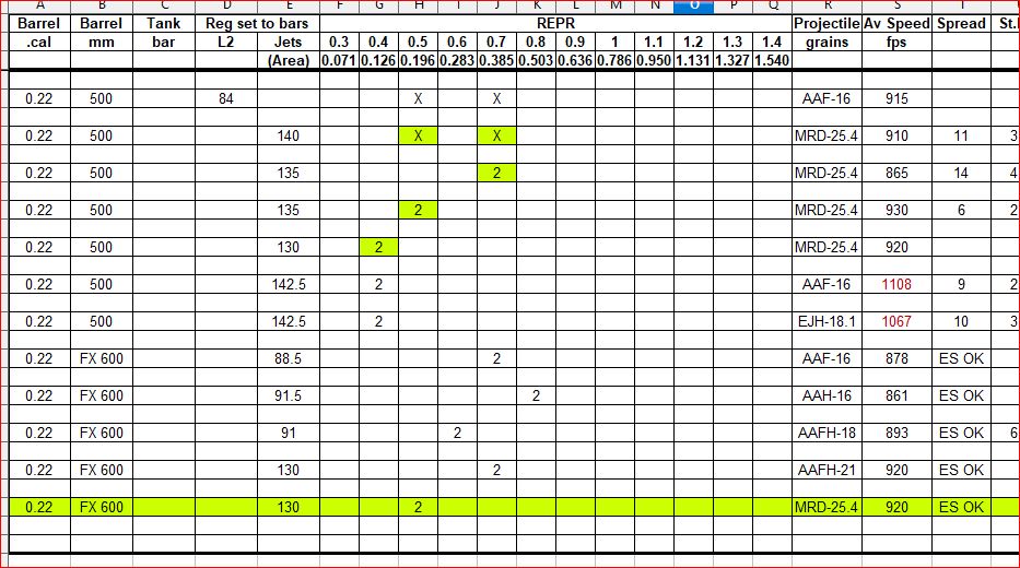

Anyone have a recommendation for power jet selection/raptor reg settings (250mm Alfa) for shooting .177 jsb green wadcutters, and also for .177 jsb beast 16.2gr and what type of speeds/shot count per x tank size? I ordered the dog bone and collar so I’ll make sure to have it in (originally purchased as a .30).
Considering making a site where people can post results for different combos. Don’t know when I’ll find the time though : /
Anyone have a recommendation for ....
I don;t think there is a shortcut for what you asking. Way too many variables to consider unless if you have a friend sitting just around a corner from your house and have spent a truckload of $ for a working solution.
You best get yourself a radar, a set of jets, a lot of air and one tin of each pellets you can get to your hands.
Start documenting in a spreadsheet like this ;)
  • Love
Reactions: Bernie7
Figured it was worth throwing it out there, maybe someone goes, ‘oh I got a perfect setup for my L2 in .177’
