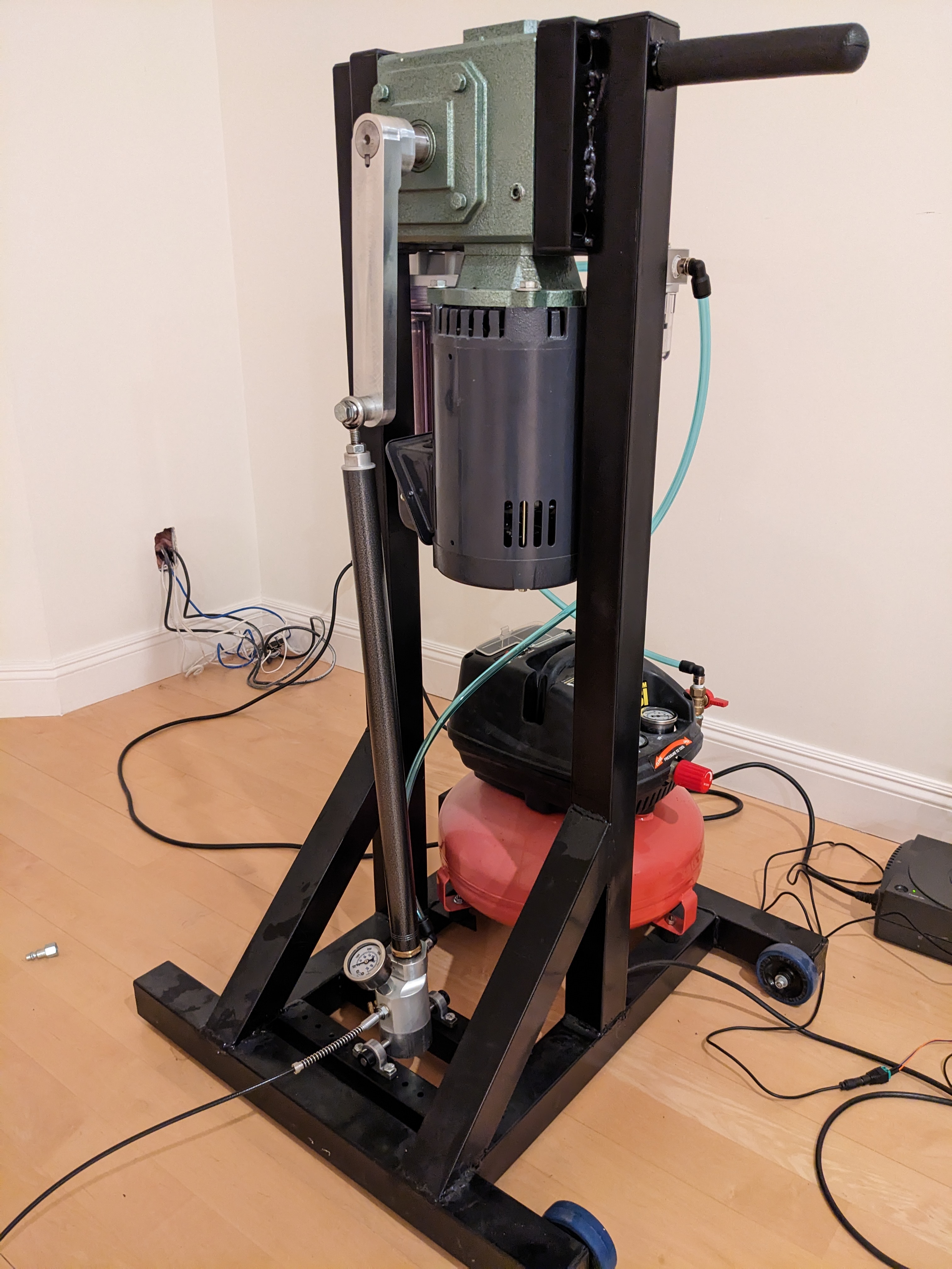

I even used it to fill my small Benjamin 90 cubic inch bottle. But that takes some babysitting. I'm planning to update the electronics to automate filling of even large tanks. Of course it would take a very long time but I won't have to sit and babysit it. For pumping times of less than 2 mins it can fill the equivalent of 20 liters of air at 1 ATM a minute at 300 bar. For sustained use needing cooling down time the fill rate is only about 1.8 liters per minute. The fill rate is faster at lower pressure because the pump doesn't heat up as much, so the on duty cycle is longer. Starting from an empty tank the fill rate is over 60 liters per minute slow down to only 20 liters per minute at 300 bar.
The Hill MK3 is a solid pump. I'm using to over 300 bar (4500 psi) over its rated maximum. I forgot to open the valve on my tank and it redlined blowing up the gauge, but no other damage to the pump. I'm still on the original o-rings. I stop pumping when it gets warm a let it cool down for 10 mins. At 300 bars that about 60 pumps.
Of course I started this long before they had decent low-cost compressors that work OK. I wouldn't recommend anybody build such a thing today.
