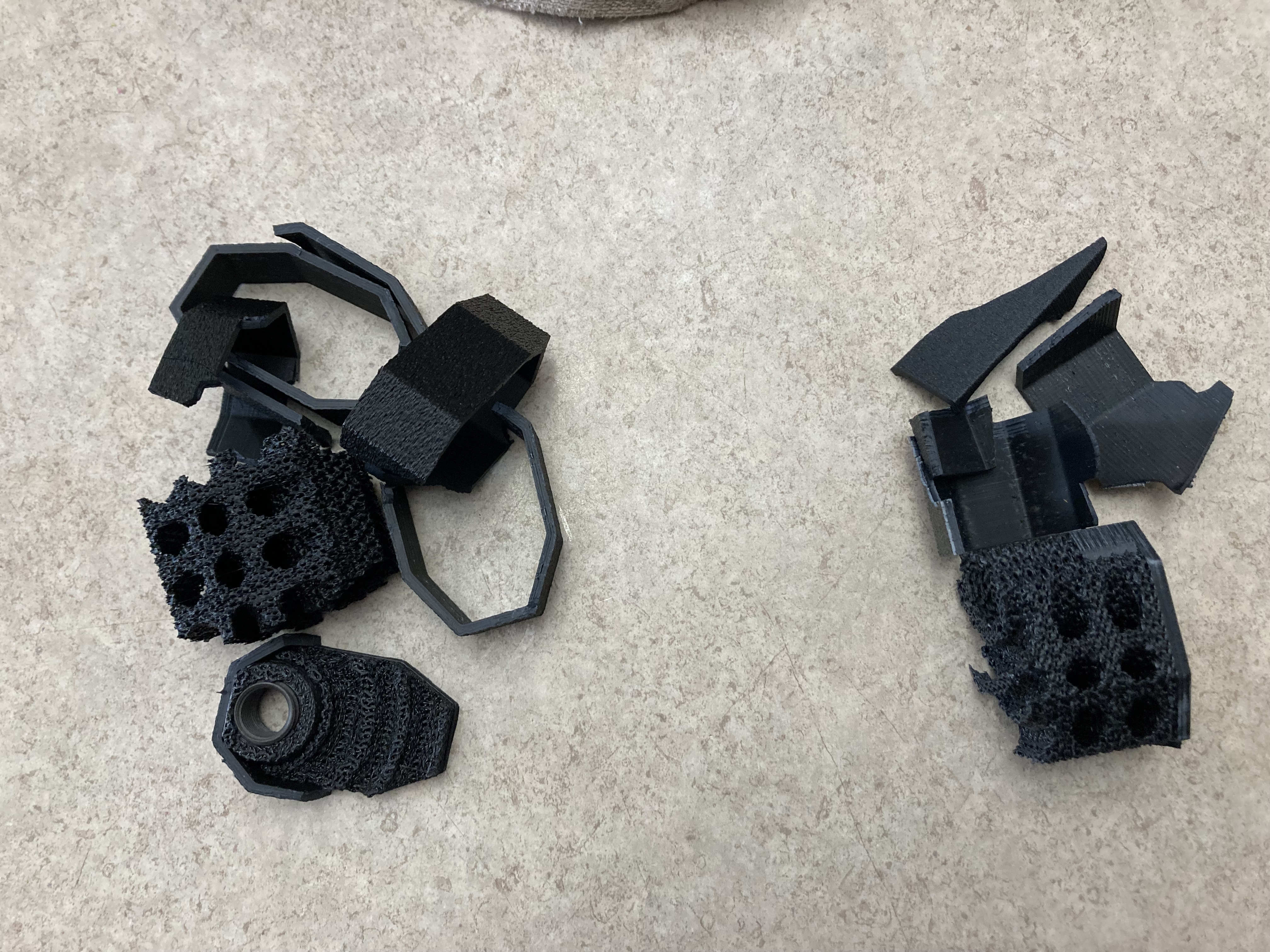

Just a friendly heads up to be very careful NOT to let the reservoir pressure get too low (below 150 bar) when using a 3D printed suppressor or other weaker types of materials. I blew up two in a row because of the GK1 attempting to dump all of the air when the reservoir pressure got too low. That probably caused some hearing damage… It appears my current design is strongest at the threaded insert portion, I need to offset the voids inside the suppressor below the bore line, and possibly decrease or eliminate the gap between the walls of the suppressor and the infill pattern.
What do you think @subscriber, should I try to strengthen the bond between the walls and the interior infill pattern or leave it as is so that if it does burst due to letting the reservoir pressure go too low, it may be less explosive?
Your post got me thinking. I’m almost certain it dumped all the air because you were shooting heavy ammo with a high power tune. Once you got to low pressure, shooting with heavy ammo will cause excessive back pressure causing the valves to dump all of the remaining air.

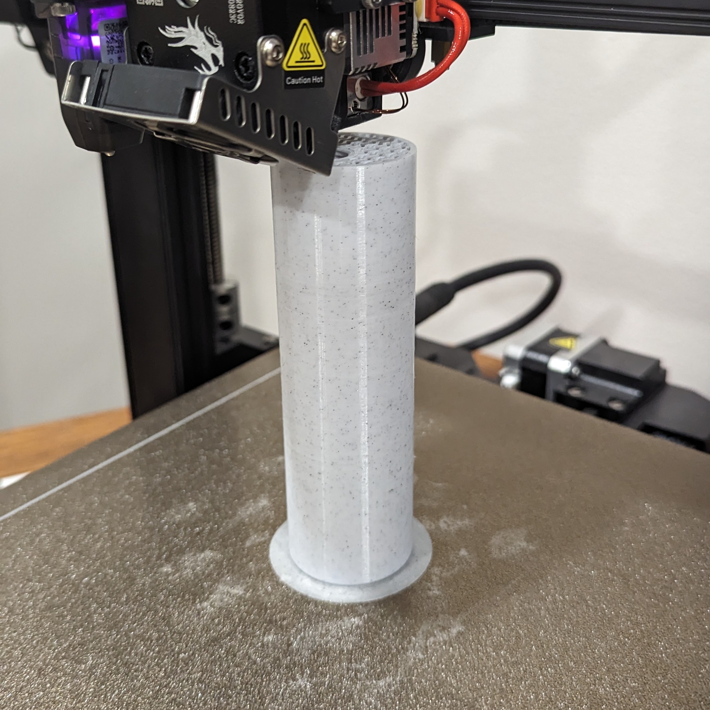

I'm making one more little tweak but works well with the dual magnets--could probably just get away with one...two pairs is a bit of overkill. Heh
@subscriber 's offset moderator is up next. Yup, white marble filament.
Nice job! Looking forward to your impressions about @subscribers mod and it’s performance. Will you be testing it throughout the power range?
Yeah, I'll run it up the range since it's 3d printed. Will probably turn it up to 850fps for the assorted mod testing. But will be going back down to my 750ish after.

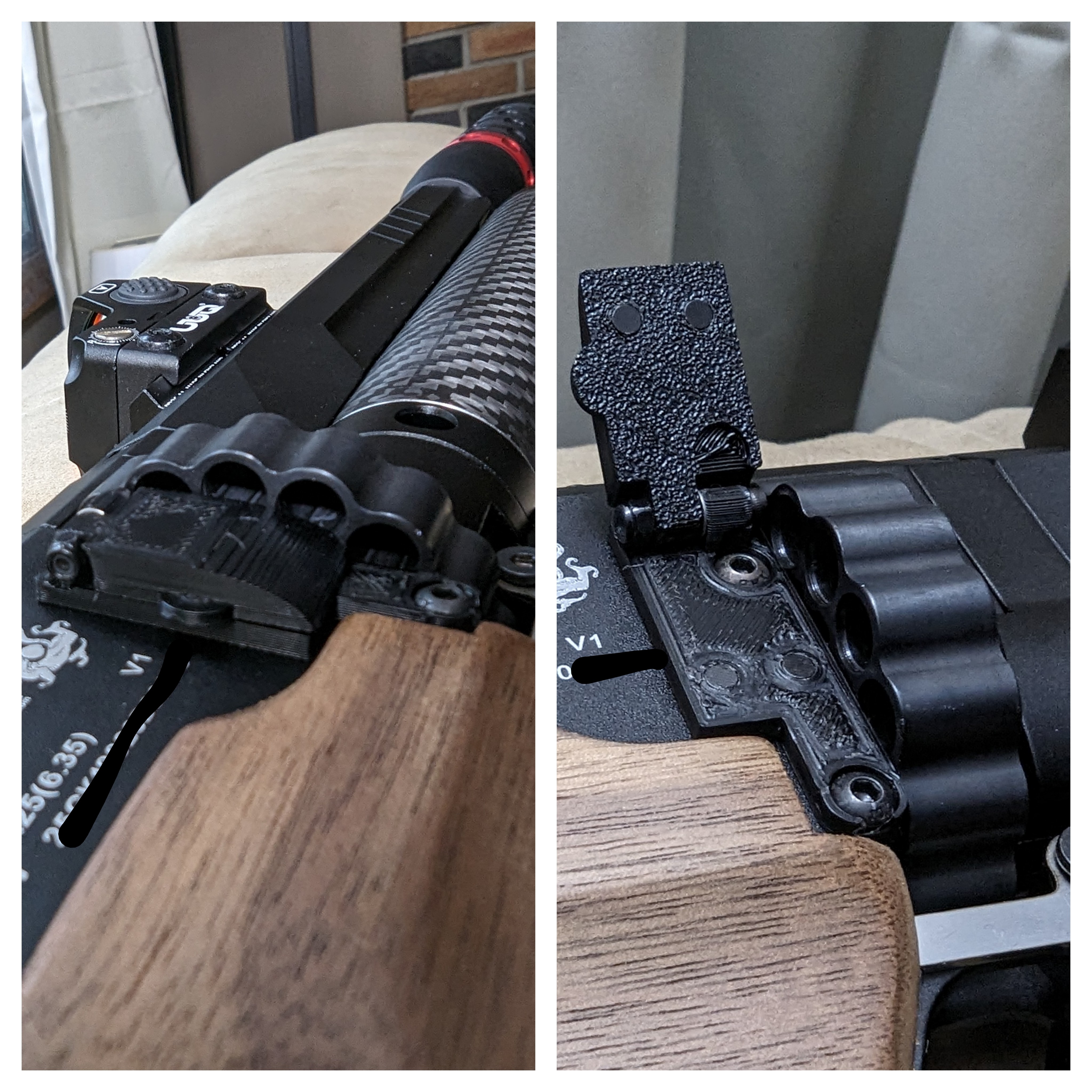

I have loading gates on my K1 rifles but I’m sticking with the stock gate on the pistol. I find I’m refilling air and pellets together after each mag and the air takes longer than the pellet loading with the stock gate. Plus, the blocky gates don’t look good on this beauty.
I was thinking of making a more stock-shaped version but magnetically retained. Top half would just separate to allow loading--just don't drop it! 😂 Want to also design a fill port plug that can double as a pellet seater

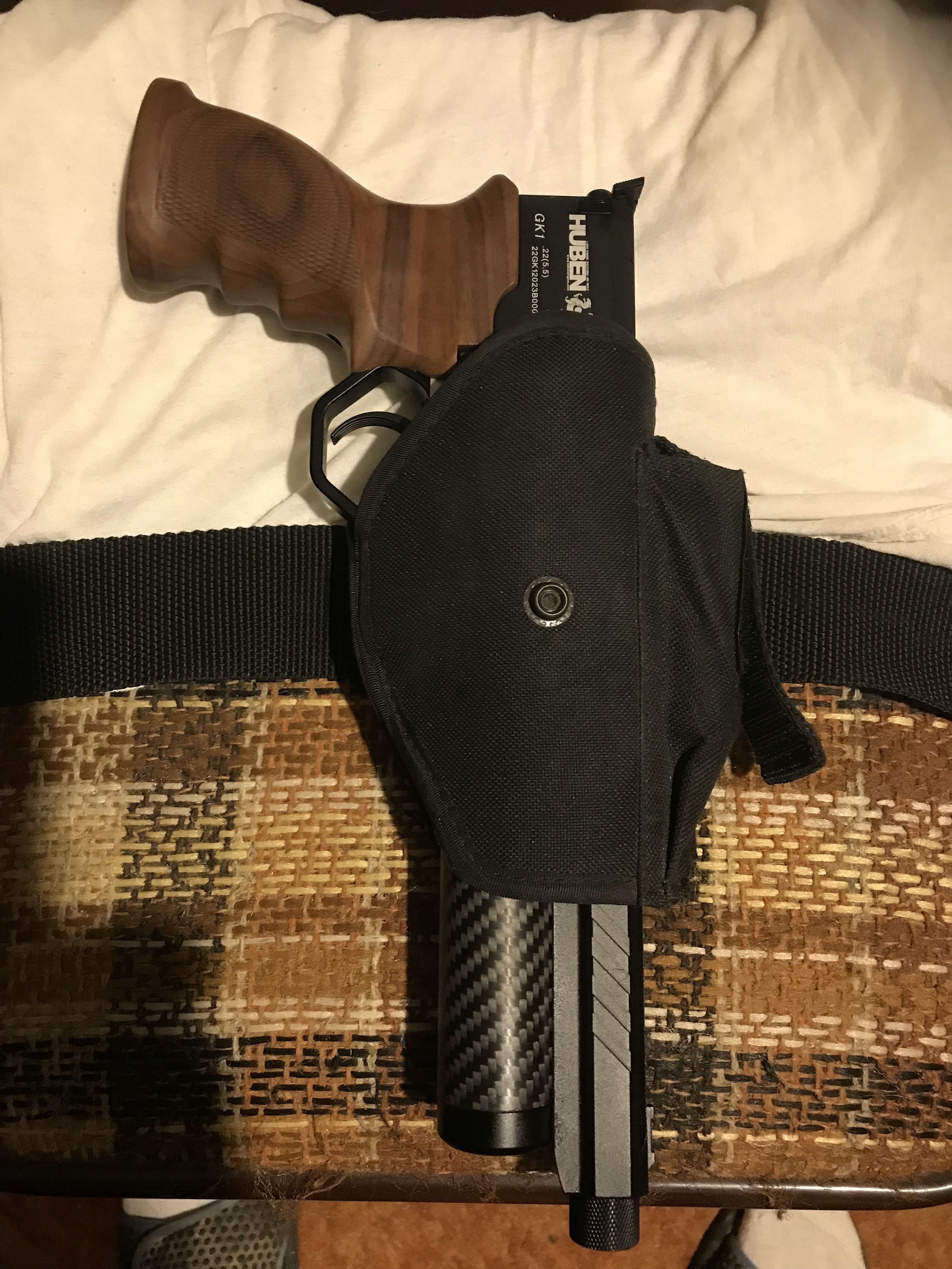

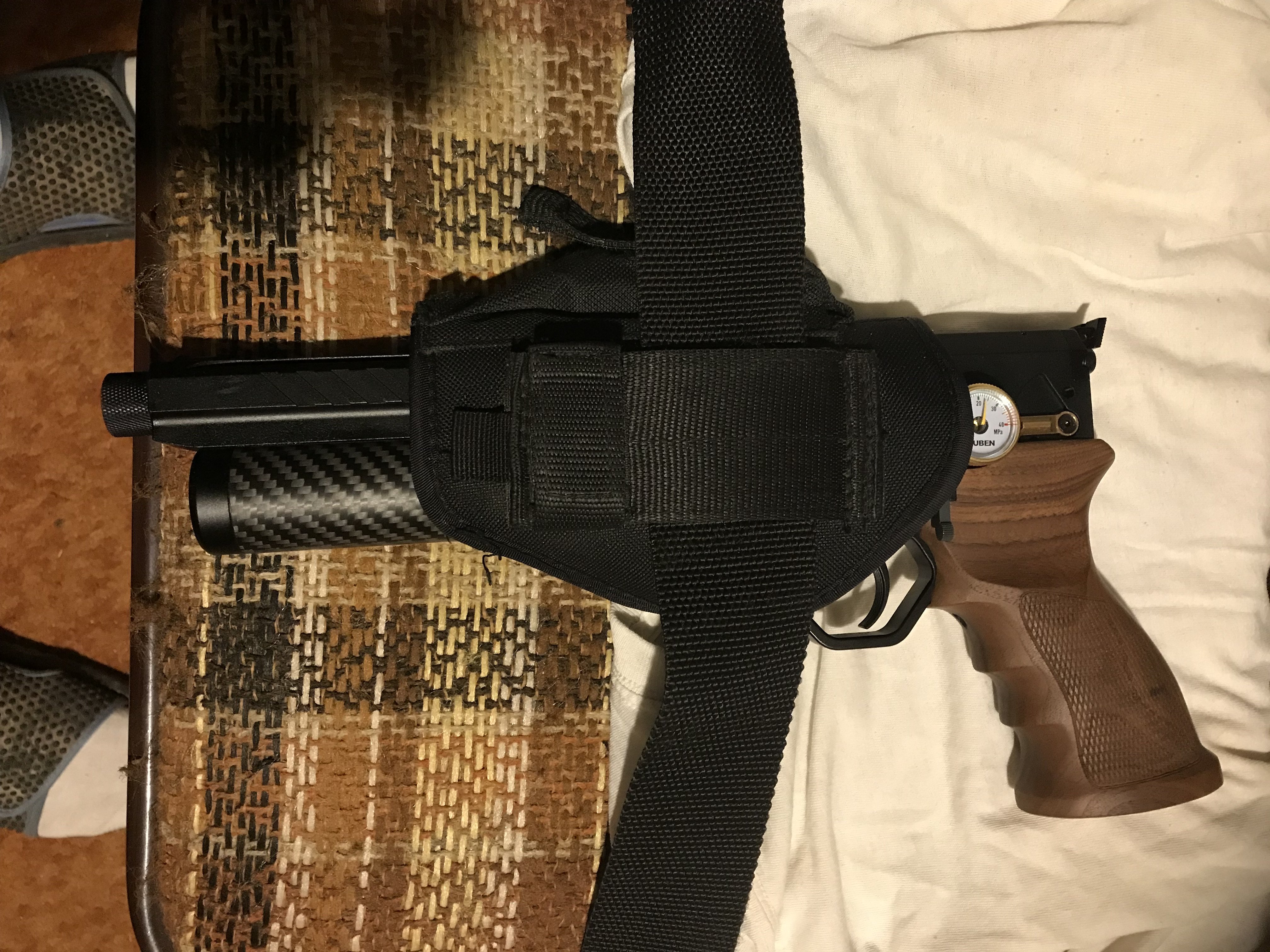

Anyone found a holster yet? And how many GK1 owners are comfortable wearing this loaded gun on your hip or across your chest? How comfortable are you with the safety?
I think a lot of folks are going to be shooting through plenty of lead with this gun.
I've looked but can't find anything I'd be comfortable with. I got a .22 cal from NE Airguns and even asked them before mine arrived and I think Joe was going to try and custom make a leather one to fit it. If he did I'd by it. To be honest I'd feel alot more comfortable and at ease with it in a holster instead of hanging off my shoulder/neck but whatever works. I know it's a little beast for a pcp pistol and would be absolutely perfect for a side carry in the woods for snakes etc...
David
Reactions: Ezana4CE
David
@psycho62 Who is Joe?

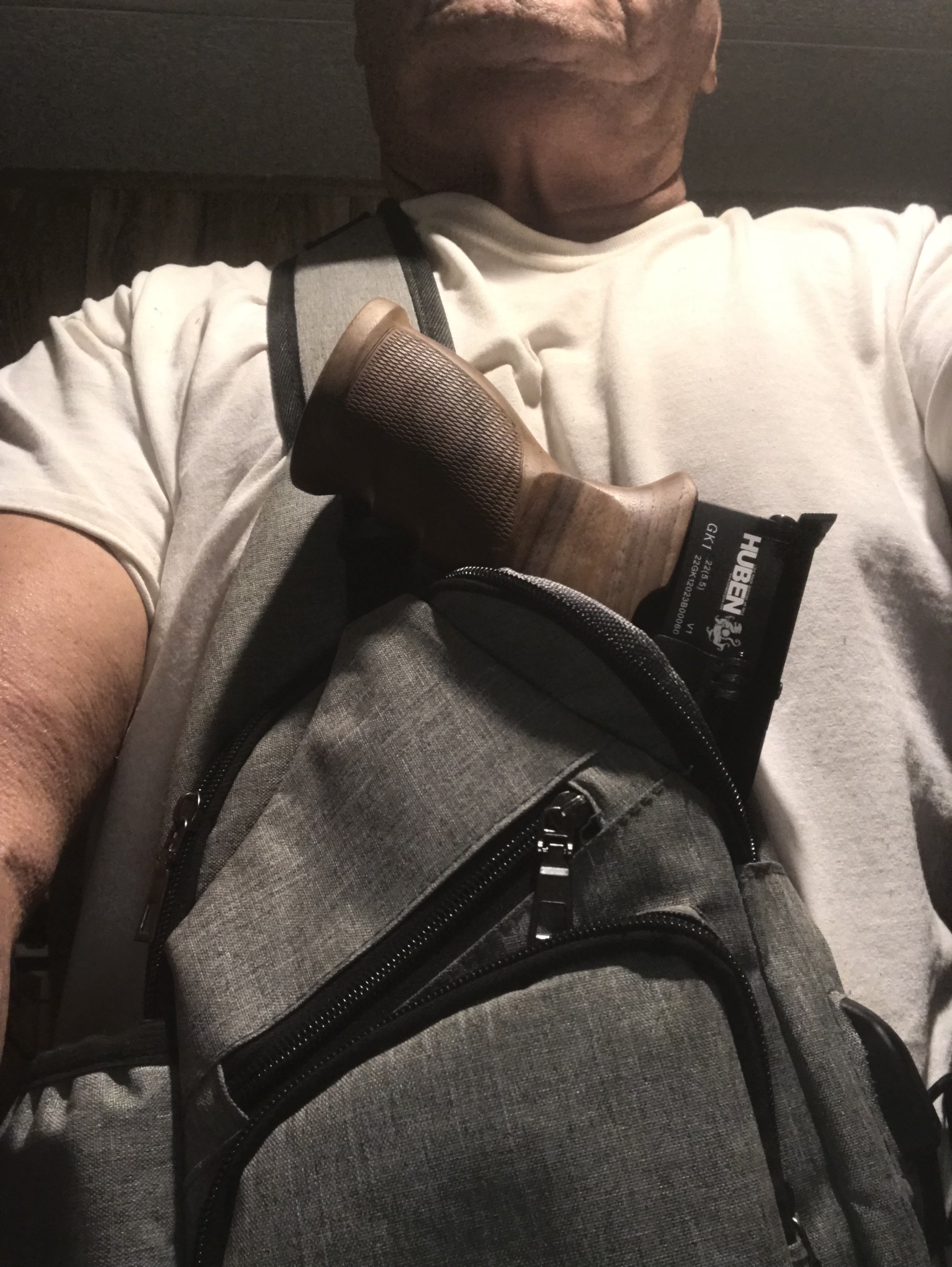

I am sure I could find the amazon link for the side holster, I do not recommend it I would not use it, It hangs on the front sight and you can not pull the gun out with one hand, Takes two hands, Its a no go,, There has to be a better side holster. The shoulder bag works pretty good and it was a cheap 10 15 dollar china bag,
