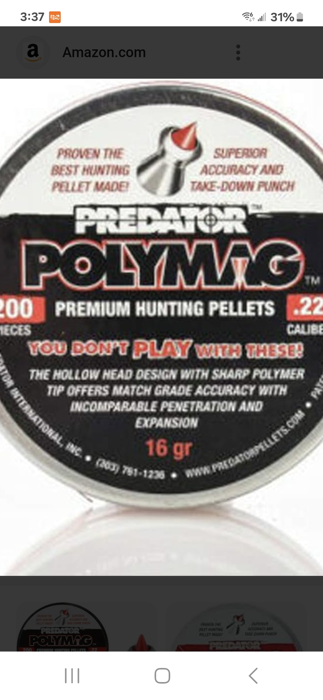

Still dump tons of energy on subject with the best of them.
Poly mags not a long distance pellet but very good out to 85 yds @ 900 fps from Alpha wolf on starlings. Loud pop and total devastating.
For a hunting pellet that is very much longer distance. I've gotten good accuracy out of them in .25 and .30 out to 80yds but never in .22, lucky you!

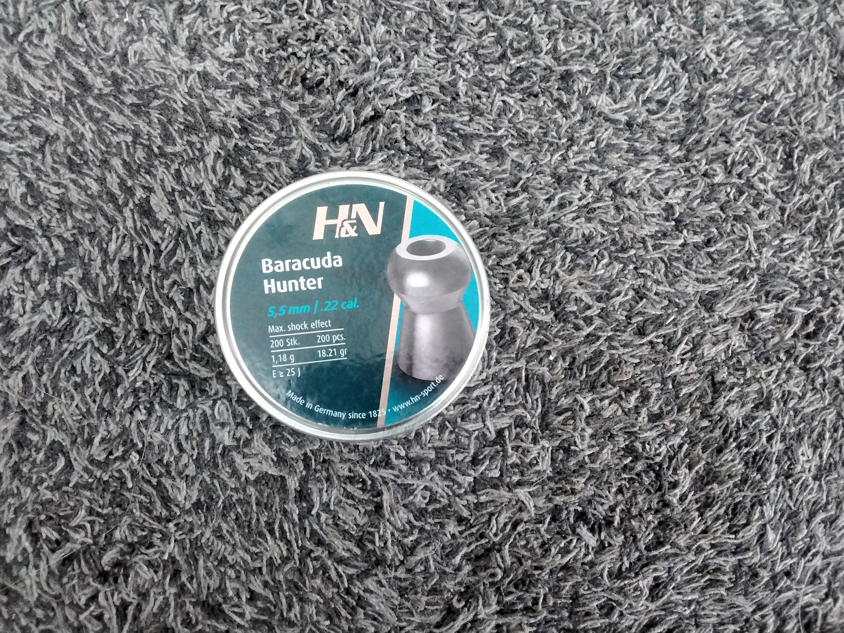

Really, try the Hades. If they work well in your gun you'll thank me. Absolutely devastating. They're THE most accurate pellet in my .25. Some guns just don't like them but if they work, THEY WORK!
EDIT: JUST realized you're shooting .22. My .22 doesn't like Hades but does like these (Barracuda Hunters). The "bucket" hollow point usually stops pass throughs. PM me if you'd like me to send you some.

I love these in .177, @Scotay42 Is shooting crow magnums out of his .22 im0act and idk how he's doing it past 50yds but they expand like he'll and don't go through most animals.
At the time I ordered 2 tins to try out the Crow Mags weren't in stock so ordered the Hunters because of similarity. Soon as the Ground Squirrels get active here we'll see. So far they've shot better than I expected on paper. MOSH (minute of squirrel head) works for me 🙂.
I've shot the crown Magnum out of my previous aea .25 varmint/standard, and they shot okayish, 1" at 40 but they cut clean holes in the iguanas! They sounded like slugs smacking bones
