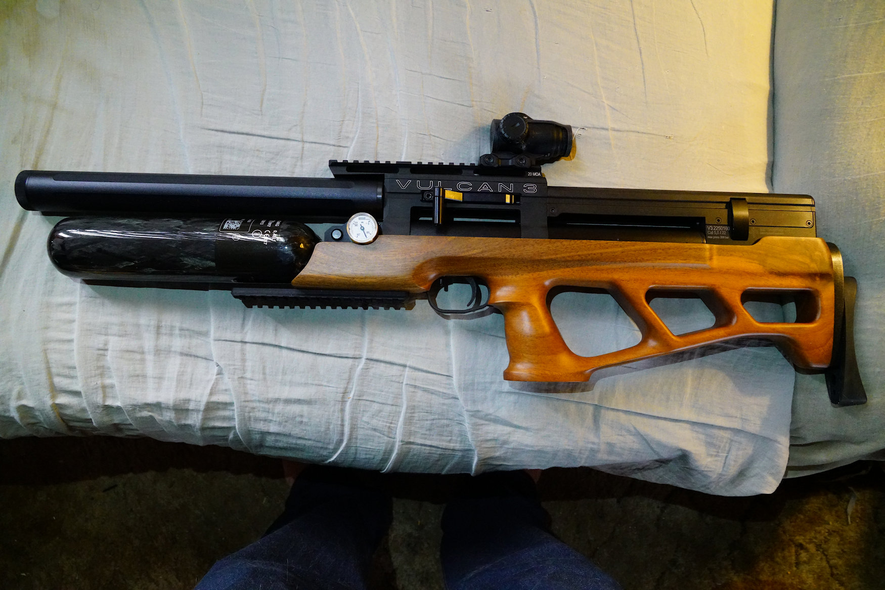

I’ve tried everything I’ve got on hand and I haven’t mover them a bit… still stuck.

I hate to say it, but it sounds like someone put some fairly (or totally) permanent gunk on the threads of the air guages. I hope I'm wrong.

A brief update! Got the damn thing off. There was definitely some thread locker / sealant on those gauges, but the front one finally came off after I deconstructed it - consisting of removing the face, peeling away the insides, and reshaping the base to fit into an old socket (one I didn’t mind losing).
Luckily there were no “bits” that fell out and everything behind the gauges appear to be in good shape. Next challenge is installation, reassembly, tuning and re-sighting!
