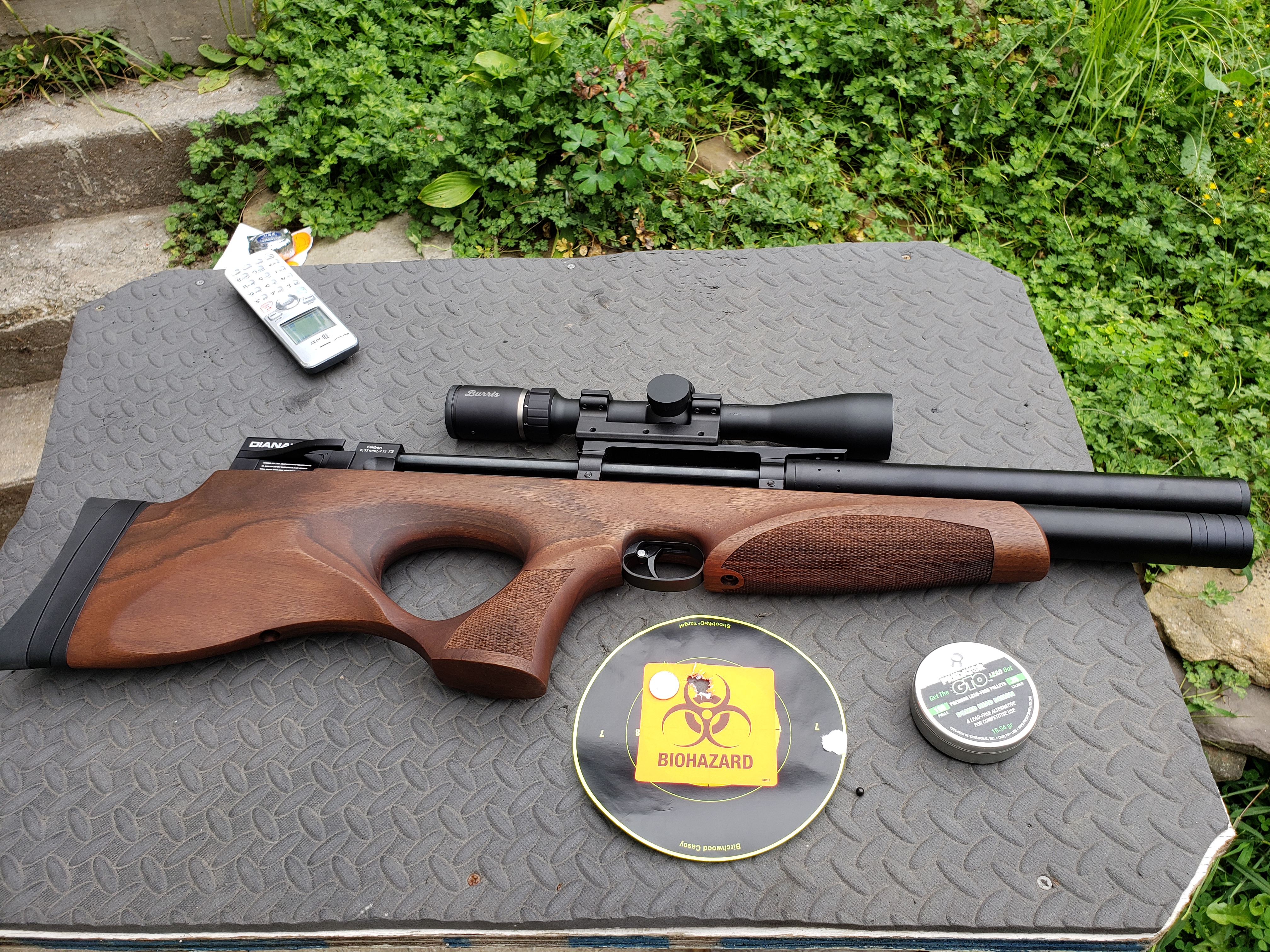

That's a lovely stock on the Diana version of the SPA P15. The rear cocking lever doesn't work for me since I shoot from the left shoulder but it is far prettier than my plastic stock rifles.

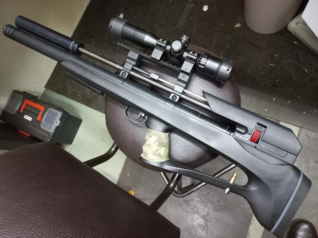

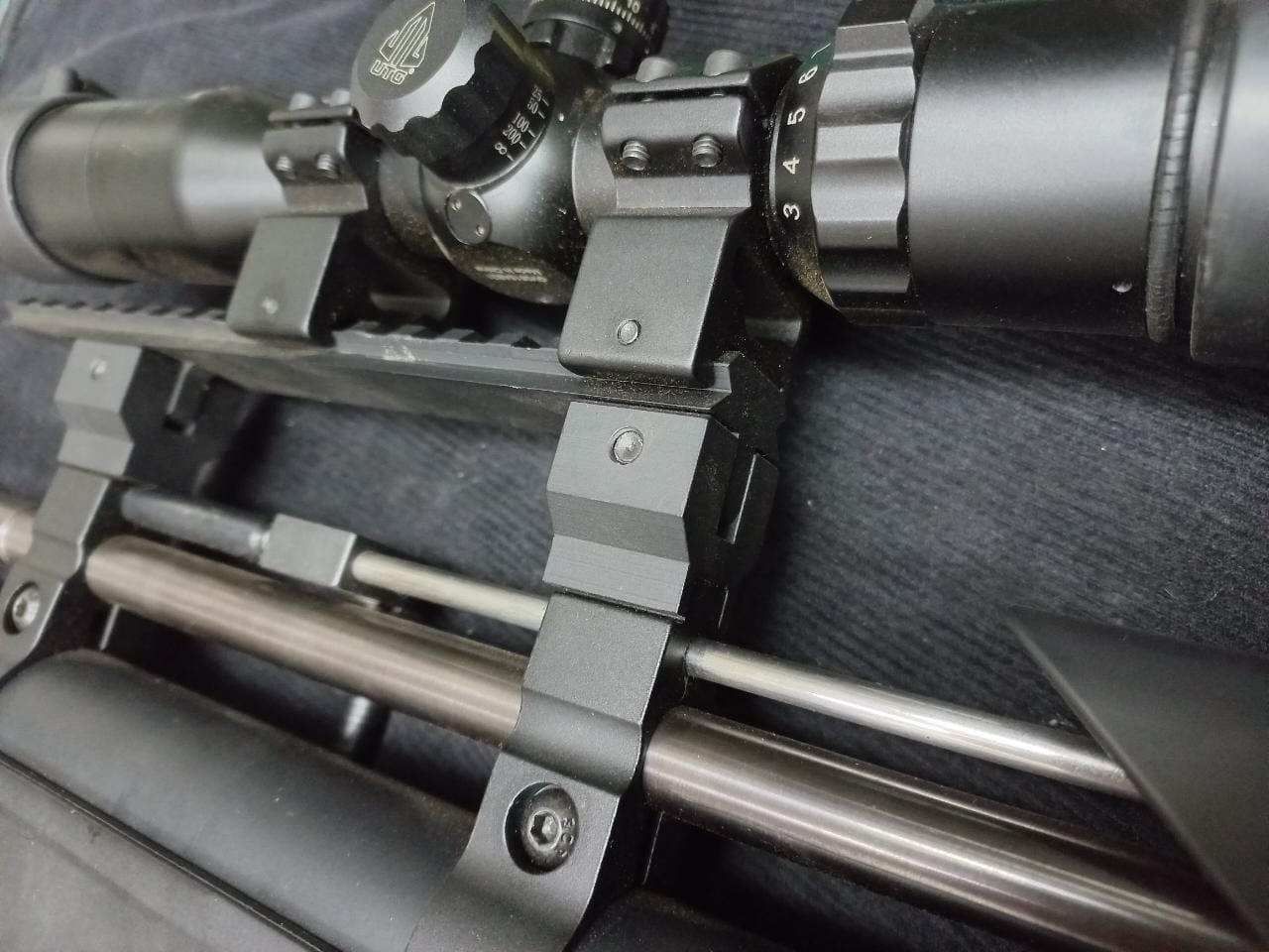

I bought a .22 P35 because that caliber was the only one available in South Africa, but I have since modded it heavily. I straight away fitted a riser rail on the top so that I could get my scope high enough, it also has height adjustment so you can shoot the scope optically centered. I have a UTG Bugbuster on there, nice small scope that suits the rifle just fine. I changed the regulator to Huma and also fitted a power plenum. Then I fitted a .177 LW barrel and threaded the end to take a moderator and discarded the shroud. With the plenum on the air tube the moderator and shroud is almost the same length. I built a reg tester and set the reg at 120 bar. I also made a fitting that fits into the hole in the stock that holds the fill probe, so it is always on the gun. I glued it in but it has a hole through so that you can still get an allen key in there to loosen the stock. Then finally some Carm magazines as the stock ones are very iffy. Now it is a very nice little rifle and quite accurate too. But as with all budget guns, I did a lot of mods to get it where I want. I still want to jack up the reg to 140 and see what it can do with 13gr Monsters.
