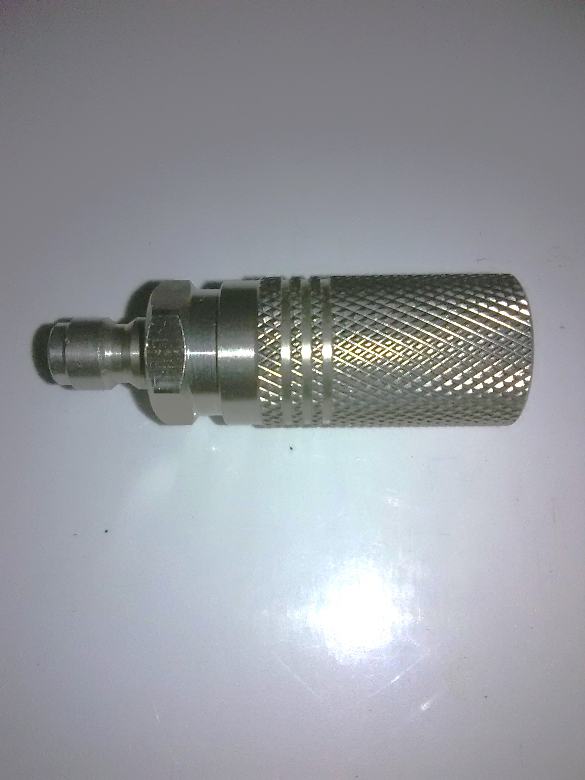

Greetings, glad you're here. Diehard Yong Heng fan myself but GX-CS compressors have many loyal supporters. Not sure of price difference but GX-CS4 adds a water cooling component which might not be needed right now, just don't want to be kicking yourself in future if acquiring a 4500psi SCBA tank. Searching "GX-CS4," in archives, upper right page corner, can help with filter choices. Not sure on M4 but many purchased this indispensable adapter for M3 due to difficult connecting with OEM adapter. Best of Luck, WM

Buy the extended Foster fitting as as advised by Worriedman. I have an Impact MK II and the fitting is indispensable.
