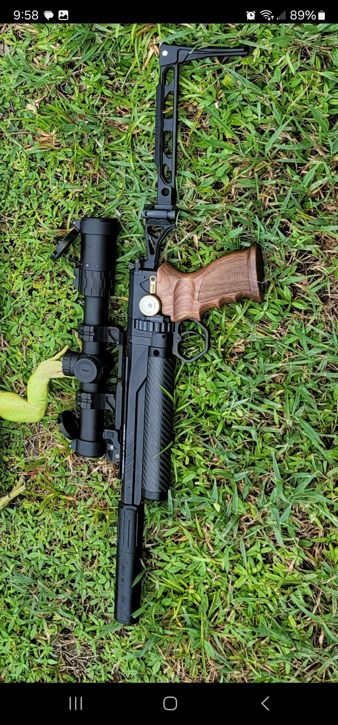

GK1 fill to 300bar and not worry, doesnt have to go to 5k. There is a sweet carbine stock for it also.

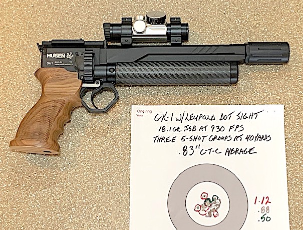

While tuning my .22 GK-1 for 3000 PSI/200 BAR fills I inadvertently turned the screw the wrong direction and saw 1200 FPS over the chronograph with 18.1 grain pellets. That's 58 foot pounds out of a small, lightweight .22 PCP pistol! 🤪😵‍💫🤯
After I got a better compressor I re-tuned my GK to return a 19 shot magazine from 310 BAR fills with 22.07 grain pellets at 880 FPS, or 18.1s at 930 FPS.
There is nothing else on Earth that compares with the Huben GK-1.

Is that a 3-D printed Moderator on the end there?
