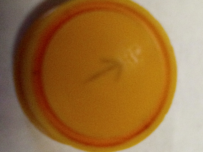

This new of the 3 arh seal with like 500 shots you can see the imprint of the transfer port in the face of the seal. Now funny the 2ed arh seal with well over a 1000 shows nothing . All using the same pellets (.177 cphp). Also i thought the fit was right and a little tight as well on it.
View attachment 303943 now the old loose as a goose and rock hard hw seal that was in it and just maybe 4 months old. It had to be banging hard to bust out the center.View attachment 303944 plus the hw spring was busted in 4 places .. pretty sad for just 4 months old and a hw/r9.. great quality, right?
