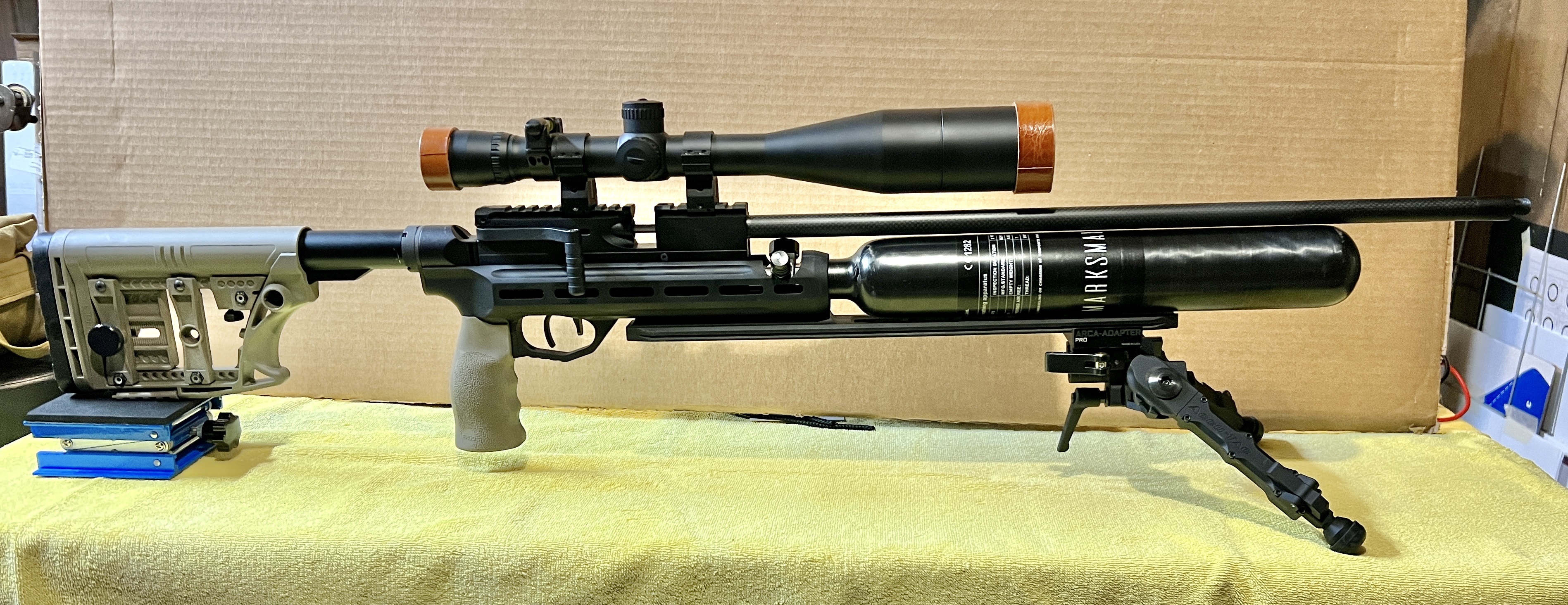

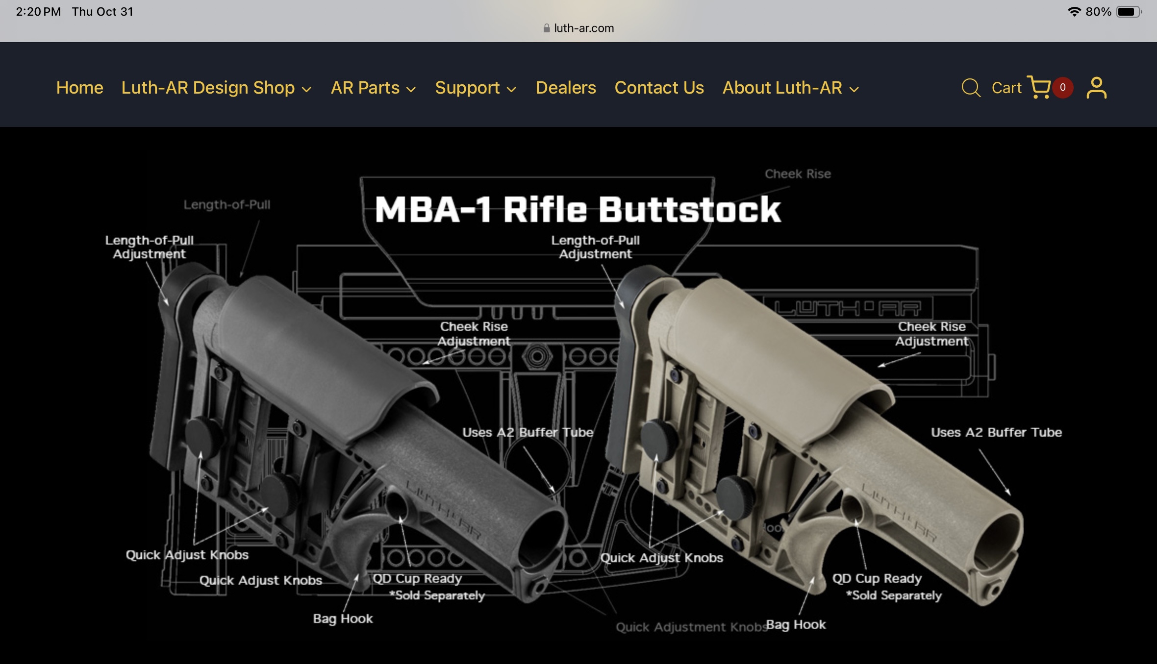

I use Luth-AR buttstock on mine. There are several models with various kinds of adjustment.View attachment 509082
They just work better from bench for me. Carrying in field might be an issue.
Thank you but I need an adjustable butt plate, not stock. For field target use. With wings. Looks like all of their wood stocks have the same butt pad on them. My usual sources dont have anything. May have to go custom again.

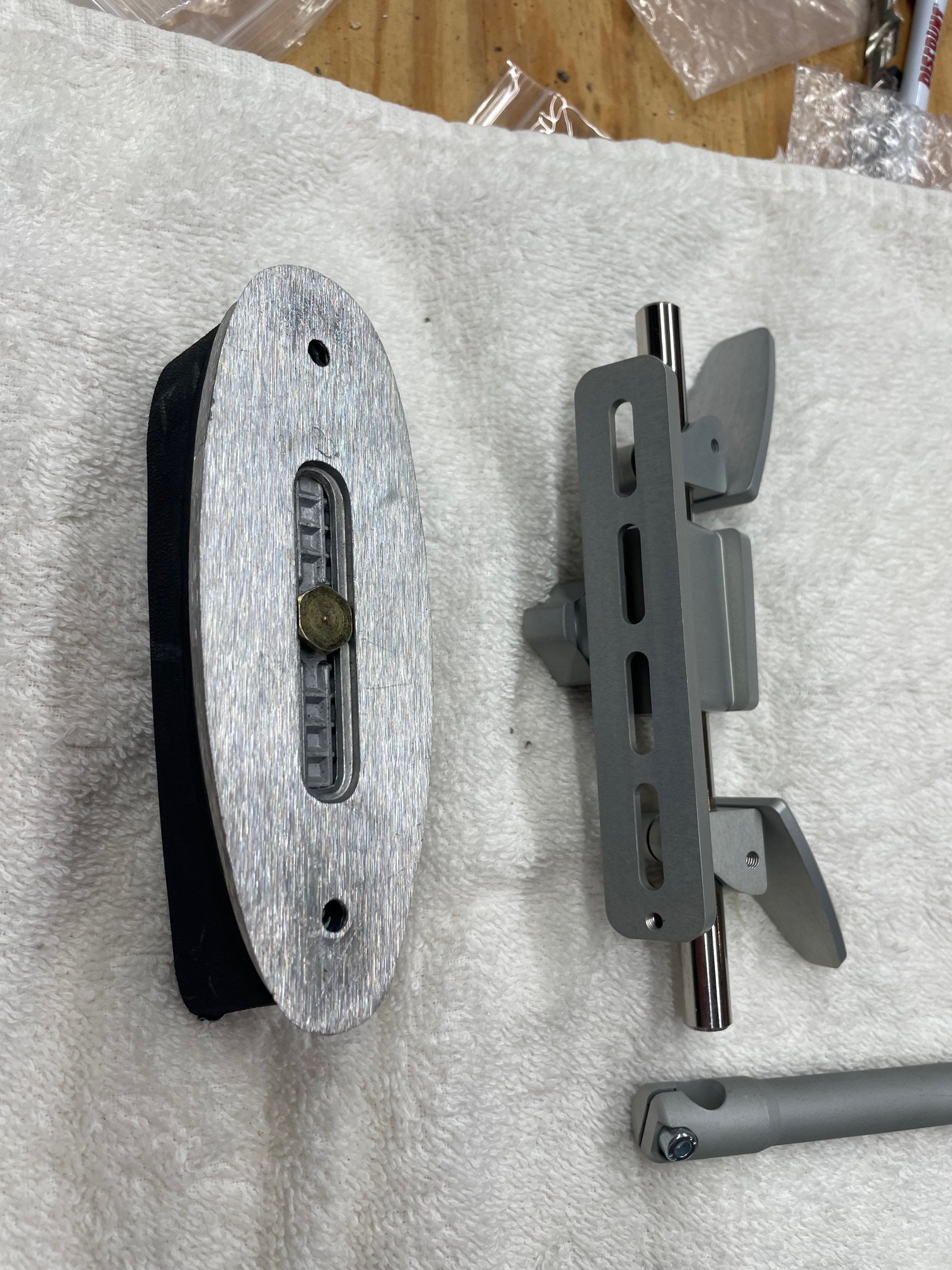

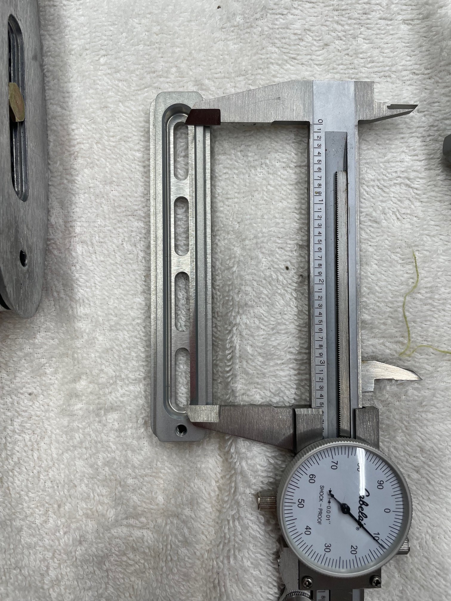

Here is a Sub MOA system mounting plate along side a Bisley adj butt plate purchased from Amazon. The Bisley is very similar to the ones that are on my RAWS only a little longer. The sumb MOA is kind of universal as you can use one of the screw holes on your butt stock and if the other one does not fit then simple drill a new hole. Other picture , calipers are the center of the screw holes on TM1000 so the Sub Moa should fit the holes on a TM1000. It doesn't come with a butt plate cover but Martins stocks are finished all the way around, or easy enough to make a cosmetic plate out of aluminum to go under the mount.
The Sub Moa systems are convertible as you can add or remove links or the hook to change the shape of the plate system. Good luck

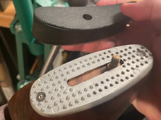

I haven't bothered to look closely at my RAWs until now but I recently fit a MEC/Gehmann Contact III to a GRS stock so I have a lot of these parts laying around.
I just took off the buttplate assembly on my RAW and it looks like it will just unscrew from the stock. Then you can screw the adjustable butt into the wood wherever it makes sense to you. The MEC adjustable is rectangular with rounded ends and the RAW stock is sort of elliptical so obviously there will be mismatch and exposed unfinished wood.
The bump and pocket adjustment surface on the RAW looks like it could be put together with cant but then the bumps will not lock into the pockets. For full strength it is vertical adjustment only.
