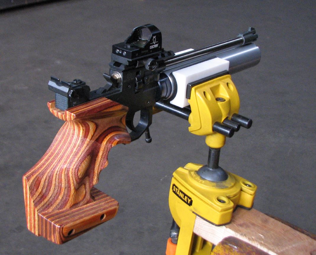

Had too much fun plinking, never took the time to do a proper accuracy test, so here goes
My setup, doctor red point only used to get first shot on target

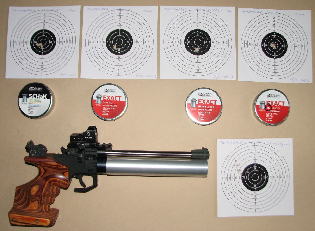

4 different JSB from 10 meters all shot from same setup and point of aim, the drop between the 4 pellet types is comparable
Just for fun, added a target shot from 32meter/29 yards with JSB RS and a bit of holdover
I did not expect such accuracy, one mag 8 shot each target, happy days!

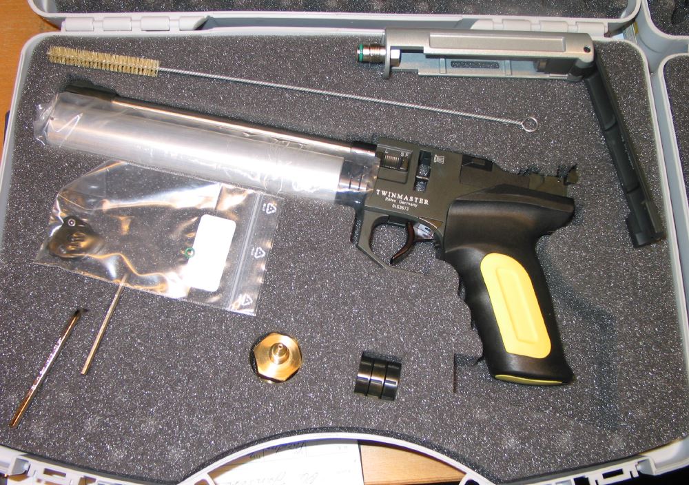

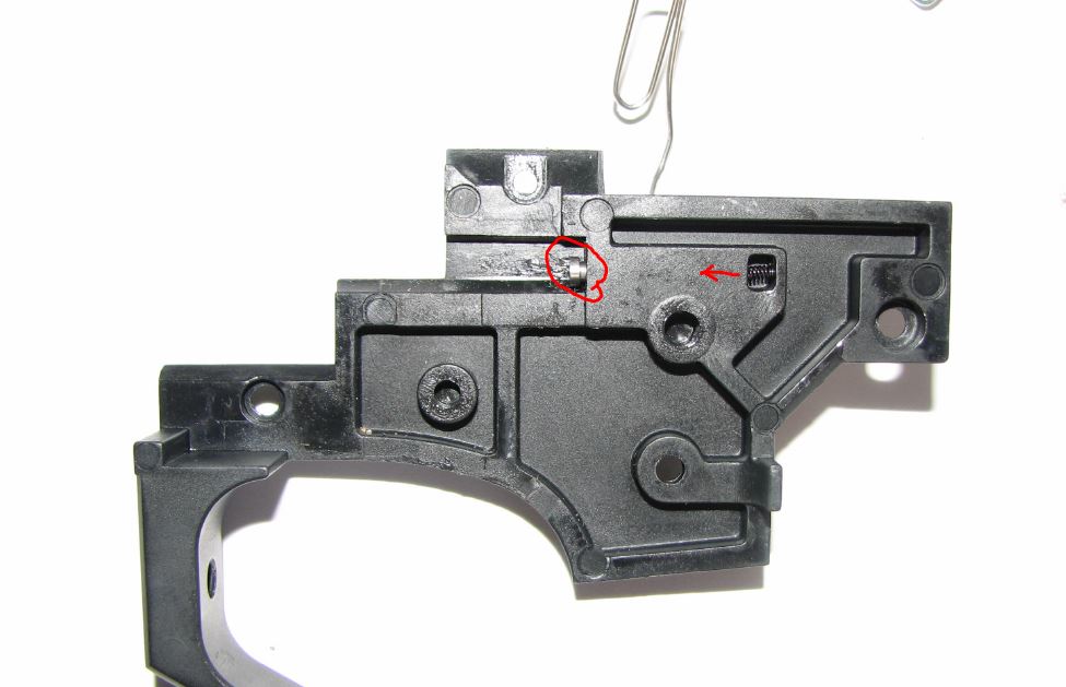

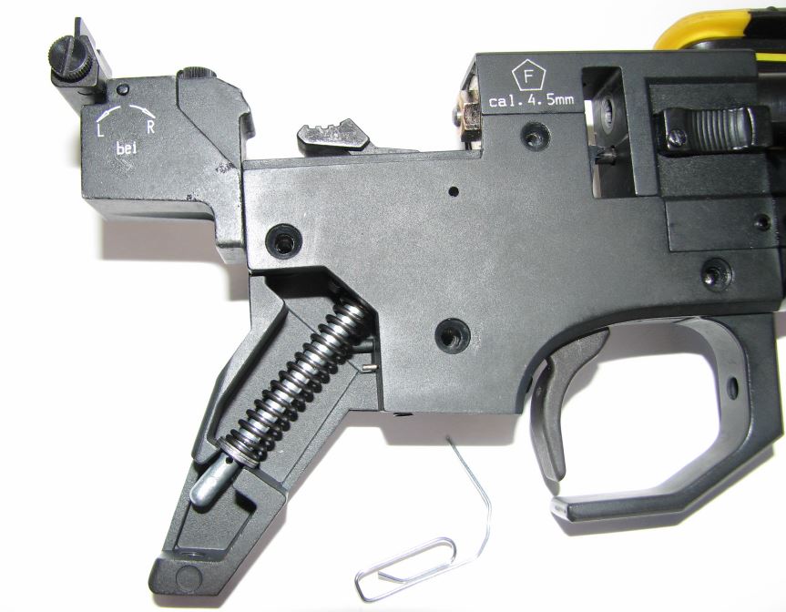

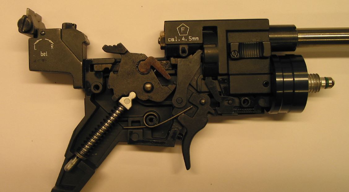

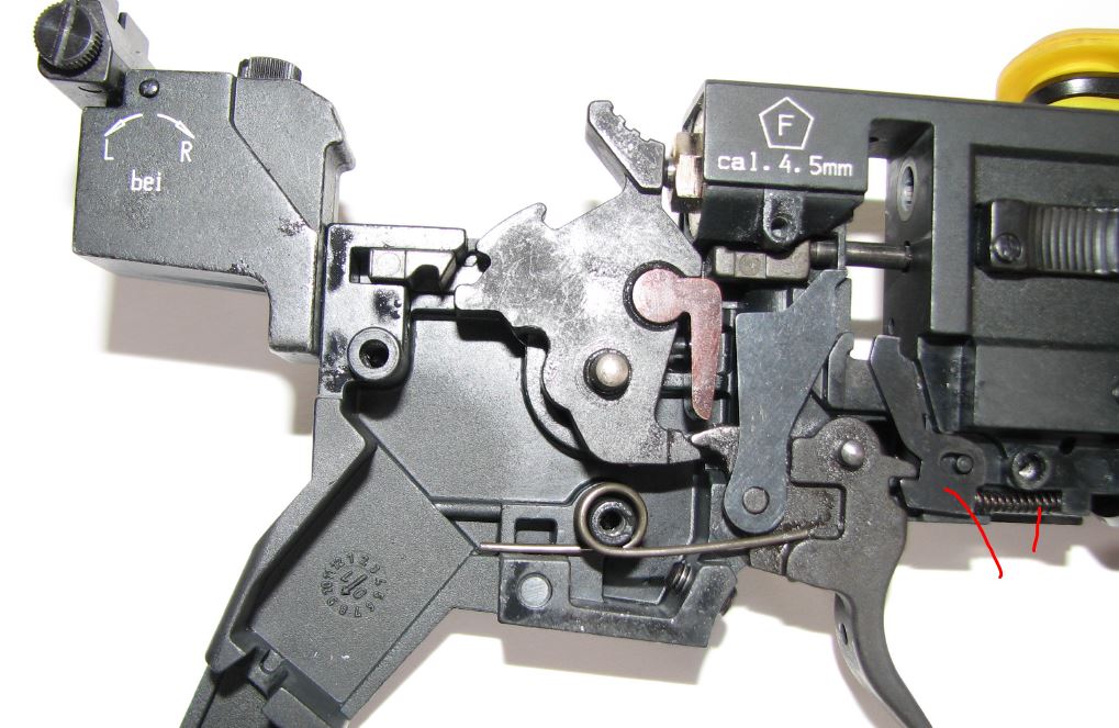

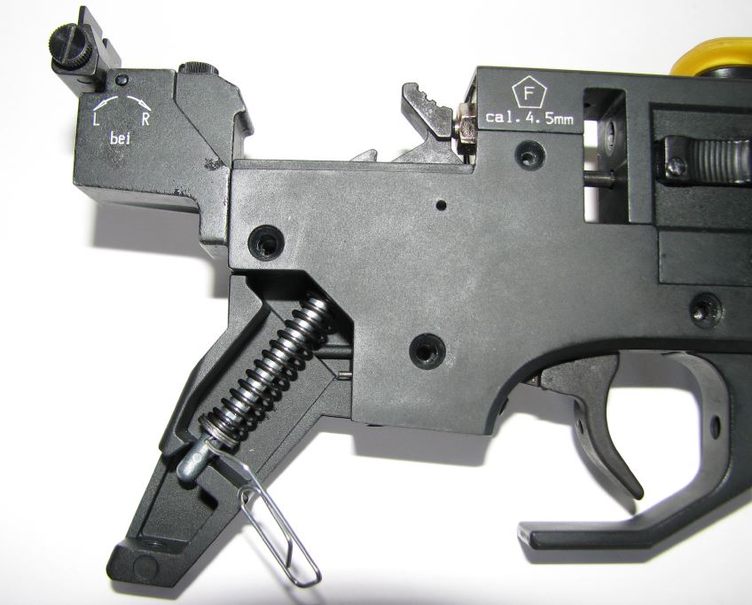

Pictures from takedown, a paper clip is your friend
View attachment 308647View attachment 308648View attachment 308649View attachment 308650View attachment 308651View attachment 308652View attachment 308653View attachment 308654

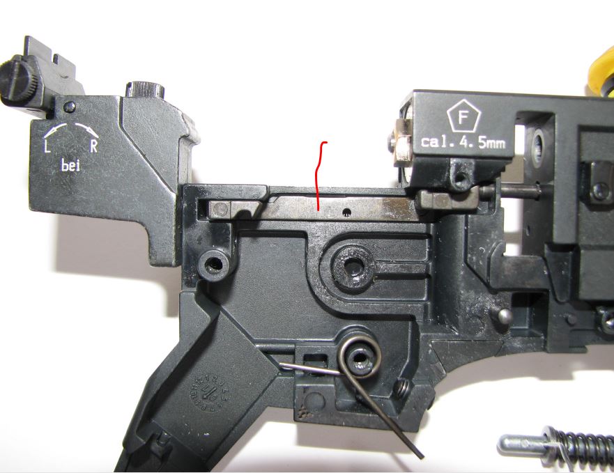

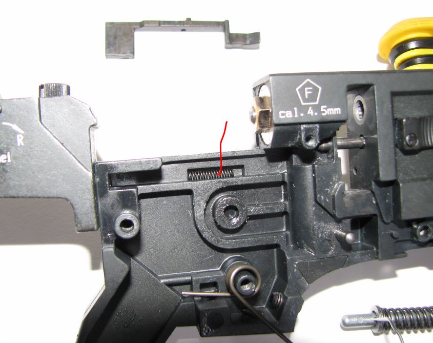

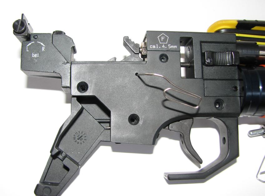

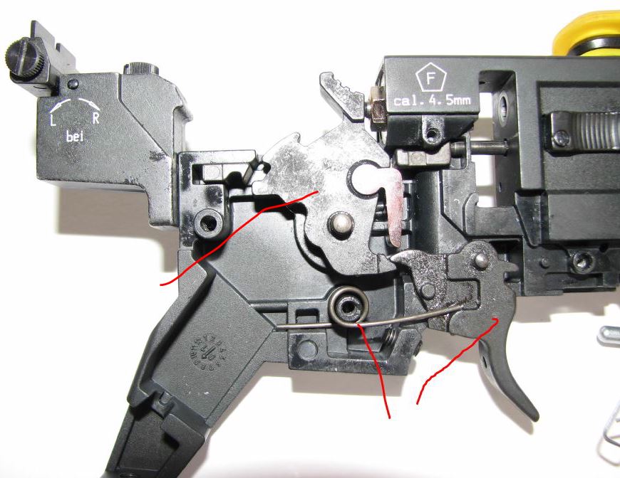

The action in single action
View attachment 308655View attachment 308656

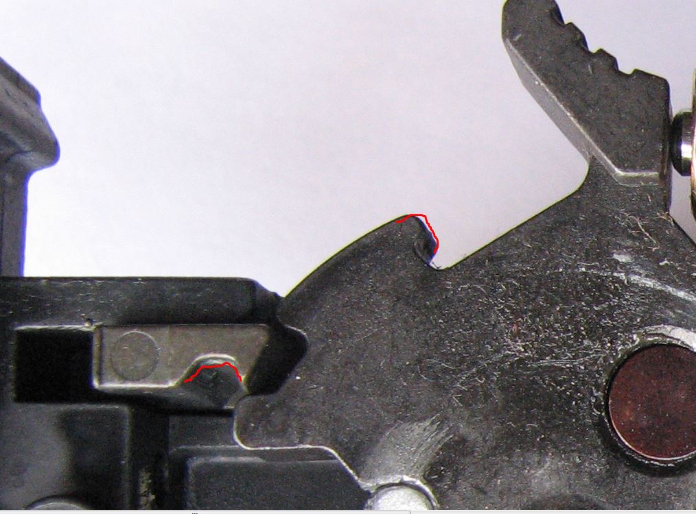

Dry fire notch

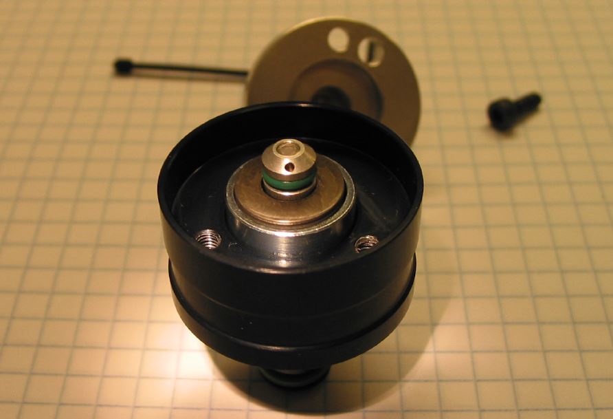

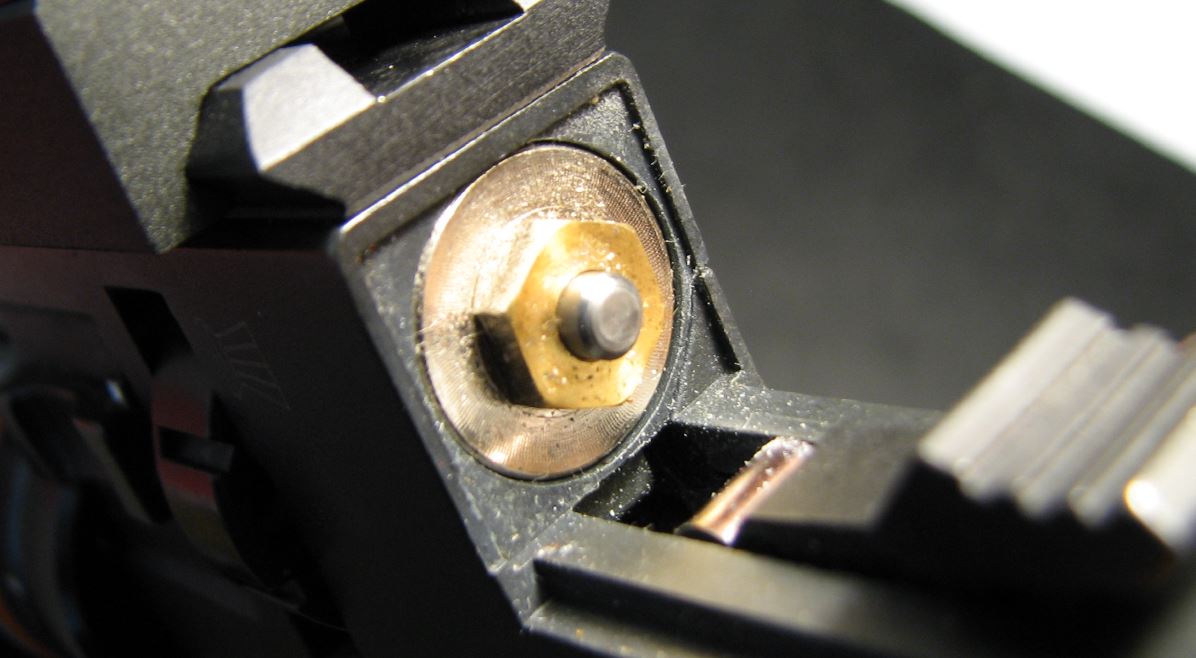

Regulator
View attachment 308659View attachment 308660
My notes

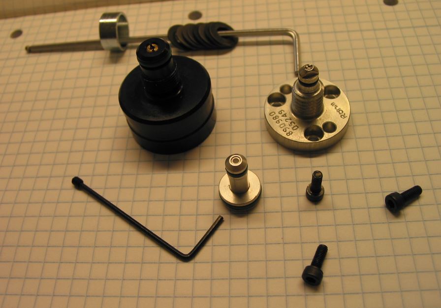

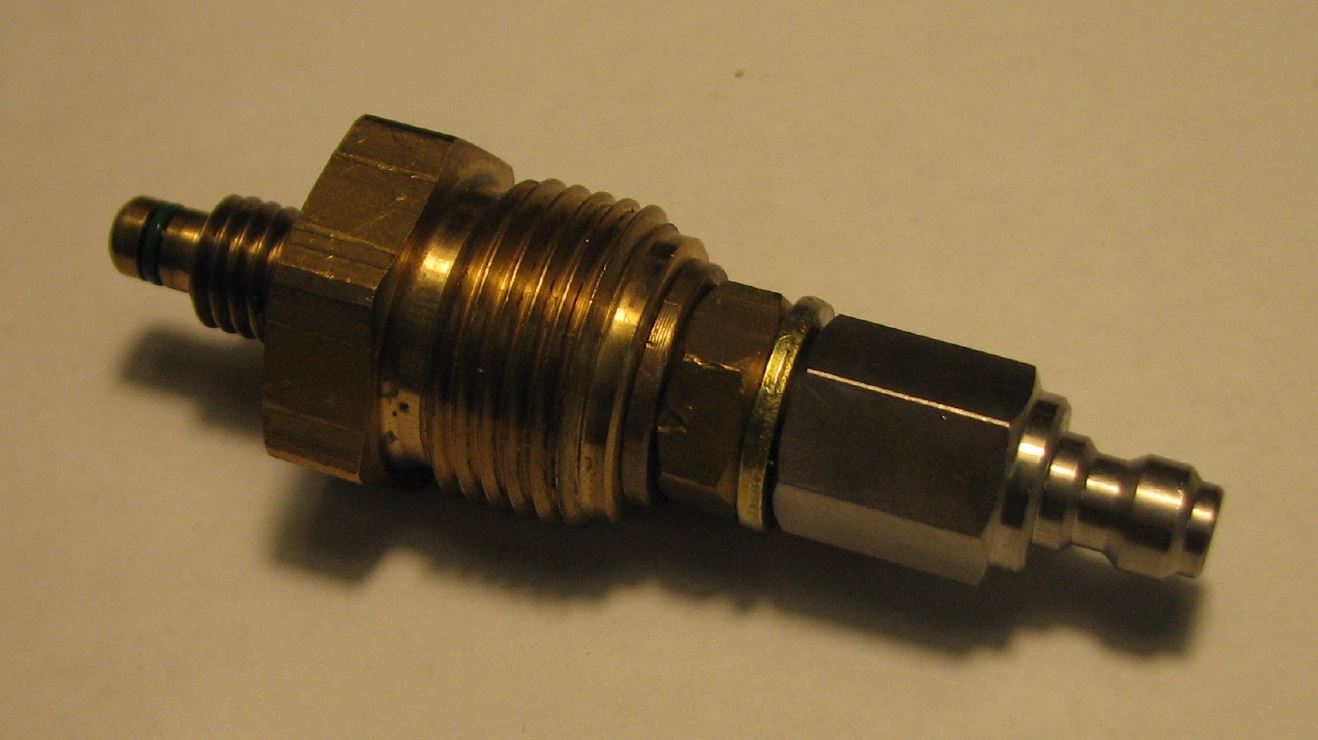

Fill probes
Original fill probe modified for foster coupling

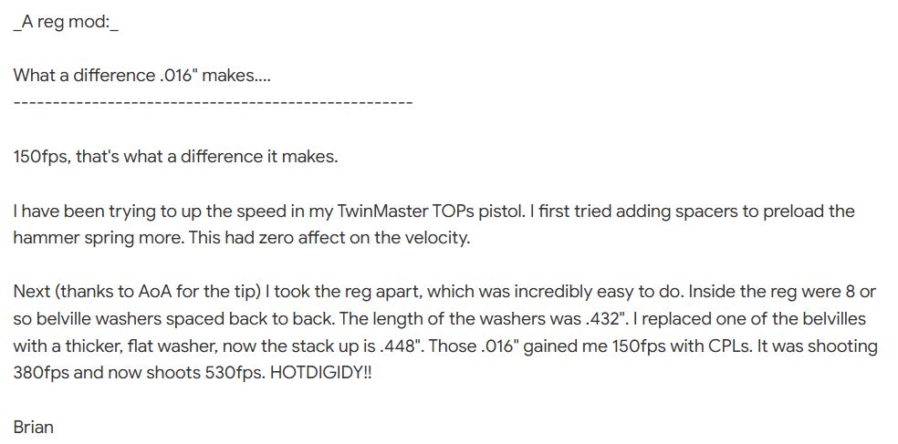

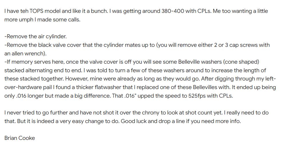

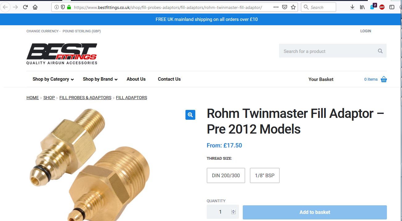

Screenshot of mods I picked up from another site
My memory was wrong, did not flip one of the belleville washers but replaced one with a thicker one, also removed a small amount of material from the valve housing face, this allows the valve stem to go deeper for added air flow

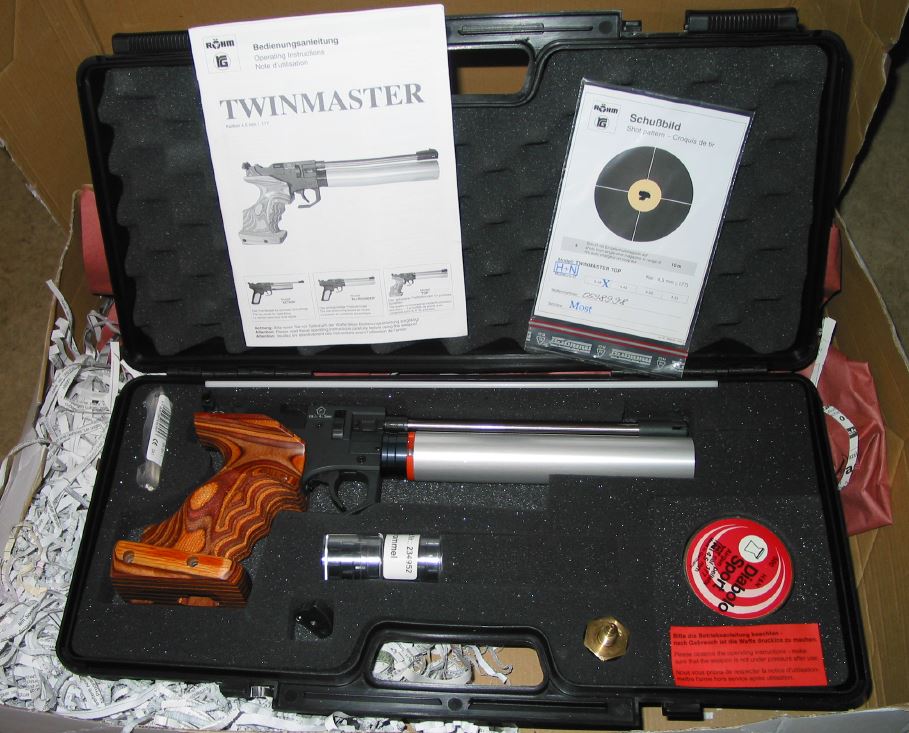

I recently purchased a used base "Action" CO2 Twinmaster. Just got to trying it out last night and I have to say it's one of the best semi-auto CO2 pistols I've shot. It's shooting JSB 7.87gr pellets at an average of 420-425 fps and very accurate.
The semi has a bit of a long pull on the trigger, but in single-action mode the trigger is really nice and very light.

Congrats! - its a great shooter and very very accurate with the right ammo
Your model "Action" is the CO2 version - my "All-rounder" is the PCP version, besides that they are exactly the same
The one I shot the 5 targets with is called "Twinmaster Top", same as the "All-rounder" but with target grip
Yes the trigger is nice, can be made even lighter with another spring but made too light it will loose the reset and by that the double action option, I would guess that is the reason they made the "Twinmaster Match" in single action only

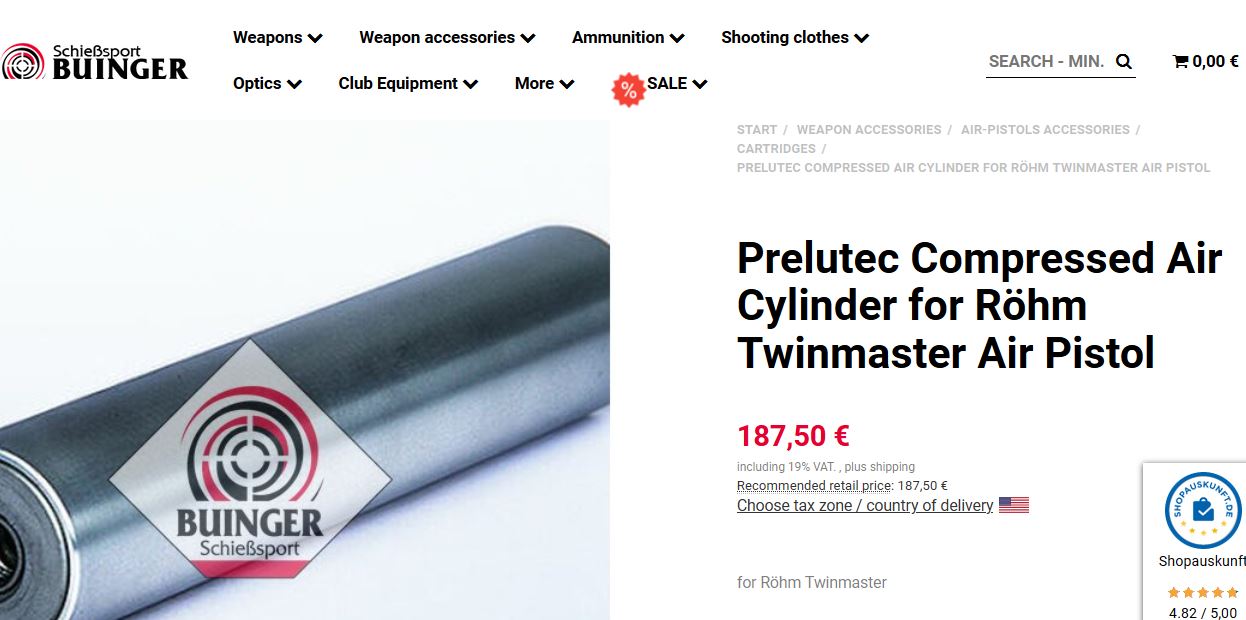

Excellent Towle! I sent them a request. My TM is a 2001 model, and I want to make 100% sure it fits before I order one.

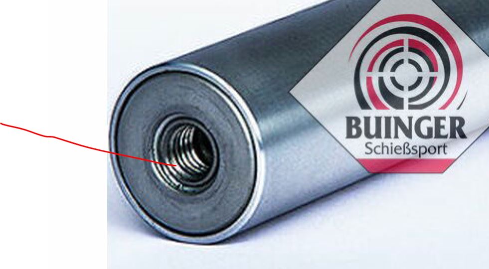

All mine is also from 2001 - looks to me they made the treads with a Helicoil insert, if so, more wear resistant than the original aluminum
BTW, any machinist should be able to make a new cylinder or use an existing cylinder and reuse the original back part, so there is always that
