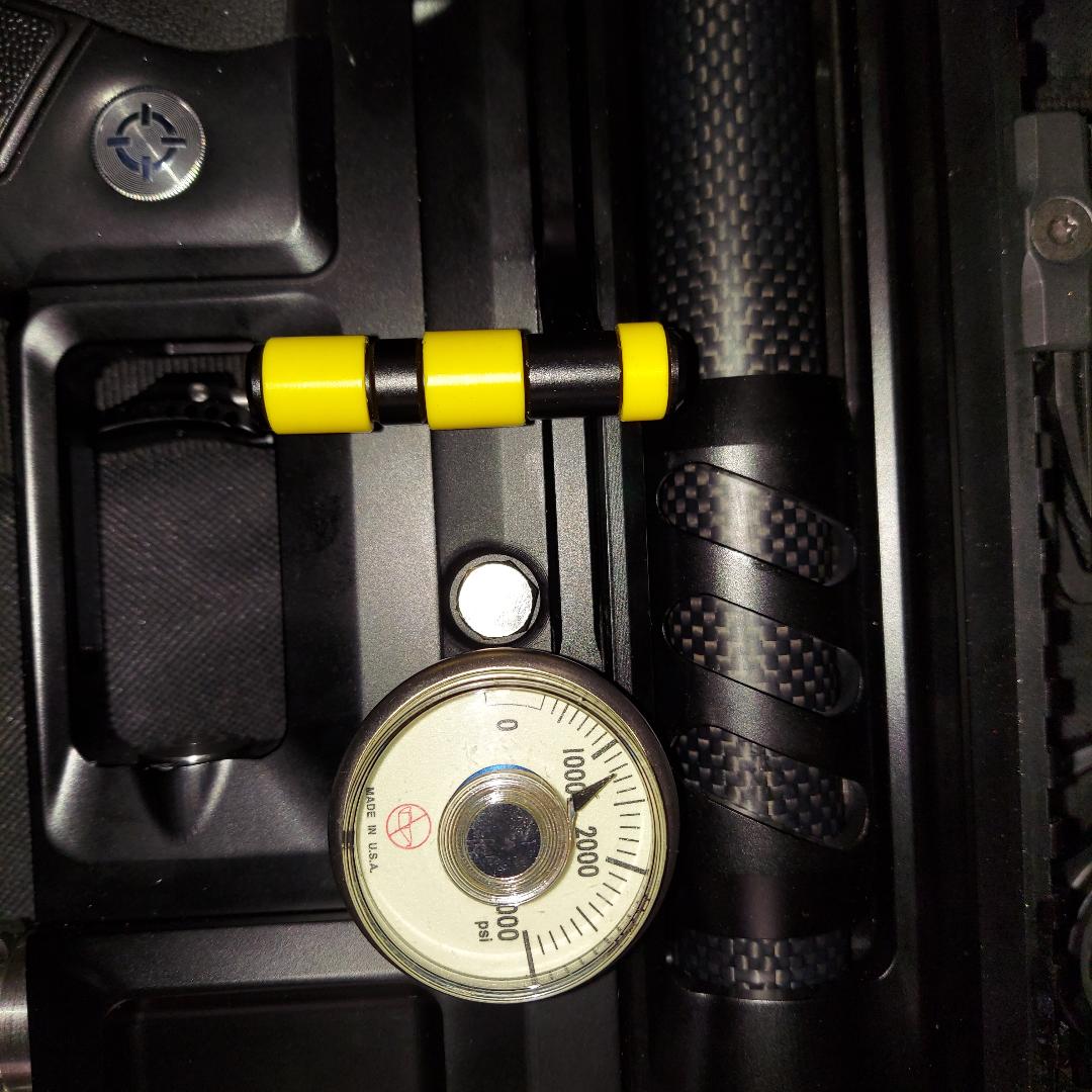

Bit of FUN today ... no shooting just tinkering around.
Guns too loud !! ... Cure, make some insert-able baffle / spacer assemblies removing that weird tube set up. It fits back together & one would never know .. and it is QUIETER !!
Made some delrin sleeves that get split with a razor blade & snapped onto cocking handle. They roll under your fingers and feel excellent when speed cocking. ( After & Before pictures )
Fit in 2 thin .003" shims on both sides of trigger pivot post to eliminate the side/side wiggle present.
